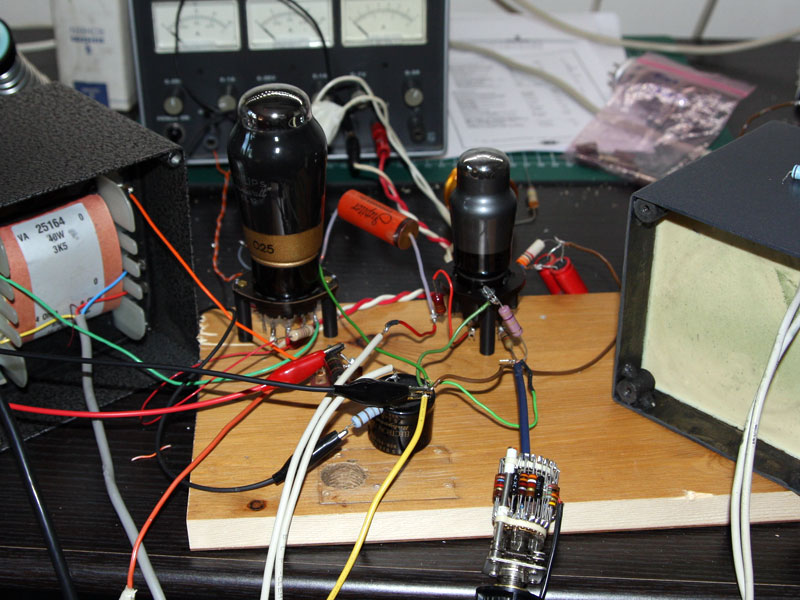

I found some pics Disco sent me in 2009 about supplying some SE tube amp. EL12 driven by EL8, both in triode. He said it worked alright.
He had made the first double BJT Vref back then, more troublesome, plus own etched boards and had IRFP9240 for CCS. I think your board takes TO-247 CCS too.
Maybe yours worth a shot since its low consumption, you never know. Hey, you got boards, easy work. If it blows a couple of cheap leds and a semi, you could say you at least tried. :cool:
