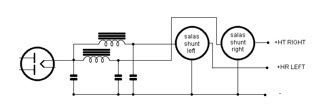

Simplistic mosFET HV Shunt Regs
Twice better a dual mono for sound image

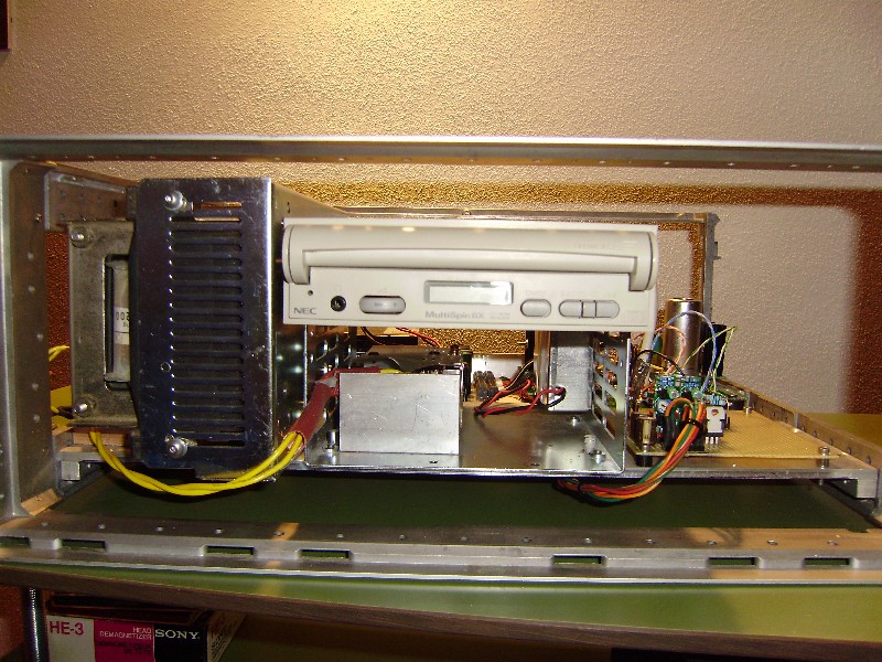

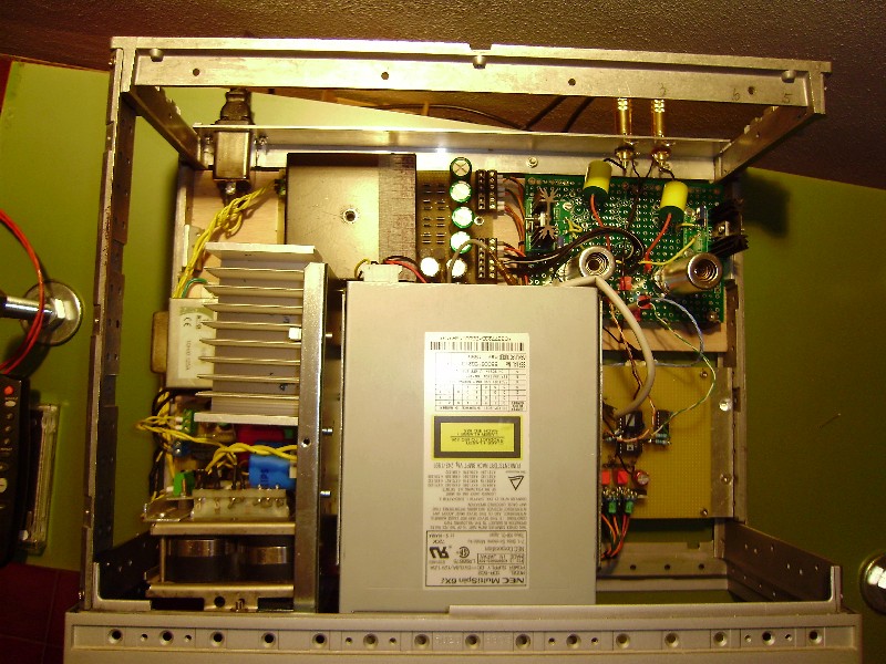

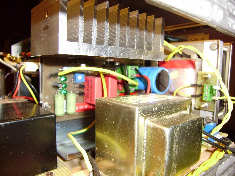

Hello Salas,
I've done my first HV regulator and now is on my new cdp.
A lot of work but now I'm very happy.
In the future I need only to upgrade some parts like caps, i/v resistors.
The noise level is really low with my 95db speakers.
I've attacched some pictures.
Now I'm testing a new one becouse I'd like to make your 12B4 preamp.

Before I used a tubereg with ECL86, It was more noisy.
Now I've made some more modifications like cascode CCS and led on the catode of the 6C45.
On the reg that don't work I'm using a KSP94 that is the same of MSPA94,
in the first one (low voltage )I've used MPSA92.
Ciao
Guglielmo

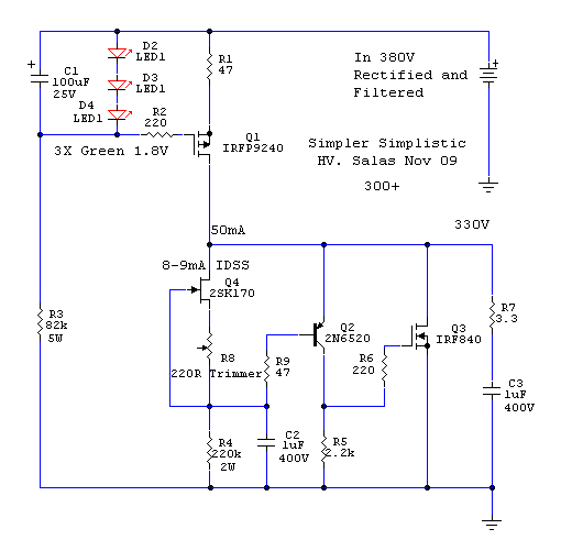

So it will be easy to check the 300+ reg in Simpler Simplistic style? Like this one? Instead of troubleshooting while still on bench.
It looks like working great in the simulator, although all the builds are under 300V up to now. Use your driver BJT where I had another in the sim library. If it still does not make it, I would try a 150V Zener across the PMOS, and 30VZ across the JFET.

Hello Salas,
I'm starting to test the new circuit, post 891, but the Css works but shunt is like open circuit, no regulation.
My 2sk170 is 8mA.
Trimming R8 from max to 0 I've no voltage variation on R4 that have about the same voltage of the output, or 0,5v less (I've not made a specific measure) may be the voltage drop on Q2.
Tomorro I'll check all the connections another time but it works in a strange way.
What do you think about.
Which psu regulation do you use in your 12b4 preamp?

Hi guglielmope .
why work strange?
You can measure voltage at the location is not?
I have not tried to run on 350v input voltage. with 320v and out put 260v, 100mA total, My pre use 80mA, I have tried a lot and it is stable, sound is good!
I runt it many times on day, 12h, and more, Now I still run good,
You try to replace trimmer 220R by trimmer 1k ???.

First time for that one with the jfet for over 300V out, so we will have to debug it. Lets see, what do you mean by open circuit? What voltage at the output? Vin-Vbe=Vout you mean? Check connections, but also see if the 2sk170 is alive too. If dead, put a new one, but clamp it with a 30V zener. Also is the trimmer OK, and is the value as recommended? Be sure it resides between source and 220k and not between gate and 220k. The 12B4 got a resistor load again to drop gain, because the amp got less feedback mod and the gain was too much so its under 300V too.
