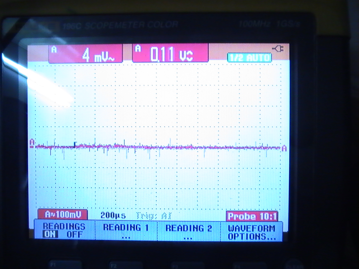

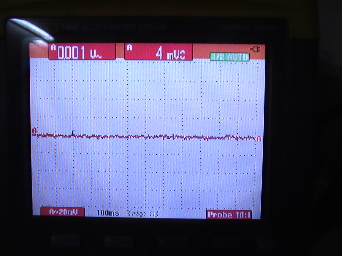

You said in the start, hiss & hum. Where is it on the scope picture? It was in your preamp? Did you solve your problems, sounds clear now? Which one you like most for sound? Jfet simpler simplistic or 2xBC560 regular simplistic?

What do you think I measure??
Is that 1mV noise for the simpler simplistic on the picture? If yes, its good for any tube circuit. Boards you make anyway, no one can stop you. Just don't make commercial. Make for friends and members of your forums there and our forum here. Me I will not coordinate any PCB efforts. Its you and the people, you do what you like.
