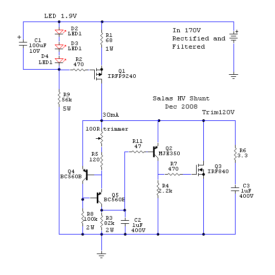

No, 100mA is roof if with depletion 10M45S hypothesis. This circuit we talk, goes as you know, by changing R1.
R1=20R, R2 & R6=470R looks good for that current you want. Why just don't modify one you already have, and start at lower safer current to see if the simpler Vref works OK first?

I don't know, told him. He wants to jump the gun.😀 We can clamp across with a 40V zener if it poofs.

Hum is irrelevant to the reg. Its GND or Hum field. Do you run heaters heavy AC to heater regs lines on same board? Why 100R R6? Don't make board before you check new JFET one point to point OK? Its not tested yet.

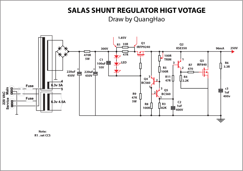

Ok! i make 2 board I try do it for this cricuit, Do you see in My draw cricuit!
I see wrong R6. And don't run heavy heater currents and cables near the shunt boards or combining on them. Use individual heater reg boards away.

Now you edited R6 3R3 OK. Your old layout is OK if it works, only make simpler the voltage reference area, for the new with jfet to test. Less components! And any heater circuit on different boards. That is all.
I use 3 mA and 120 V
Can i use your scematic ? or need change value component.

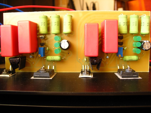

Until now here are my impressions.
This regulator beats any other regulator i have tried, tube, mosfet series, of course including brute force power supplies by quite a big margin. Inrcredible life like presentation, accurate imaging and impressive attack and dynamic appearence of instruments. And all this with just 20V Vin-Vout. The transformer i use cannot handle the current drawn by the shunts. The only drawback is that when i power the regulators i get Vout = Vin and after a couple of minutes it starts dropping voltage. I'm not sure how normal is this and how good it is for the tubes. I hope until the end of the week to have a couple of higher voltage transformers to implement dual mono. I will come back then.

Happy for your subjective results. Do you turn on your pre first, are the heaters well warm and you turn on the reg after?
