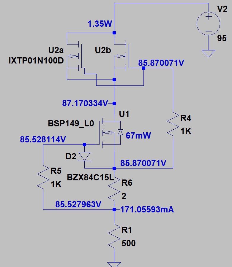

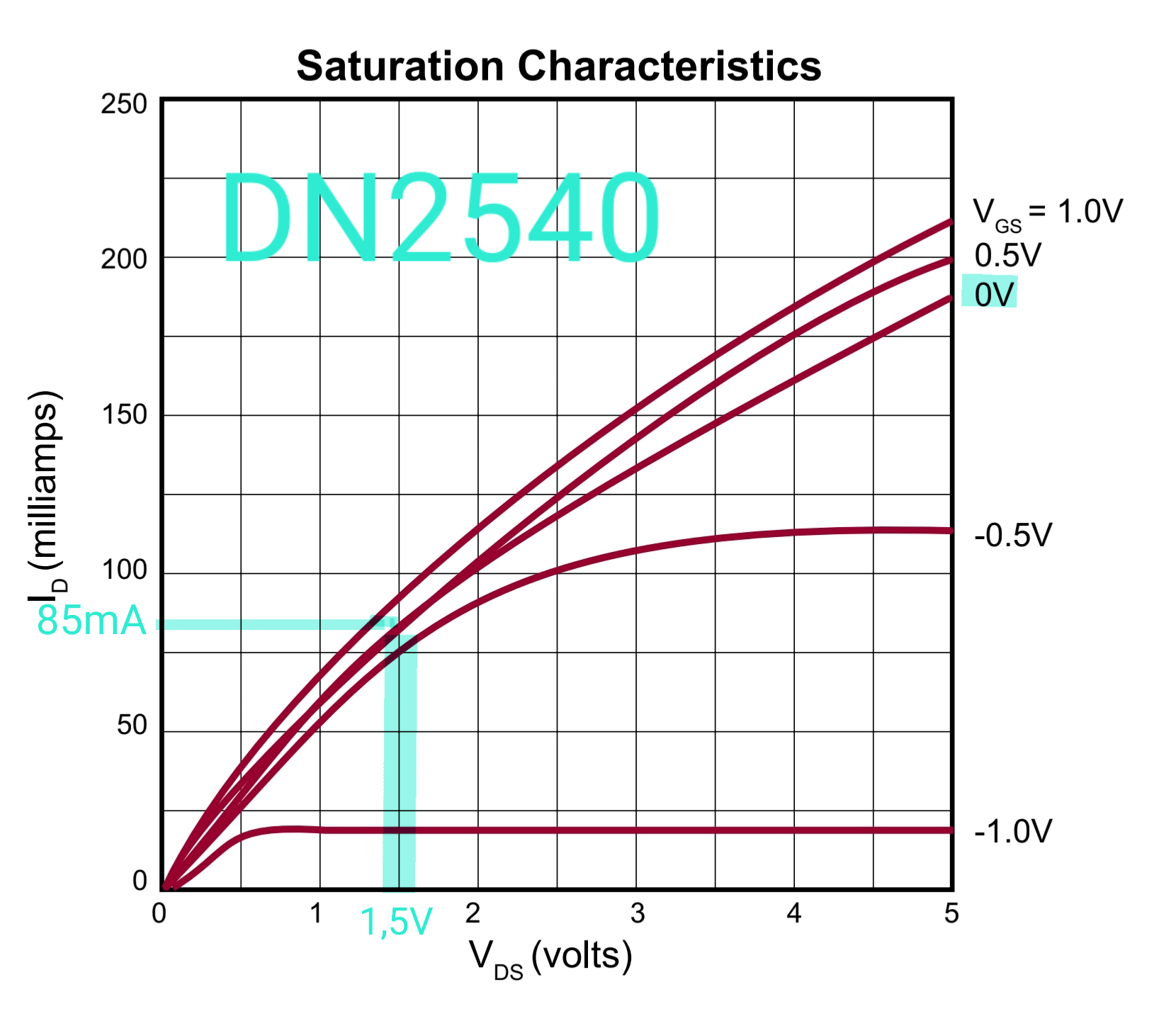

I find it in the specification pdf, Is a shame that IXYS not provide also saturation Id current curvesIf you use DN2540 as "lower" FET, in the datasheet the saturation Id current at -about- 1.5V Vds, 0V Vgs is about 85mA.
That's why I suggested to use duplicated -parallel- CCS (the other reason is the Q2 limited current capacity).

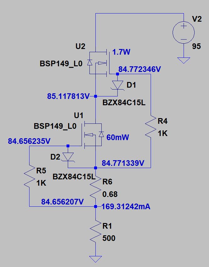

Could I ask why can't be used only two BSP149 in cascode?It was a sample to show, that BSP149 suitable for 170mA CCS as "lower" FET.
If you want to test it "in vivo", use IXTP02 as "upper" FET.
This simulation use paralleled 01N100 to achieve 200mA capability.
And yes, some heatsink need.
