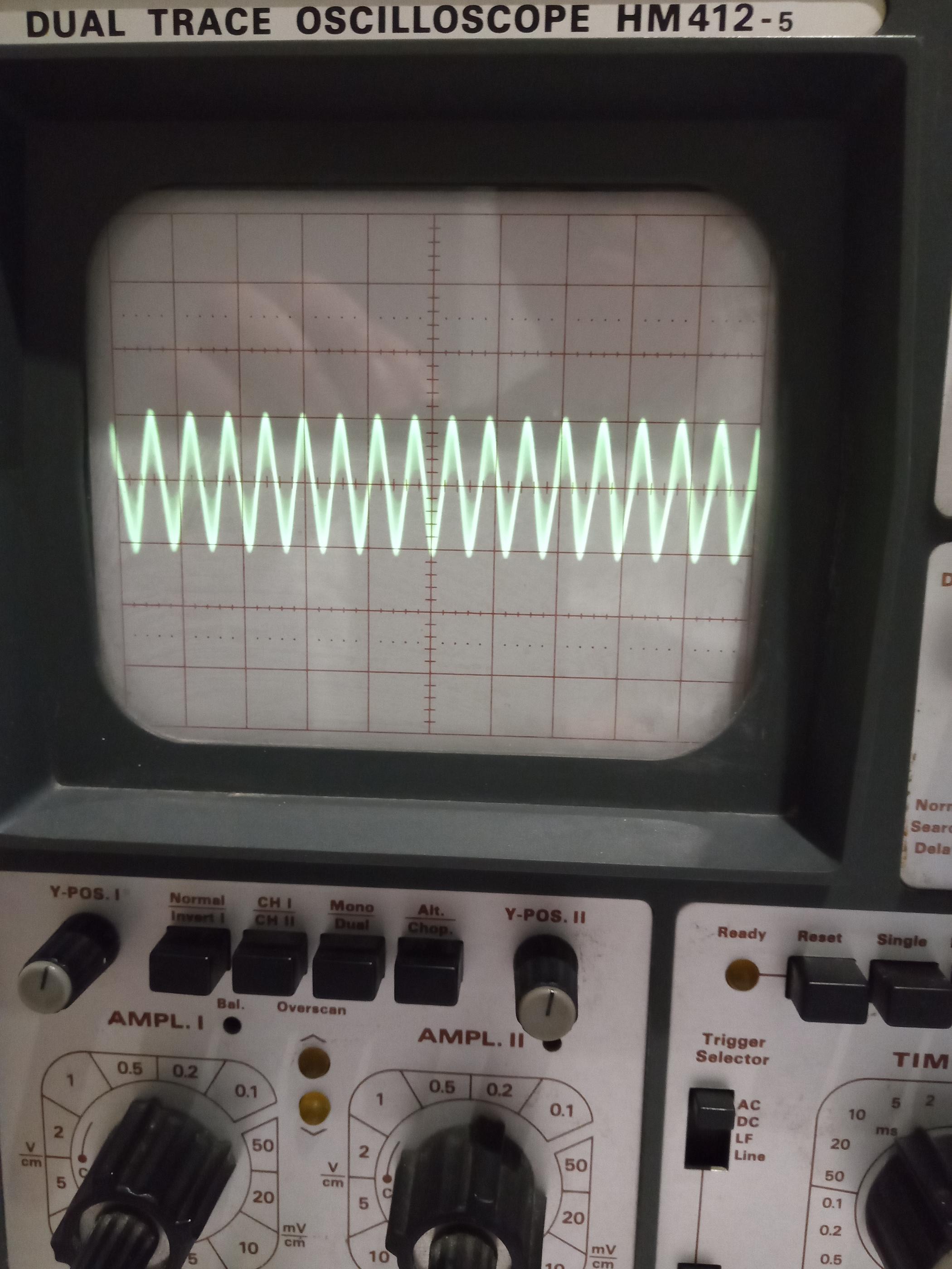

Made some measurements:
CCS SSHV set to 500mA + CCS load set to 11mA each channel
Ripple AC 51mA

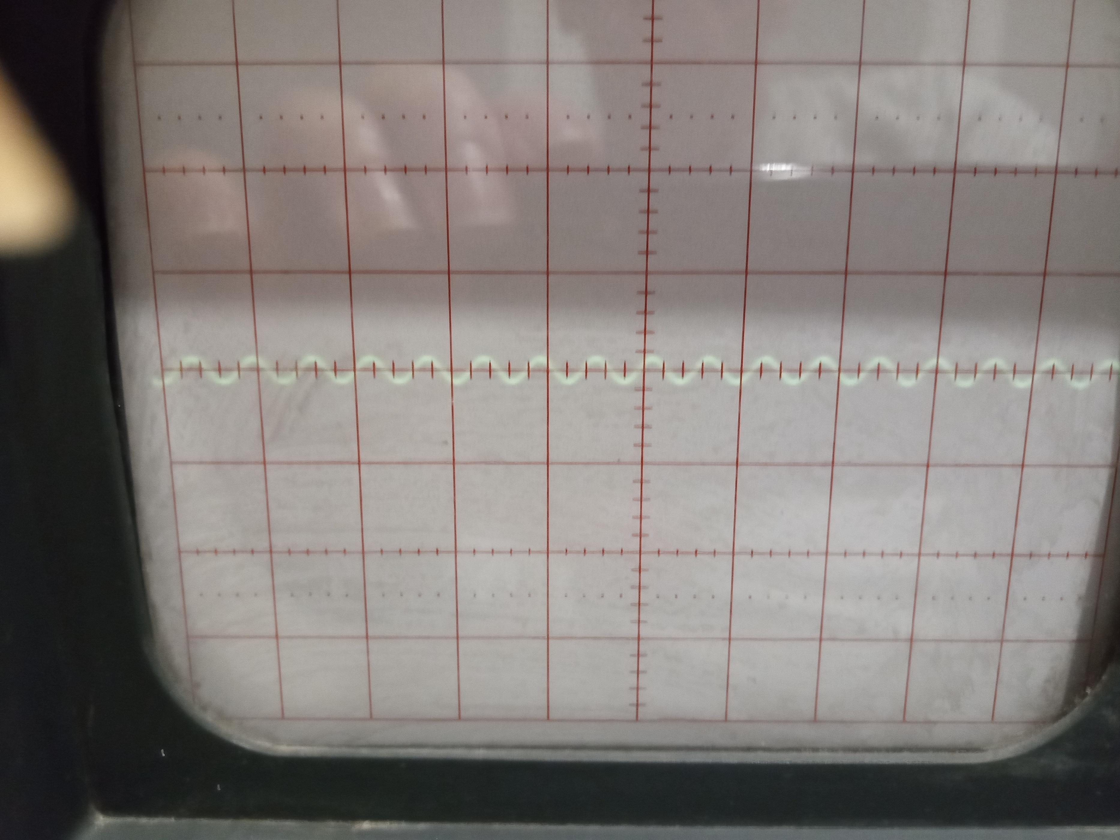

CCS load set to 11mA each channel without SSHV2
Ripple AC 43mA
Ripple AC 51mA
Ripple AC 43mA
AC coupling and 10x probe setting. Same test points in circuit as for DMM. Tweak vertical sensitivity and horizontal time scale knobs until catching the noise fish.
