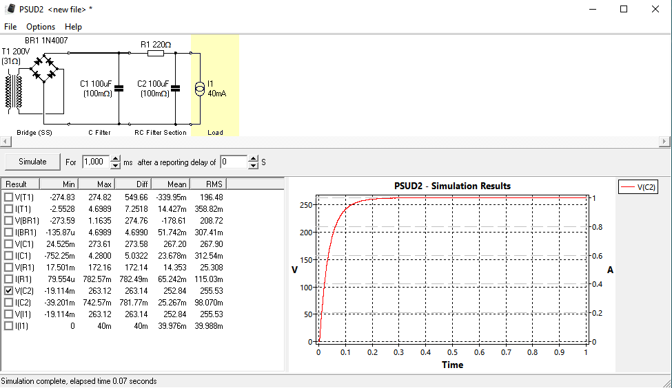

How much capacitance do you recommend between the diodes and the shunt regulator. I looked through a bit of the thread, but I realized it could take weeks.

CLC is better but be aware of a choke's possible hum field if in proximity with signal gain stages. 450uF is heavy and can promote charge up spike. Are you familiar with PSUD?
PSUD 2.10 released
You can predict a smooth configuration with that one. By adding some extra R. Even small capacitors can be enough (and faster) for small load current (CCS mA) resulting to small ripple pk-pk if with CLC. Shoot for a smooth ramp up and no more than 1V pk-pk ripple I would say.
PSUD 2.10 released

At the moment I have the following problems my transformer has a 200 0 200 output and once CRC they become 260v so it is not good for the shunt?
Is it normal that with 200AC after the bridge (4x MUR 860G) plus filter capacitors and resistors I have 260DC?

I would have expected 280V full bridge rectified from a 200VAC secondary. This shunt can work steadily even with only 10V in-out difference, so if the transformer is low or the R in the CRC too high, you could go for 250V reg output. If the R in the CRC can not help enough by choosing a lower value one.
Also see that the diodes can take the rectification's peak repetitive reverse voltage (VRRM or PIV) at your target level. Test with 1N4007 (1000V PIV) if in doubt.

What about that board in the link? Another project's rectification board you use? 1k resistors shown surely drop a lot of voltage with increased mA loading.
The board in the link is Tube-I-zator V2.0, I don't have a ratification board. You can suggest a good resistance value, in my parts bins, have two capacitors 100uf 450v one 330uf 400v one 220uf 450v a few resistances of different values and the diodes Mur860 and 1n4007 and four bridges GBPC2504, GBPC2506, GBPC2508, DB3501.
The transformer's loss spec is just assumed. Its not your transformer at your average mains level. So the resistor is ballpark value.
Adjust it smaller by paralleling another one if the output voltage falls short in reality. I set CCS load at 40mA for some leeway though.
I have made the new rectificator, and I have measured the resistance of my transformer the resistance are 54 ohm I try with one resistor 160 ohm and one 80ohm but the output of the circuit are 258V I don't know where are the problem. Is possible the transformer ?
