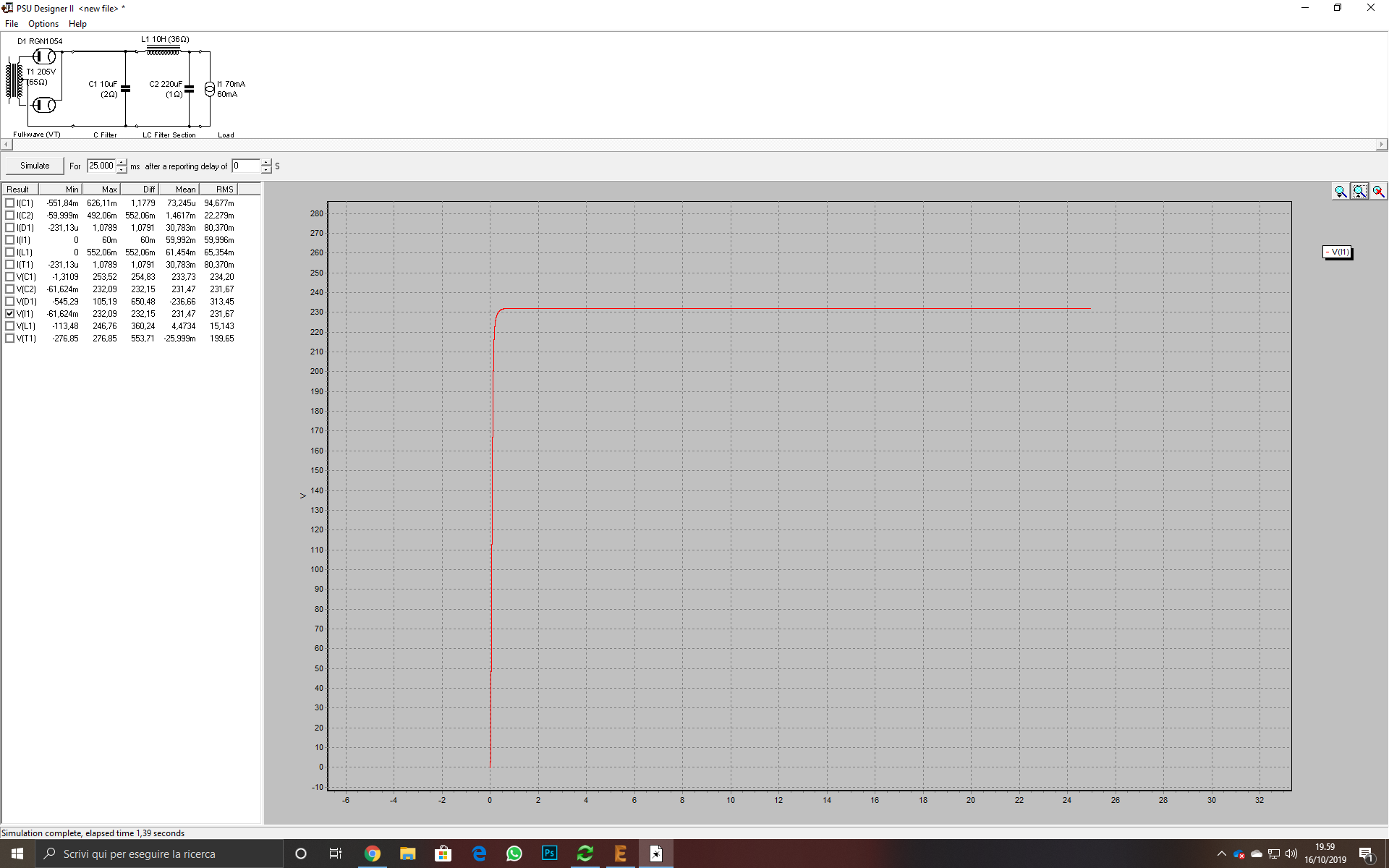

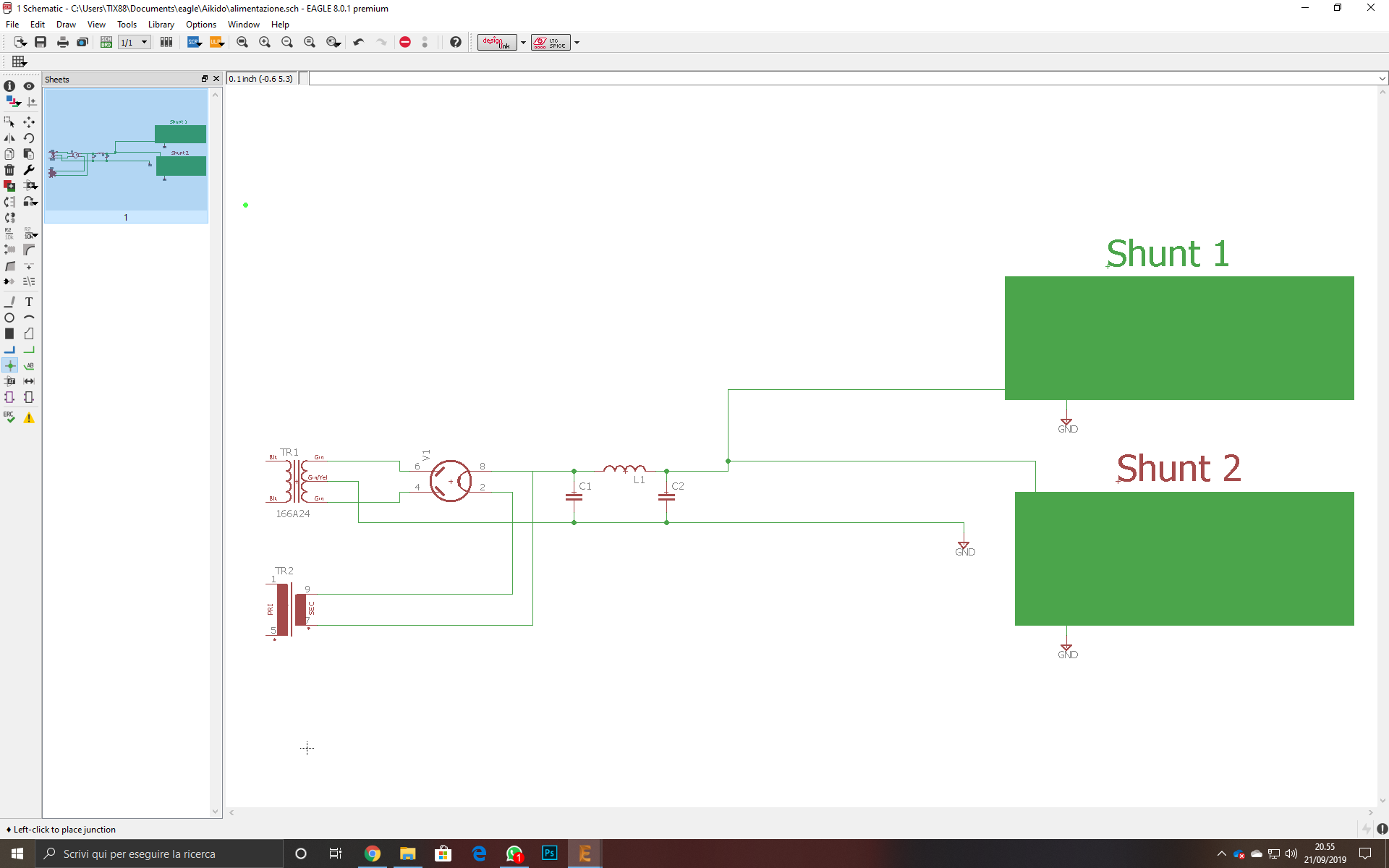

Avoid a peak. For various reasons, not only possible harm. Glitches can activate the choke to radiate an interference field. 220uF standard value for C2 should be enough for your moderate mA.

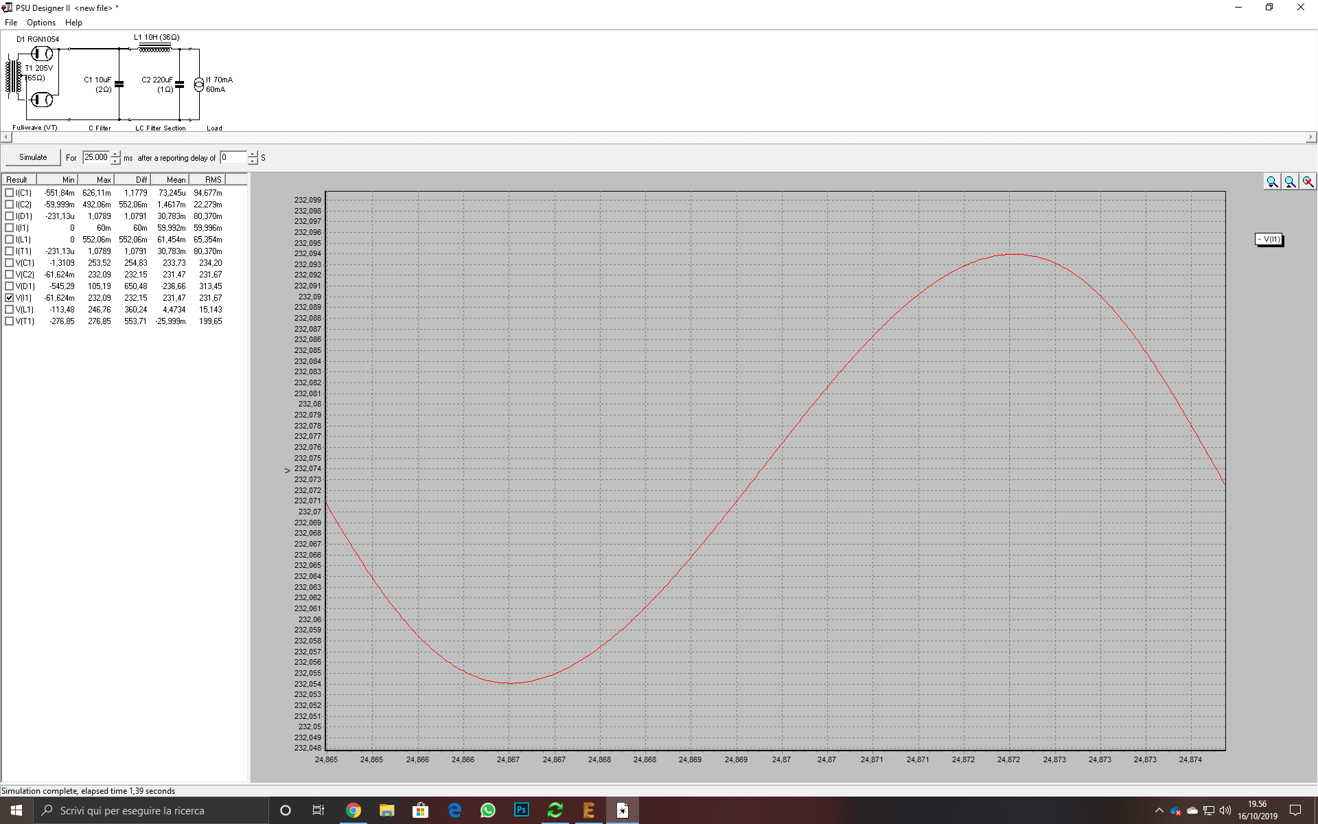

This is a detail of the simulation 20 seconds after the start of the AC. The initial ripple has been eliminated. So the shunt should filter out the residual ripple? Would I have a good power section like this?
Dissipation of it is Vout*Ibias where Ibias is the extra current you allow in the CCS setting beyond the load's own consumption. If it is 20mA extra as usually recommended then 80V*20mA is 1.6W. That's roughly because a little of it goes to the other transistors.
So you don't need a really big sink for the shunt MOSFET in your case. You had used a big sink in your picture link so its cool for that but you could also be using less than 20mA extra right now. If so, adjust the CCS setting accordingly.
Don't test the shunt reg unloaded for long when with smaller sink because it will be burning the whole CCS setting of mA at 80V on the shunt MOSFET in such an occasion. 1.6W becomes 6.4W then.
The total load is 70mA, 2x15mA for the two preamplifier channels and 2x20mA for the two shunts. Then I will proceed to the construction of the filtering as well as to simulation.
If not satisfied in the end, two RC branches after the CLC (one going to each reg's input), could be easily added to improve ripple filtering while contributing some isolation between them.

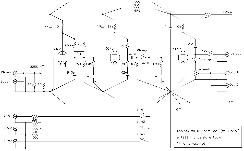

Hi Salas
Thanks for your prompt reply. Attached my phono amp schematic, could you advise the power consumption of the amp?
Can't say anything sure off hand. Guessing about 15mA for the output stage, about 3mA for the second stage and about 1-6mA for the input stage depending on k147 idss. So 19-25mA per channel maybe. But I could be guessing way off.
Configure your DMM in series mA mode and measure pulled current between your previous PSU +Vout and the preamp's +V input point. That's the only proper way to know.
Thanks Salas
Your guessing is very close, actual consumption is 59mA.
That's for two channels consumption I assume. One PSU for both. In that case set SSHV2 for T.P. 0.8V i.e. 80mA CC*.
To simulate around 60mA actual load at 250V the equivalent dummy load would be 4K.
Say 3x12K 10W resistors in parallel or 4x1K 5W-10W resistors in series.
They will burn 15W like two channels of the real preamp would. So be careful where you sit them and how you handle them.
The shunt MOSFET will be burning near 4W on either dummy loading or when powering the preamp so sink it accordingly.
Good luck and let us know.
*If with dual mono PSU (one per channel) T.P. should be 0.5V and dummy loads ~8K each. Shunt MOSFETS burning 4W each.
