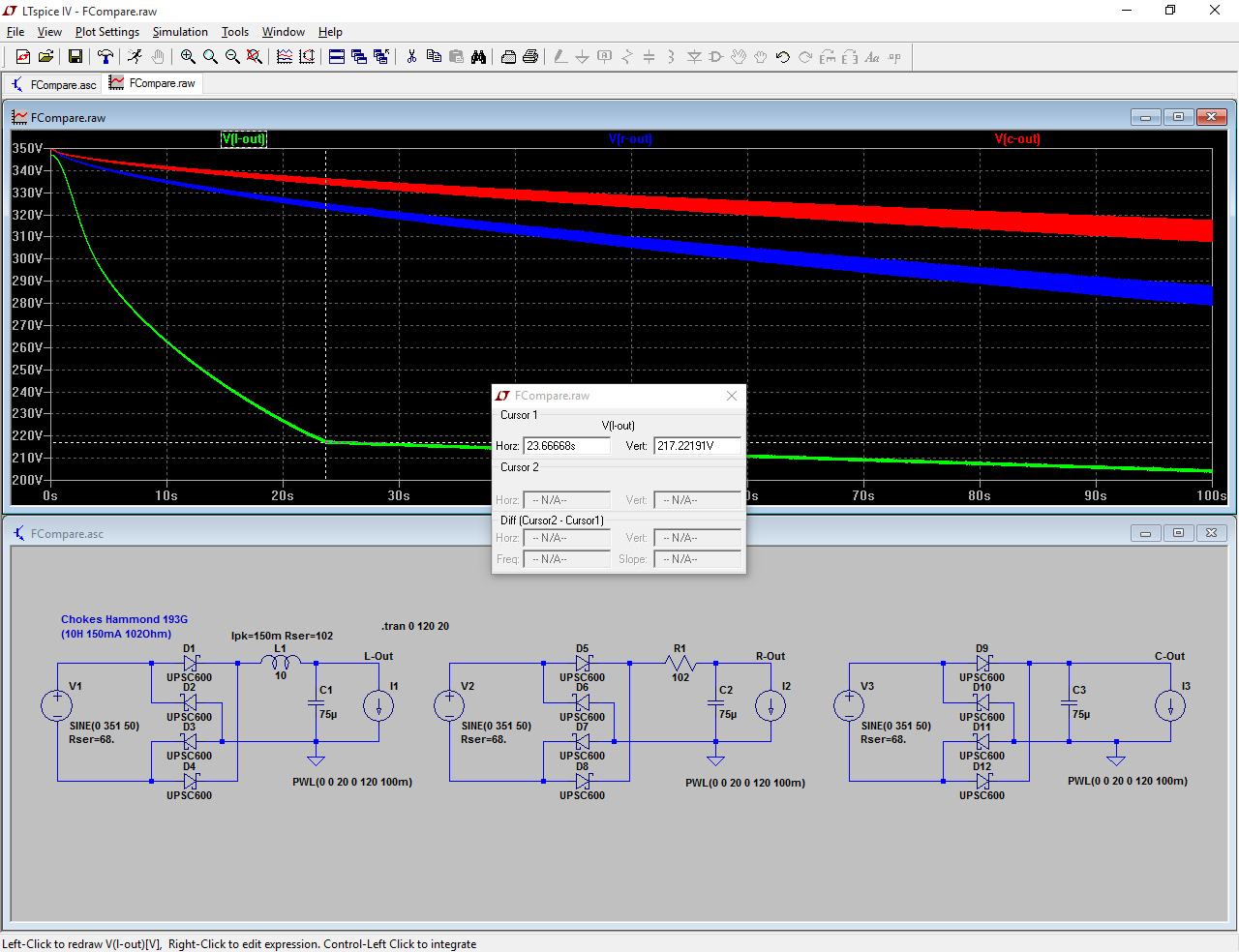

Just for fun I simulated three cases with the same "front end" (a 230V 0.27A transformer with 8% regulation and a Schottky bridge) and
- LC filter,
- RC filter with the same active resistance as the choke in the first case,
- C filter.
"Classic" view is that if you drop the load current to less than some value (determined by a formula) you'll "lose" the inductance properties and the filter will approach the pure capacitance model. Let's look at my simulation in the attachment. There are three graphs: red is pure capacitance filter, blue is the RC filter which imitates the choke "without inductance", green is LC filter in question. The 0s point is 0mA of load, the 100s point is 100ma load. The function of the current is linear between the points. To achieve some steady state I allowed the models to work for 20 sec before the 0s point. We can see that there is a knee in the LC graph, but the whole continuity of the graph shows that there is no losses of inductance properties. In reality the inductance of choke will increase with decreasing current smoothing the transition ever more.
By the way - if you want to determine a minimal load which allow you a safe voltage point you can look at the green graph. For example if you have a capacitors rated 250V (-10% safety margin=225V) you should not have less than around 20.5mA of load current which gives you 225/20.5=11k resistor with more than 5W of dissipation.

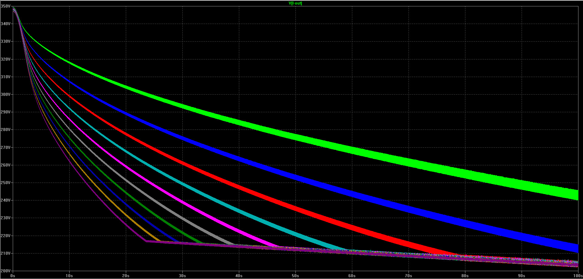

Unfortunately I could not understand what you mean saying "effective", but the second part is easy (see in the attachment).Could you do simulations trying to find the smallest value choke that could be of effective??
Or just to see what smaller chokes could do under the same situation, please??
But you can easily make this simulations yourself: the program is free and (while not so user-friendly) easy in use. PM me if you have questions about it. 🙂

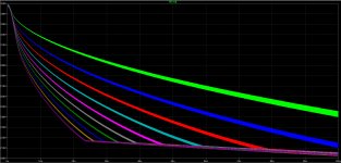

P.S. Sorry, some comments: there are 10 graphs representing inductances from 1H (top, green) to 10H (bottom, dark magenta) with step of 1H (so the blue line is 2H, red line is 3H and so on). In reality there will be some differences, like different active resistance of chokes, but the changes will not be big.

The increase in voltage from 217Vdc to 348Vdc is what could break your capacitors if you don't design for worst case voltage conditions.
And when mains voltage is at 106%, it gets worse !

The graphs show that there are many different voltages between the two voltage values you mentioned. You should design for your real situation.
