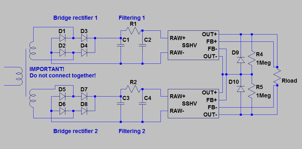

I think at the expense of an additional board and if you have double secondaries (isolated) you can stack two regulators (in serial) to overcome the voltage limit.
Appreciate if you could show by a drawing as how to stack two regulators to get more than +540V with a DN2540 board please.

Something like this:
No, they are just diodes. The max reverse voltage should be more than half of the output.D9, D10 are 12V 1/2W zeners?
Theoretically - 2x400V=800V, but I'd give the layout 10-20% margin, so up to 700V approximately.What will be the max. Vout?
In a serial connection there is a sum of voltages, not currents, so the initial limit will apply.CCS will be the sum of the two regs so max. 200mA?

I think that special care should be taken for the transformer : One of the winding beeing probably referenced to ground, the other one will be partly floating 800v above surrounding parts (core or other windings). Enamel insulation might not be sufficiant, you could then have arcing between windings or core.
Check if possible transformer specs, base insulation of 1000v should be needed. Specifically designed transformers is a solution to but more expensive.

If a transformer has some voltage specifications it has to have strong enough insulation to sustain the tension. Even if the transformer is used in, say, full-wave rectification with the grounded midpoint the voltage difference between the outer part of windings is still twice the voltage across the single winding. So the enamel insulation must prevent arching by the design anyway for the case.
The case of the voltage difference between windings and the core is more interesting. I agree that there can be a problem. But if you are building a device with 600V supply you have to buy a transformer which can withstand the voltage (so - expensive). On the other hand if you take care of phase of the windings you can still ground the midpoint of one winding and then - there would be no point in the winding with double-high potential (relating to grounded core).
Even if the dielectric on a good trafo is usually good for this, a bifilar secondary should be avoided and a layer wound secondary with insulation layer to be prefered. Core should be grounded as usual. But this is nowhere an extreme case. Make it two trannys and your home free.

That was just to point out that some arrangement of transfo secondaries : windings in serie, heater's voltages referenced to a floating voltage , reflects internally by making neighbours sometimes big potentials differences separated by just a small fraction of a millimeter insulation.
As stajo told, quality transformer should not give any trouble, but better keep your ground connected to earth and a good differential breaker on the power line.

I'd like to add something. Slightly modifying the SSHV layout you can achieve a side but marvelous effect of isolating the transformer from the circuit by connecting the CCS backwards and moving it to the negative line in the lower SSHV. This way you won't have to ground any winding of the transformer (just frame and core).
