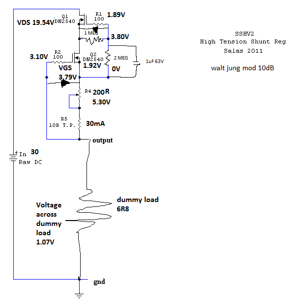

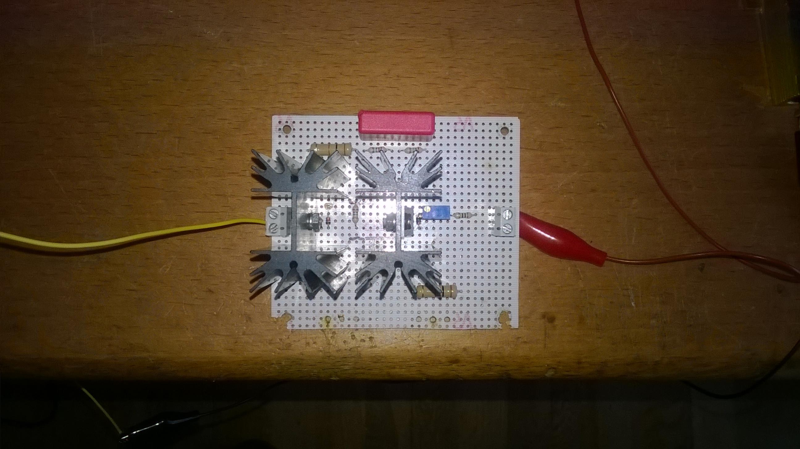

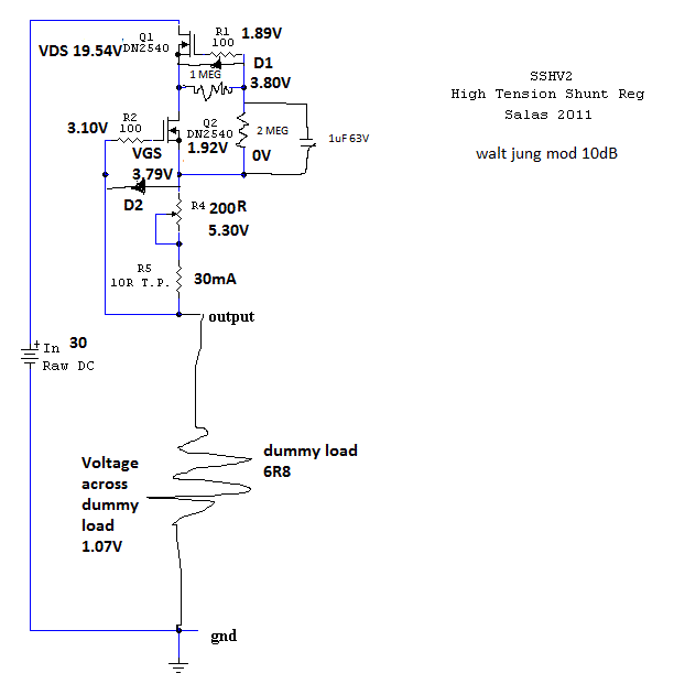

Its the safe troubleshooting procedure you know and followed before. We have a link of such a recent practical example in post#1. Maybe find a way to include the Zeners this time and/or make a matrix board of the full circuit including the Jung mod to have ease of construction and test/repair.
Is a good idea I will make a matrix board with only the CCS Jung mod using the zeners.
Indeed a good idea. Test it on low voltage first.
Zeners placed like attached schematic?
No, the lower zener is turned around.

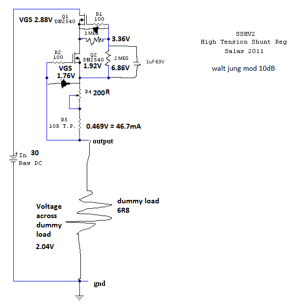

Attached pics: schematics with measurements & populate pcb used big heatsinks tall 5 cm, gate resistors 2W and most important: used 12V 0.5W zeners to protect the DN2540.
I left powered 1/2 hour if nothing happens could I try o add the rest of SSHV2?
