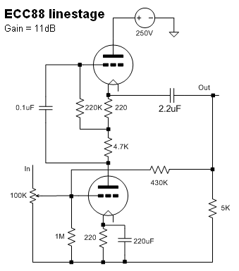

Dear Salas,
I am about to wire up this ECC88 linestage, and will try your HV Shunt. However, I am a little confused which HV Shunt version to use. Could you take a look at the linestage schematic and advise?
PS: My power transformer has a center-tap output of 370V-0-370V, and I am planning to use 5U4G tube rectifier.
Thanks.

SSHV2. Use some RC before it in case you got more than 50V input to output drop to spare. 20V drop over the regulator will be plenty.
Thanks, Salas. I will try this SSHV2.
SSHV2. Use some RC
An LC would be ideal since there is so much voltage to spare. 370 minus 30-40 V drop times 0,9 is about 300 V and the SSHV has plenty to spare for the circuit
Yes, Stajo. That should be no problem with me. The only problem I just found is I cannot find some of the components here in Vietnam including DN2540, KSA1381, and SK117. Not sure if there are substitutes available.
If you can order from for example Mouser they have DN2540 and KSA1381. SK117 I would suggest Ebay
Yes, I think I can. Thanks, Stajo.
