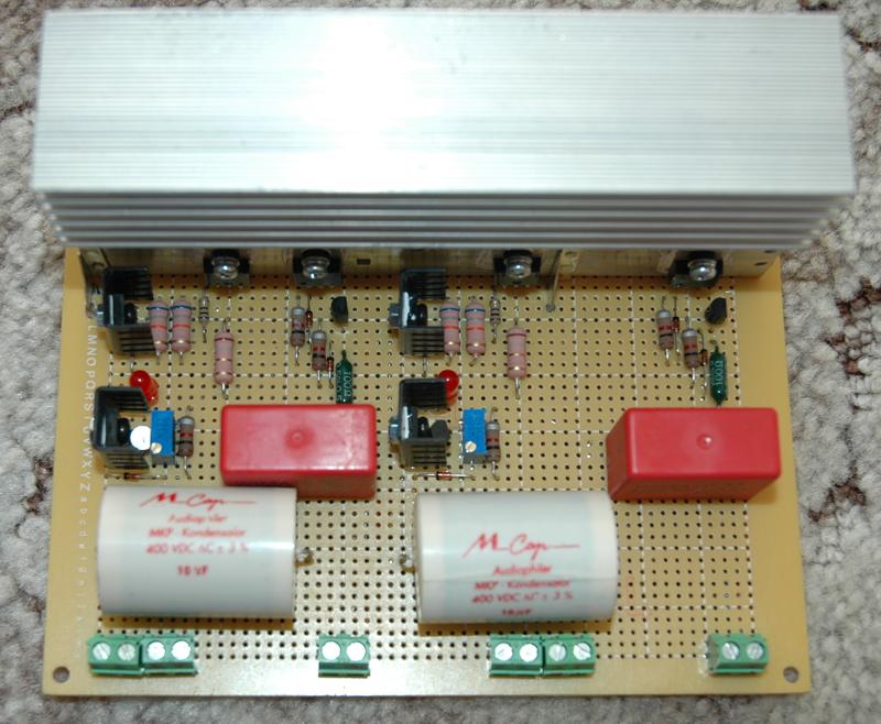

This is my #26 preamp SSHV2 regulator... DN2540 CSS and the shunt mosfet on the same sink..
250V input, 220V/ 5.5+5.5 mA output (cCCS are 20mA).
Heat sink about 45 degree Celsius (after 4-5 hour).

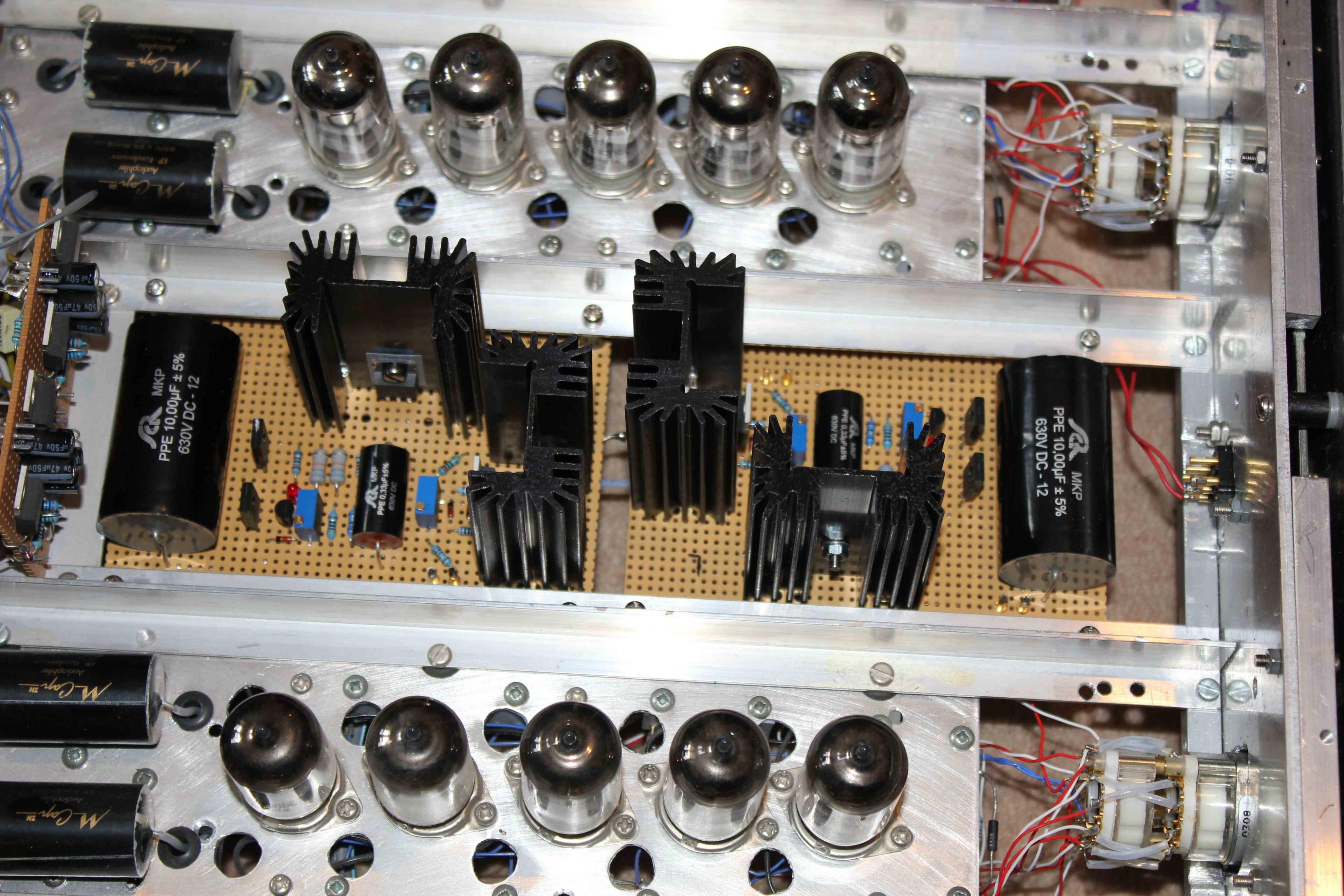

As promised, here is a photo of the two SSHV2 regulators installed in my RTP3.
There is a definite advance in stability and presence over the (probably malfunctioning) HPHV regs they replaced.

HPHV is Emile Sprenger's shunt reg. I would post a link to it, but Emile took his pages on it down two or three years ago. If anyone is interested I can send the user manual privately. I suspect that on a professionally made PCB this sophisticated and complex circuit should work very well, but I found mine were unstable and unreliable. This is why I hankered after a much simpler and more robust regulator circuit, and settled on the SSHV2.
The caps are SCR 630V polypropylenes (which I also used in the PSU).

Alex, very nice. Thanks for the update. You followed the parts layout of the printed board I saw. Is the pre-amp a Vacuum State original construction or just follows it?
Thanks!
Yes, the RTP3 is my own build, but (as with my version of your reg board) a close copy of the "real thing".
