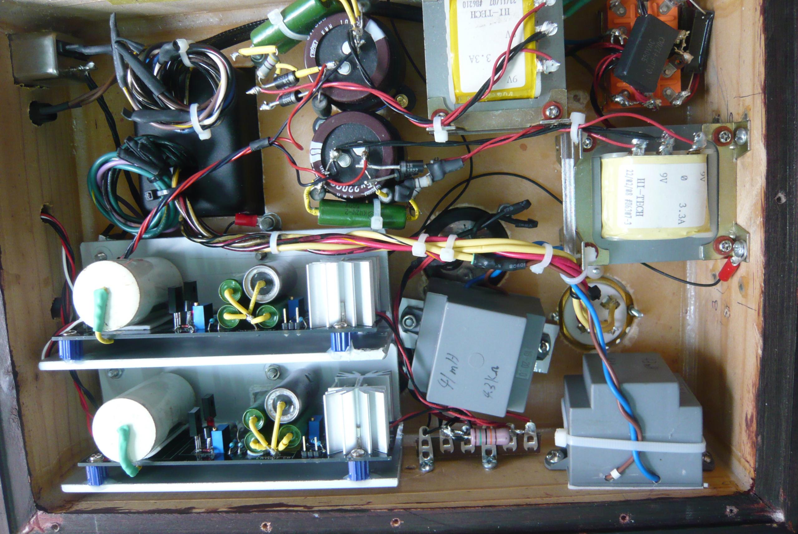

:hohoho::cheers:...thankyou for all the helps....I have finished changing Q4, Q5 and the 117 on the questionable board mentioned...I have also renew all the solder joints....I have also added small heat sink with fins to each of the Q4 &5....the 2 boards are now doing 279V in....30mA at TP, and 260V out, with 48V across the 6K loading resistors......they have been steady for more than an hour.....but the Q4 and 5 are still quite hot....and when I blow on them...the V out jumps to 265...it is normal like this??.....I am thinking of adding a piece of aluminum strip the the sink
The photos show the two board installed (no sink yet seen with the Q4 & 5)
Nice photos. When you blow there, yes its normal to drift. There is no ventilation there in your build, so help them Q4 Q5 out with sinking when able.
