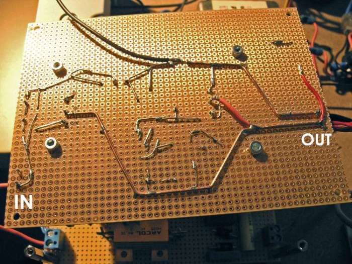

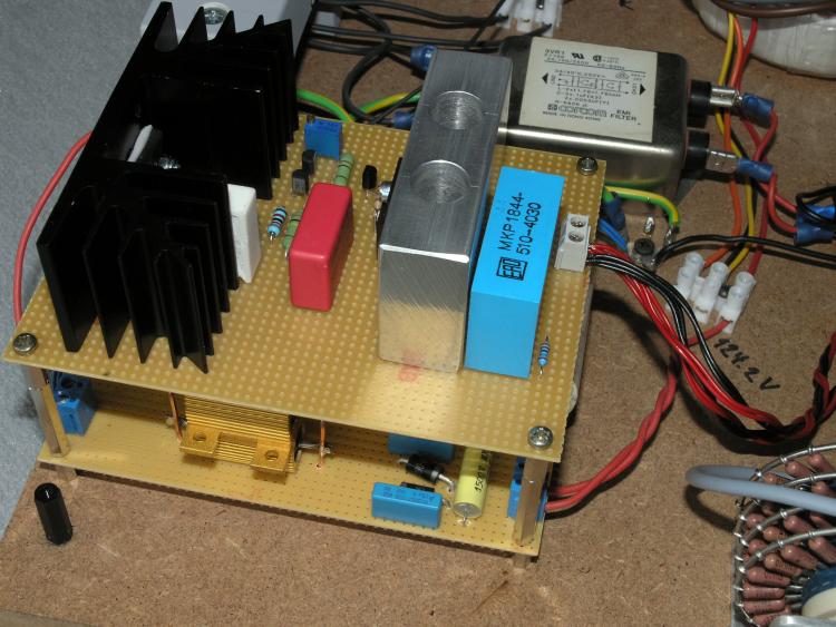

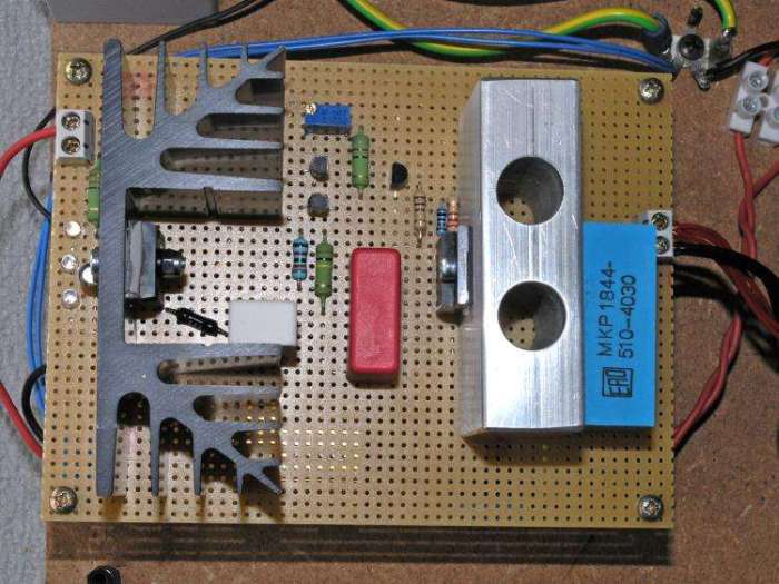

No 2 is working...
It is basically the same as my previous one with much better P-P layout (I think), the IRF840
substituted with IRFS450 (had some on hand) and R1=22R. So far no problems at all, only
observation is that Q1 is taking far more heat than the shunt Mosfet.
Vin is 250V, Vout=~200V.
I observed this behaviour in all of my variations so far, contrary to Salas' predictions...
Any thoughts on this?

If your amp is getting the juice, the shunt (Q3) will be relaxed. The high dissipation noted for Q3 on the schematics is max, when on zero load, steady state. The harder you play the amp, the cooler Q3's sink will appear. When the CCS Mosfet (Q1), is always working at max. If setting the shunt say form 70mA to 100mA, there will be much more perceived heat due to steady dissipation from Q1 than maybe thought of, if keeping the same sink size. Q3 is working back and forth with the load, giving rest time to its sink. Q1 accumulates heat on its sink at all time. But the TO-240 CCS Mosfet is heavy and reliable, don't worry much if the sink is not really on the edge of
. Just back it down on CCS a little if the sink at hand proves a bit stressed. Also always check the total Vdrop of the Led string. If a bit stronger for Vdrop, then they can be setting the CCS 10-20% stronger than needed (depends on Vgs tolerance of each Q1 part too). 10-20% can make a lot of heat difference on a sink when there is constant current. By measuring the Vdrop on the CRC pre filter resistor and dividing by its nominal value, you will know the CCS current, no need for connecting a DVM in series.

But the TO-240 CCS Mosfet is heavy and reliable, don't worry much if the sink is not really on the edge of *fire*
Heatsinks are large as in my first one... max. temperature so far is..well... I can still safely touch it without burning my fingertips.
