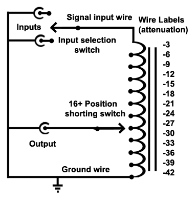

Definitely yesterday was very very tired, I'm sorry for misunderstanding about TVC gain but I know there is some TVC with gain....
Quote from Dave about TVC
"Yes, some people report good results but be aware that wiring for 6dB of gain means that the source will see only 1/4 the inductance of the full winding. Stacking the core with more interleave will recover the lost inductance, though the ultimate success may depend on your system and your requirements."
