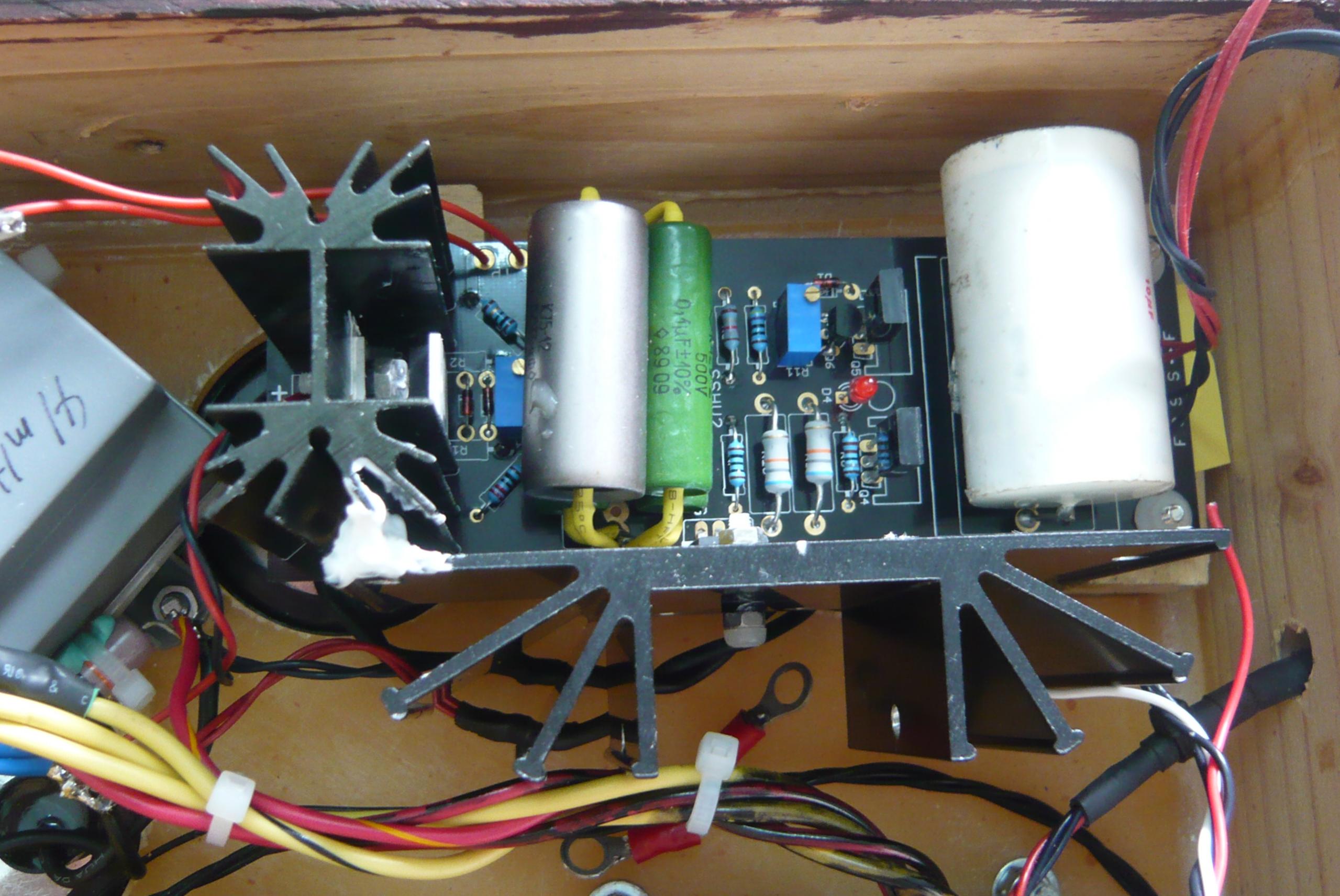

Simplistic mosFET HV Shunt Regs

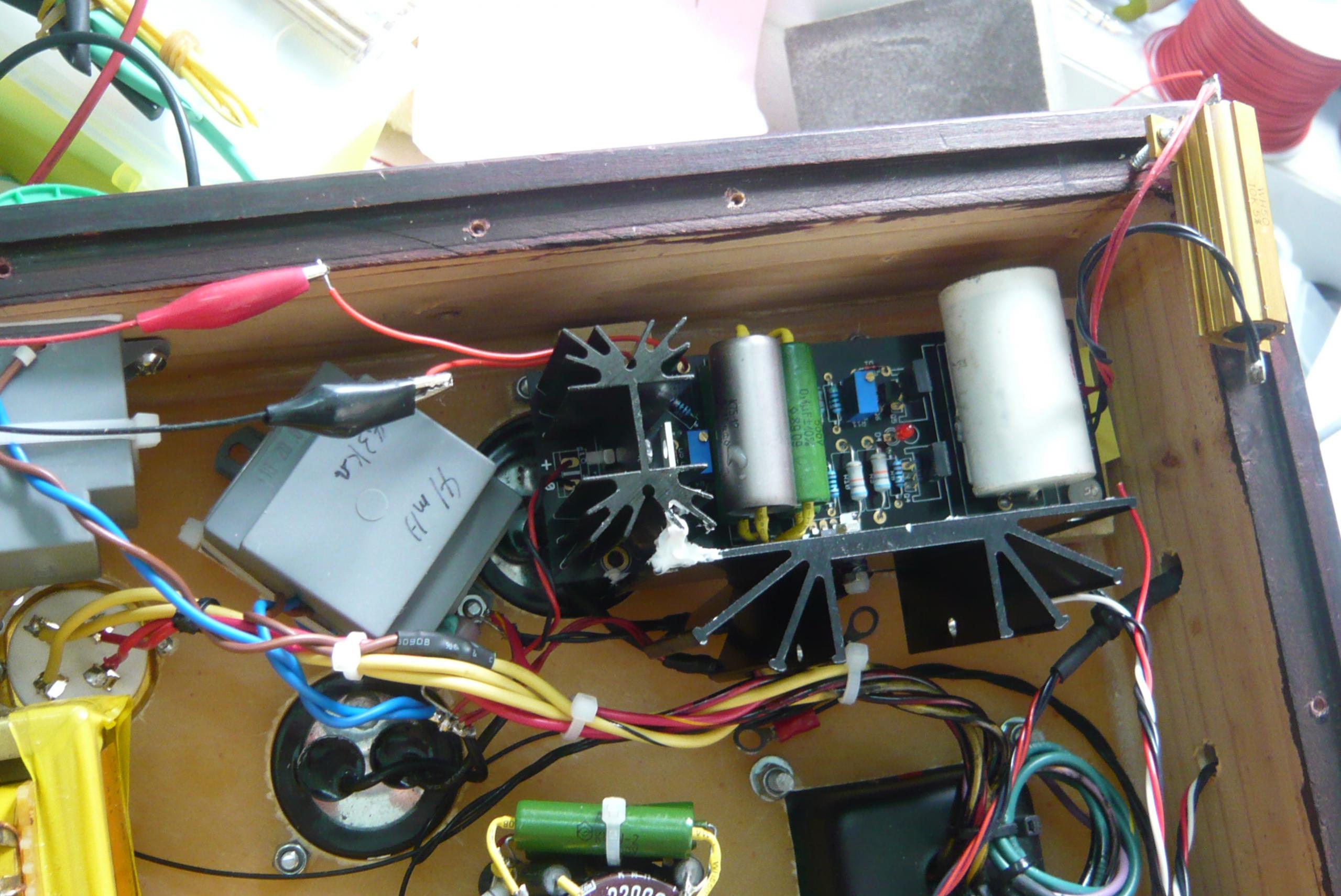

I measured last night, with a 22K/50W parallel with one 10K/50W, the voltage across was 286V on start up; and went to 288V after 3-5 minutes (the 10K also gets a bit hot).
Next week, I will remove the 22K and the 10K, and connect to test the SSHV2....

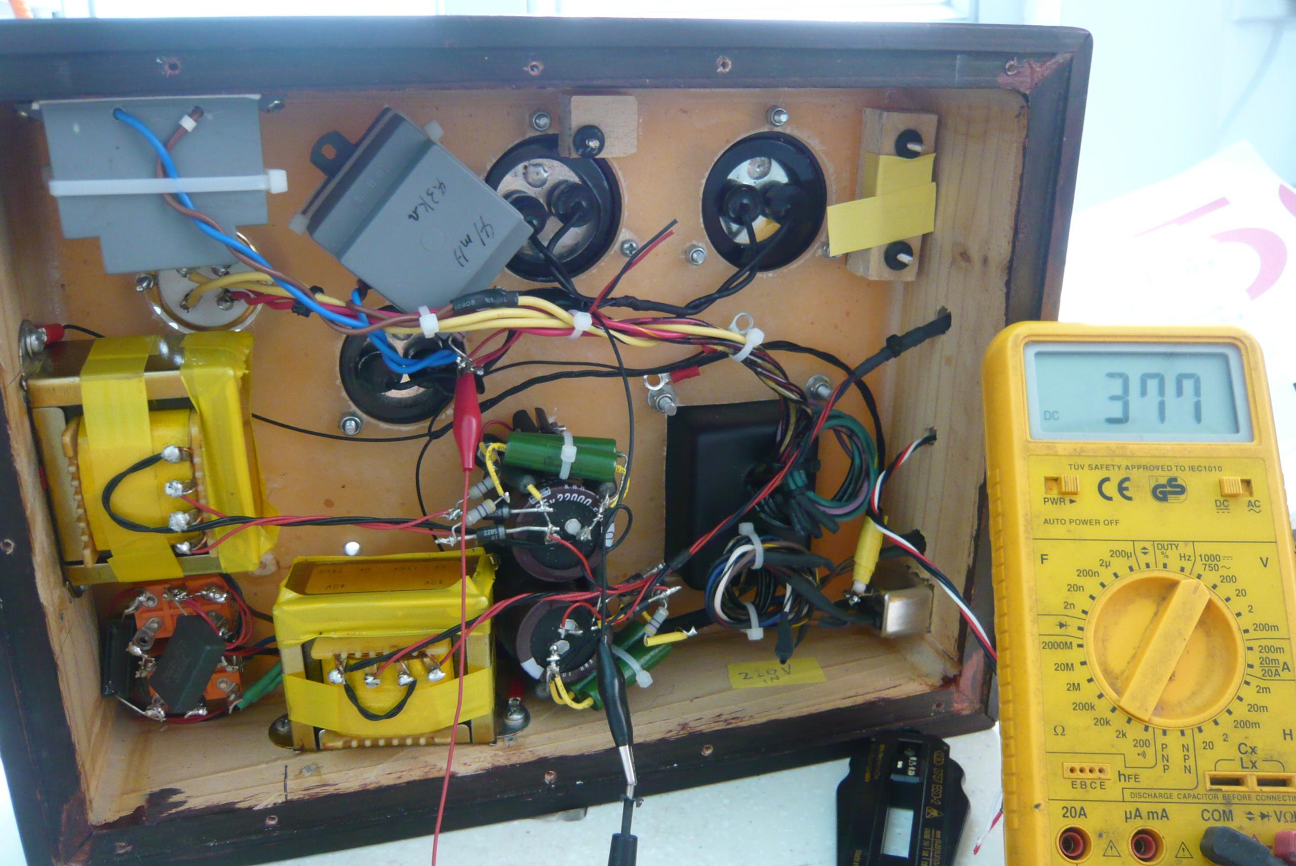

Final testing of new PSU with 150K bleeder only. V out = 377V
SSHV2 testing perfect....all behaves according to Ohm's law + Salas' law

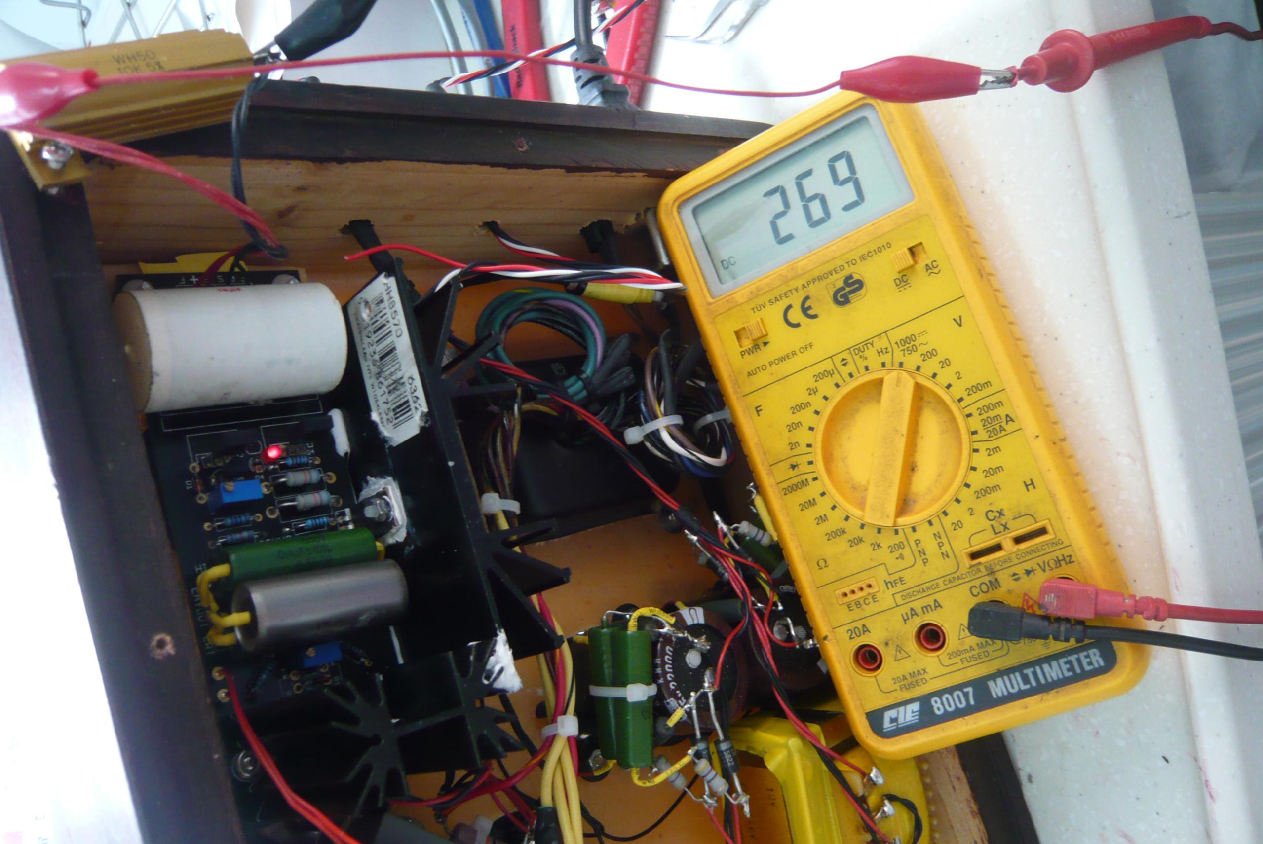

SSHV2 output set at 269V and input = 280V.....T.P. set at 50mA....
I now thinking of loading the VT=25A with 15mA each....with B+ at 267-270V....
