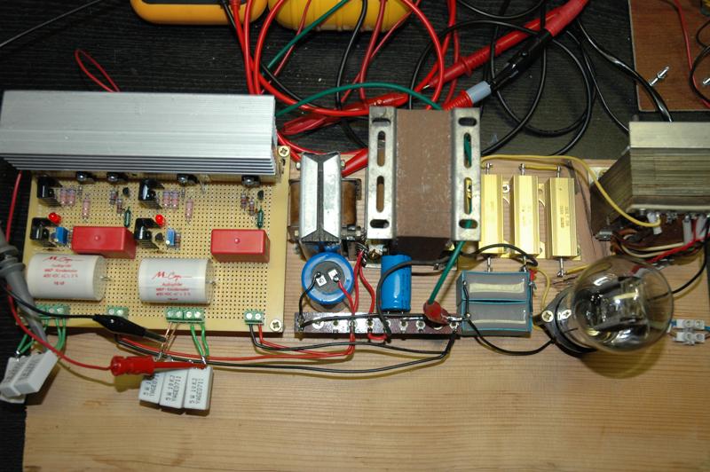

Testing dual SSHV2.
Raw supply: 240V ct - AZ1 mesh- 5.4uF -10H (100R) - 47uF -3H (80R) - 220uF -> 254V
20mA CCS, 7mA load (#26 preamp), 220V.
Noise below 1mV (in the other side 2.5mV)!

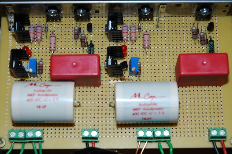

Was able to back down the drop across test point, but with inly 16V out of prefilter, i am dropping almost 12V across 220r resistor on prefilter. 500mV across R1, 3.5 across r2 of sshv2 is yielding 160 mV across r5. Diode ,easuremnets reflect gate voltages.
When i first fired it up, i fried r1 along with 220 on prefilter. Did i fry the q1 in the process?
Yup. For the gate resistor to q1 to fry, i cant imagine q1 not being toast. Changed out resistors and zeners just in case. Will do q1 tomorrow. Considering that at such low voltage the fets are passing do much current, it is the only posibility i can think of. Hey, wheres that gun?
Stay away from guns. Such Q1 stuff happens in best of families even.😀
Check all your self made PCB's connections against schematic with a clean mind, use a 47uF capacitor directly across DCinput after you had exchanged all parts suspect as hit.
