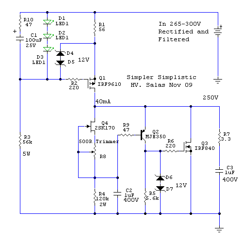

I am about to build a SSHV1 clone.. already have the PCB, and carefully read through the first 2000 posts of this thread....
I've created a simple Excel spreadsheet to make "ballpark" calculations of critical resistors and Power dissipations easier.... I thought I'd share it with you guys , and try to save Salas some time...😉 as a way to say 'Thank You' for the great design and sharing it !
(Hopefully there's no mistake in the formulas 😀)
The CCS current resistor is calculated thanks to a very basic "Home Fitted" curve of the IRF9610. I've chosen an arbitrary intermediate junction temperature between 25 and 125 deg C. You're free to modify it to your needs and improve the Excel if you're a computer pro.

Hi Fred
Its not easy to extract mA range from that International Rectifier published curve, has no much resolution down there, but from experience I would think that a 32.6 Ohm R1 may give more than 40mA in your example. ~50R I would say.

Hi Fred
Absolutely!
My model gives 51.8 Ohm for 40mA
The example here with 32.6 Ohm was for 60mA of CCS: The 40mA is the current that is shunt by Q3 on top of the current consumed by the load (it's not so clear in my spreadsheet, I'll make it more explicit for users here)
But you're totally right, the published picture is not so accurate (plus it's difficult to estimate the junction temperature), so the model should be used as a ballpark calculator only... then it's mostly up to what resistor you have in the drawers !

Absolutely!
Here is the fitting I have on my LibreOffice spreadsheet 😎 (that is when IR curve is well aligned with the graph)
Bravo, that's a close one then. Nice effort and a handy tool to the user. Maybe I will have to stick it along the recommended schematic link.

Even better for reading. Nice. But can you include the basic schematic without remote and big d1 so to be compatible with what most made?
Sure !

Very nice. I will try it out more later and I can include V3 calc with the SSHV1 evolution post linked from page 1 for everybody to can point to and have less questions. With your permission of course. Is that OK?
P.S. With the last included schematic ''current reference'' cells should read ''LEDS Voltage'' D1,D2,D3 to match I think. You also include a rectification & pre-filtering drops calculation section. Would be better to depict that front end example with a schematic too, so people will picture it better?
