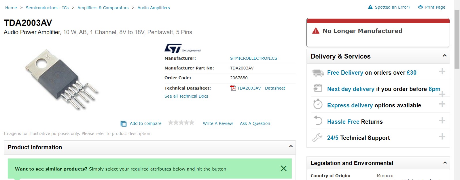

Consider TDA2003.
Not longer manufactured but thousands around, Farnell has them for 0.94GBP
And they were *designed* to drive 2 ohm load.
https://uk.farnell.com/stmicroelect...udio-10w-car-pentawatt/dp/2067880?ost=tda2003
http://www.farnell.com/datasheets/1690488.pdf
Very simple internal schematic (for a Chipamp), 10W RMS into 2 ohm; 12W RMS into 1.6 ohm , fed from a 14.4V supply (they were designed for car amp use, and that´s car voltage with engine running).
In practice, any nominal "12V" supply will do so they are easy to feed
As in: 12VAC 2A transformer + 2A diode bridge + 4700uFx25V electrolytic will give you about 15V raw, will drop some under load.
Sound is very good, at least as good as any oher chipamp and datasheet includes a generic PCB design

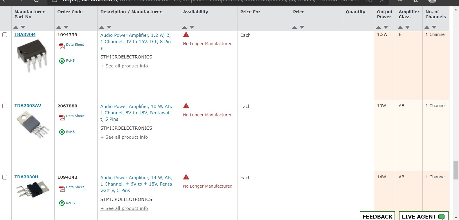

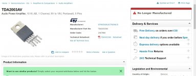

The prices on Farnell's site only appear for a second or so and then are overwritten with other info. No way to order them that I can see.
Refreshing the page brings the prices back but again only for an instant. Generic search shows not available.
