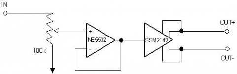

My question is, since I would like to get my Aleph-X up and running soon (as in sooner than I could concurrently build a high quality preamp), would it best to throw together a simple preamp built on perfboard with something like an LM6181 to convert from unbalanced to balanced input? Or is this not really worth the effort and expense and it is best just to run the Aleph-X with an unbalanced input until I make something fancier?

Only ease of construction. The circuit I envisioned was one resistor, then op amp, then a pot, then the other chip. No other resistors, no caps except for the PS filtering. Much quicker to construct than a BOSOZ with CCS.
As shown in the attached schematic:

I picked up some opamps to do the single ended to balanced conversion a while back. I think they are DRV134. Might be DVR134.
Based on this article:
http://sound.westhost.com/balance.htm
It sounded to me like a buffer stage + SSM chip would yield great results for a super low parts count. The problem with doing it in multiple op amps is that either precision resistors or resistor matching must be performed to get best results (no flame please, read the article). I considered multiple op amps, but then I agree with Grey. Once the parts count goes up significantly, a BOSOZ + CCS is likely to be the best performer for the effort required to build.
I have made a balanced pre with a DRV134 and the results are excellent even compared to BZLS.You don't need other opamps and multiple stages which will complicate matters.Just one chip per channel is enough.However the gain is +6db only which is ok for a normal line source of course.

Thanks for the tip about the DRV134. It looks to be a better performer than the equivalent SSM2142. You haven't dissuaded me from dumping the buffer stage, though. I found the article too convincing, certainly enough to try it first the author's way.
