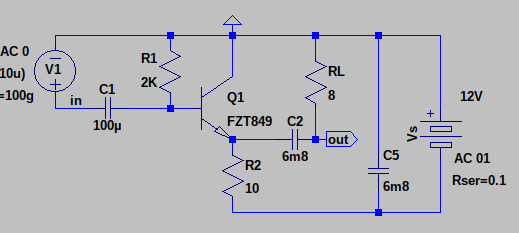

Great project with excellent docs and build info as always from @PMA.
I'd like to add one simple modification which allows mounting the power transistor directly on a grounded metal chassis without need for insulation. The mounting tab of power transistors connects to the middle pin and that is usually the Collector terminal. The ground reference point simply moves from one end of the supply to the other, with basically no change in circuit behavior.
(Transistor model and part values are only for illustration, please stick with Pavel's values for a working circuit).
This circuit is also ideal when the load resistor R2 is replaced by a current source which then is the only factor that determines power supply ripple rejection.

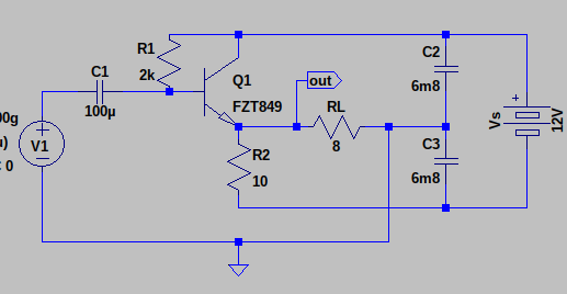

And here is another little variation that directly improves on power supply ripply rejection without the need of a capacitance multiplier, both with open input and terminated input (rejection largely depends on source impedance because this impedance basically is a parasitic like the ESR of the cap to which it adds).
Further, the split output capacitor (which doubles up as supply filter capacitor) is moved outside the loop and therefore frequency response is only limited by the input capacitor. Output impedance stays constant at low frequencies. That may or may not be of relevance for the application.
What's relevant is handling of power on/off transients which are quite severe in all of these circuits. Probably the simplest solution is a DPDT mute switch, with one contact shorting the input and the other one shorting the output. That way, both capacitors charge quickly.
Also note that the second circuit absolutely requires a fully floating supply (2-prong wall-wart etc) otherwise it will send DC through your speaker when the input also gets earth-grounded :-(
