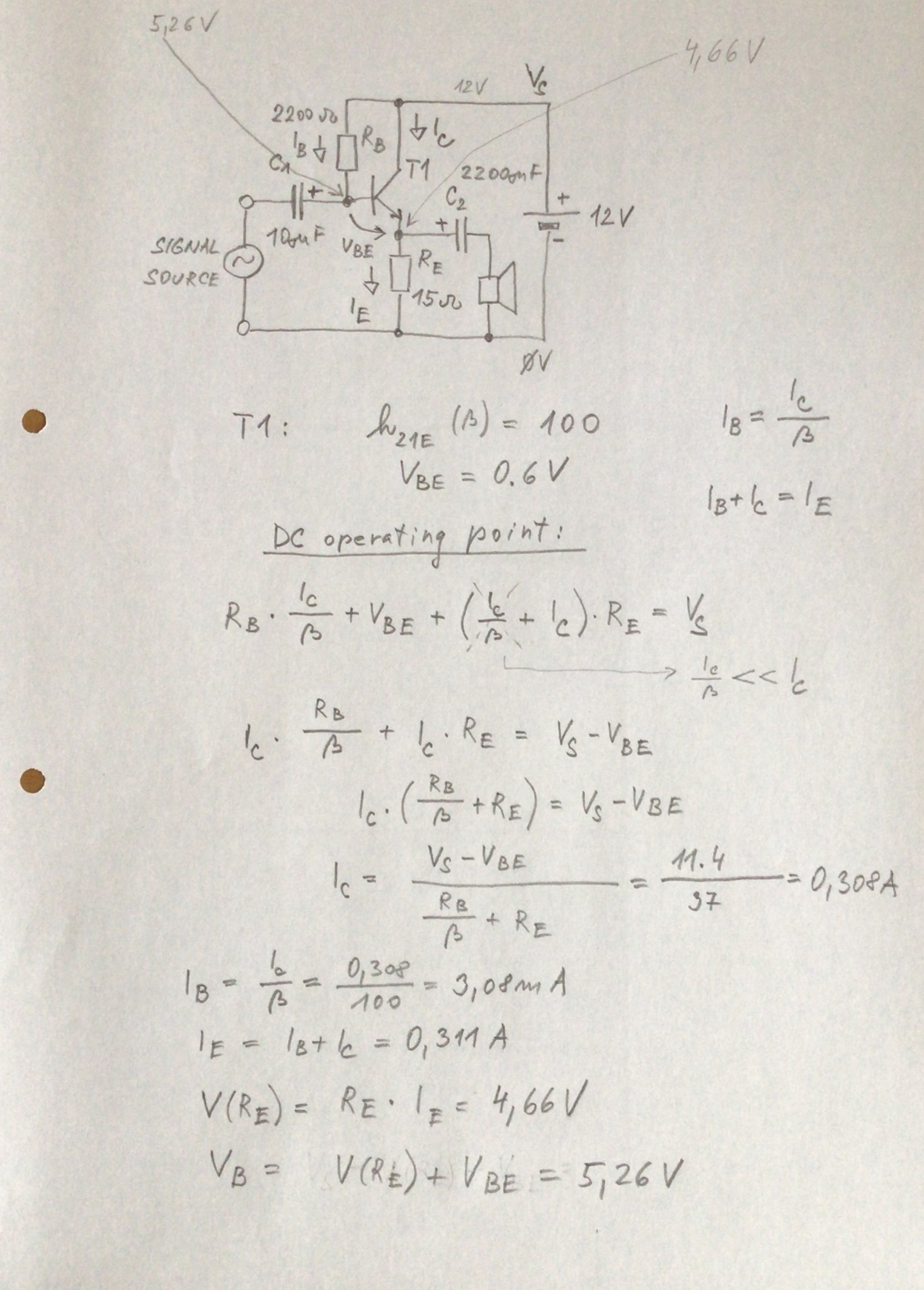

No, it is fine and the basic calculation has been already posted as equations in post #1. I also posted more equations in another thread, so I am posting it here as well. Please change resistor numbers according to post #1, it is really trivial. Also npn/pnp and polarity of capacitors and battery.Hello PMA,

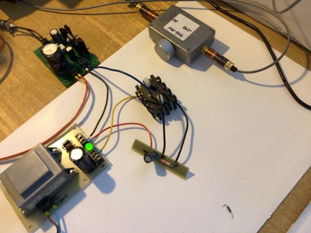

I have just built a second sample (we are always talking about #1 schematics) and it is crazy, the second Sanken 2SA1102 has Beta = 151 !! So the sample idle current was about 780 mA, too much, the emitter resistor temperature was going to high. So I increased the base biasing resistor from 1k to 1k8, now getting 600mA idle current. I will test it this way.

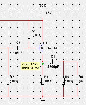

Here is my version of @PMA circuit.
I had to select more than 500mA bias to achieve 0.3Watt less than 1% THD.
In such case, measurement on a real circuit is more valid than the simulated result. Think it over, if even in case of such a simple circuit there are some differences, how would it be in case of much more complex amplifier?? Do you still think that simulation models are accurate enough to tell you truth? Sometimes the result is too optimistic, sometimes a bit pesimistic. Simulation is only a first step in creating an amplifier project.
This is a comparison of built samples of the Simplest amplifier. 2 different pieces of 2SA1102 transistors, btw, after investigation of case labelling, one of them (the one with low Beta) seems to be an unoriginal copy from who knows who producer. All the info is in the graph. And, this is not a simulation, this is the measurement!!
