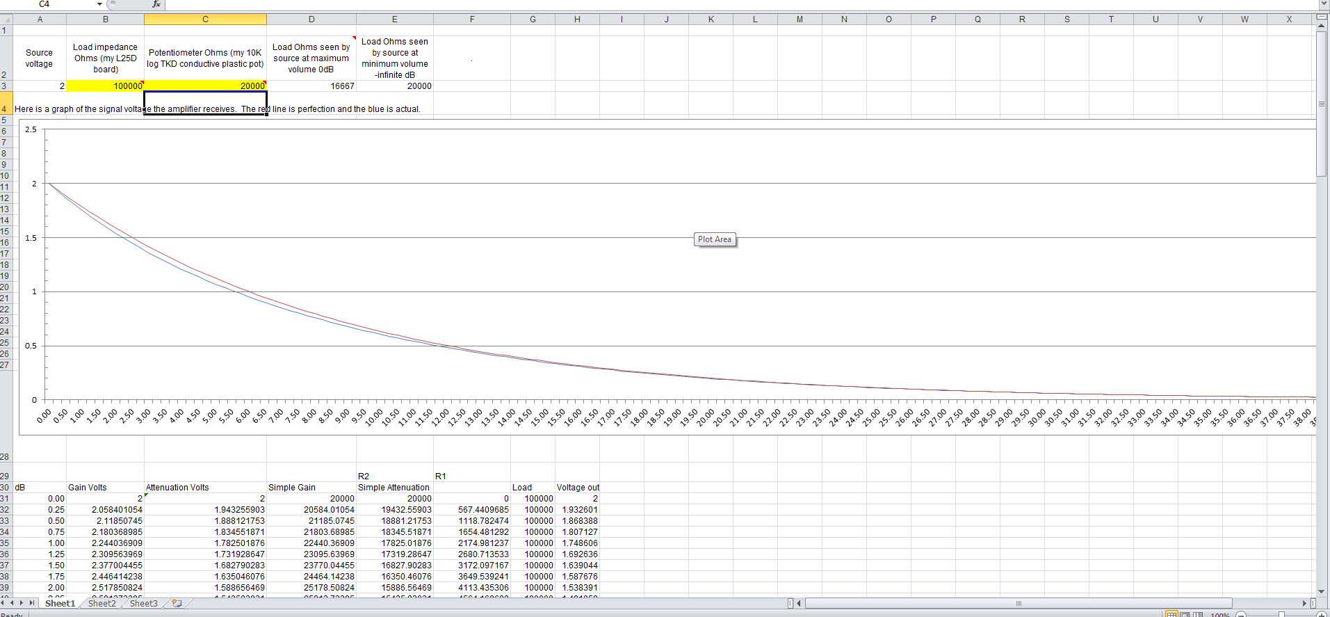

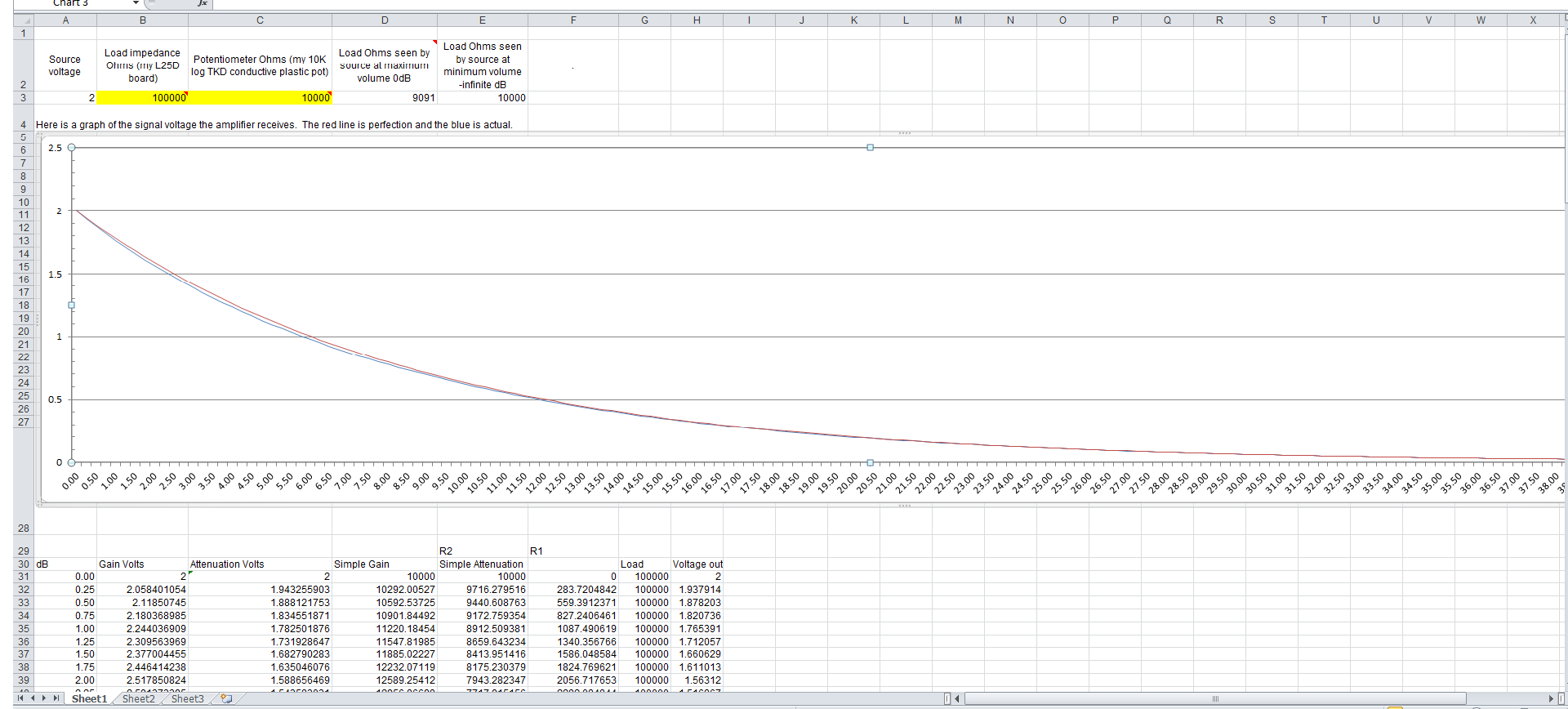

I used the excel sheet provided by Dechrlam. (Thank you!!)🙂
when I use 10K pot the load impedance seen by the source varies between 9K -10K at maximum and minimum volume respectively, with a smooth plot slope matching close to ideal.
When I go to 20Kpot load impedance seen by the source is between 16K-20K at maximum and minimum volume respectively with slightly more steep plot but still not bad.
Now out put impedance of my source is 560 Ohm and using 2V out.
I am inclined to go with 10K pot as even by general rule it is way above 1:10 rule (560:9000 ,source and pot and 9000:100,000 for pot and amp).Or should I go with 20K? my interconnect capacitance is less than 140pF
Please give me your opinion.

the source output impedance to receiver input impedance ratio is different for the two vol pot values, 10k & 20k
That's why the range of input impedance is different.
Had you halved the receiver impedance when modelling the 10k vol pot you would have found that the range (as a proportion) of input impedance would have been the same.
In general you need a receiver:source impedance >5:1 and preferably >10:1
A 10k vol pot with a maximum output impedance of 2k5 would suit any Receiver with an input impedance >7k5, but work equally well @ 15k, or even 30k for Zin.

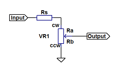

From the attached diagram:
Rs is source resistance, probably 0-100R
VR1 is pot resistance. Ra is upper resistance, Rb is lower resistance (so Ra+Rb=VR1).
From the output, looking leftwards, the source resistance Rt (resistance to ground) is:
Rt = (Rs+Ra)//Rb
Rt = (Rb*(Ra + Rs))/(Ra+Rb+Rs)
This can be thrown into Excel or Calc to explore. As an example, if Rs=100R and VR1=10k:
1) at max volume, Ra=0, Rb=10k and Rt=~99R (not quite 100R as Rs is in parallel with Ra+Rb)
2) at min volume, Rt=0 (as wiper is grounded)
3) Rt(max) occurs when Ra+Rs=Rb, i.e. Ra+Rs/2=Rb, i.e. Ra=4950 and Rb=5050. Rt(max)=2525
If the lead connecting the pot wiper to the load has a capacitance C to ground of 140pF, then a low pass filter is created with a -3dB point Fr(-3dB) of:
Fr(-3dB) = 1/(2*Pi*Rt*C) = ~450kHz
Unless you are entertaining alien bats with a gas discharge tweeter imported from Cygnus A, then this really is nothing to worry about.

Could not figure out this part. Why Rs/2?
This is because the max resistance to ground Rt as seen by the load occurs when the two parallel resistances are equal in value. Using the figures from post #31, the combined resistance of Rs and VR1 is 10k + 100 = 10100. Half of this is 5050, i.e. half of VR1 plus half of Rs.
If there are two resistances in parallel, each of 5050, then their combined resistance is 2525. Note that this is the same as Andrew's post above to the effect that the maximum Rt seen by the load equals the pot resistance (10k) plus the source resistance (100) divided by four.
If Rs=0 then Rt simply becomes (VR1/2) // (VR1/2) ("//" means in parallel with). Rt now equals 2500.
It might be conceptually easier to lump Rs and VR1 together, so if Rs=100 and VR1=10k, look at them as a 10100 ohm potentiometer. Once again, Rt = (10100/2) // (10100/2) = 2525.
As you move the wiper away from the arithmetric mid-point, so that the two parallel resistances are not equal, Rs decreases. For example, if Rs+Ra=5080 then Rb=5020 and Rt=2524.91, less than the maximum of 2525.
I hope this clarifies things!
