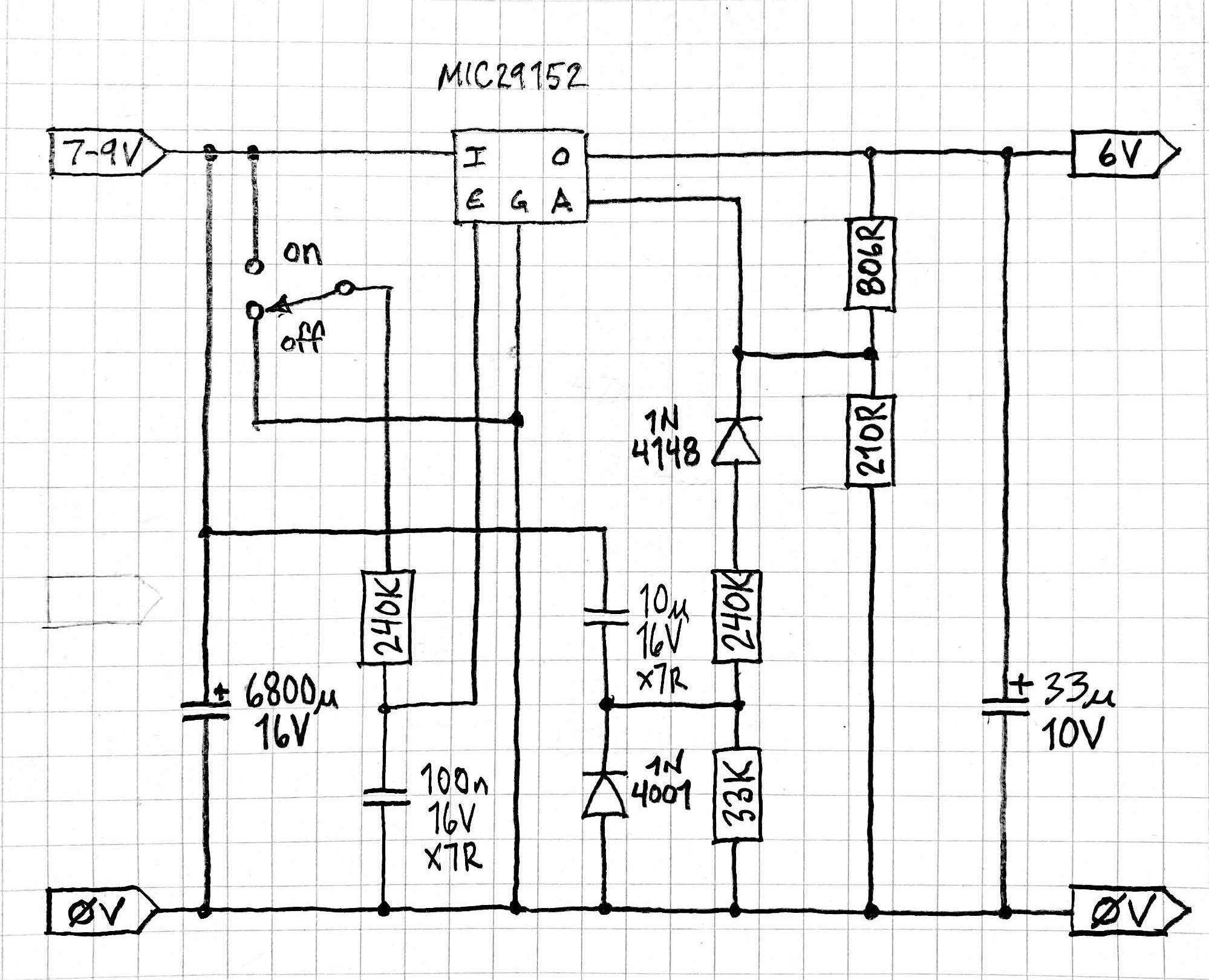

These circuits date back to the late ‘90s (below). There are plenty of SMT LDOs with soft start features but I’m not seeing anything in TO-220. I am angling towards using the MIC29152 or MIC2941A for 6V / 750mA, which encompasses two 6922 heaters and some 5V relays running at 4.3V downstream. I’m looking to avoid heavy inrush current. I’m not trying to ramp power over a long interval - even 1 second is more than enough.
In my application power will already be applied, and I am thinking of having a simple SPST “On” switch that toggles the EN pin from ground to open (with the R4/C1 node connected regardless). Is there a snazzier way to accomplish A) the soft start, and B) the turn on, or should I just copy what’s drawn in the ancient Micrel white paper (with R1/R2 corrected of course)? The TI version is almost the same but for an added cap across the upper R in the ADJ network, and the designer assumes an enable voltage separate from the input voltage, which is not the case in my application.
I didn’t bother including the classic LM317 soft start diagram because it has no enable pin.
