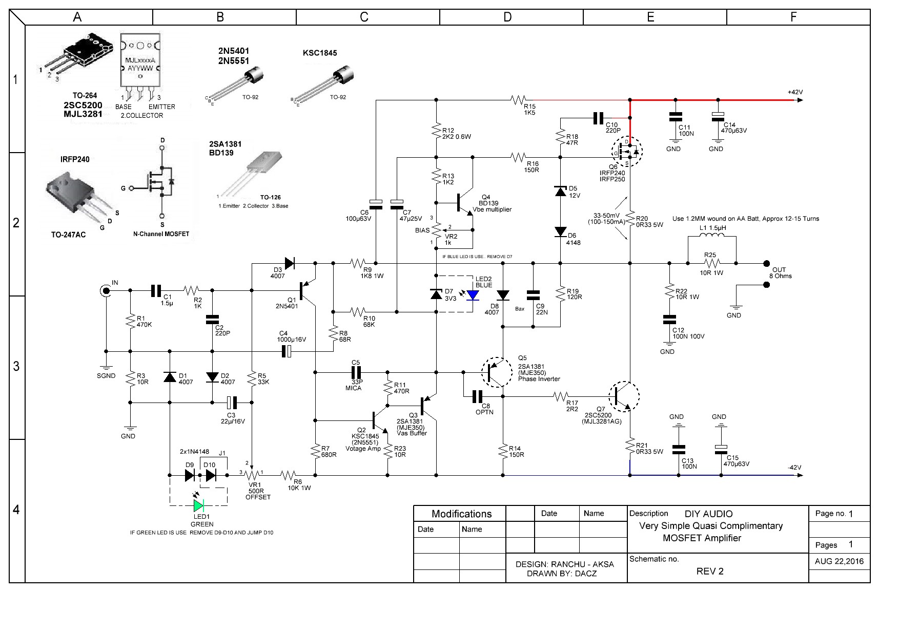

After the issues with my LM3886 (solved in the meantime) I started thinking about a small discrete power amp that is suitable for active speakers. I made the list of what I'd like:
- all discrete, no IC's
- about 10-20W in 8 Ohm, should be plenty for active speakers in a living room
- "good enough", let's say 0.05% distortion or so over power and bandwidth
- stable with enough margin to make it foolproof
- easy to find current components. No matched pairs, ring-emitters, IGBT's or exotic values for resistors or capacitors. Somehow I prefer BJT over FET.
- working from a dual voltage supply
- cheap enough to be an alternative for a chip amp. I will probably be more expensive but it shouldn't be 10x more expensive.
So not the ultimate amp in terms of performance. Does not need to have the least components but let's say the minimum for good function.
The closest I could find is the JLH. The class A working makes it a bit problematic for active speakers. But maybe there is something more recent in class AB around. I have been out of it so long that I probably missed a lot.
You could have a look at all the simpler class-AB amps out there with like 3 stages or so.
Digi-125 is as simple as it gets, or Baby Aksa, Rod Elliots P3 etcpp.
All of these can be downscaled via smaller rail voltages with minor adjustments.

I´m using LM3886 for my active setup and am quite happy with them but will try a Baby Aksa soon for which I have done a layout.
If it works I could even part with some PCBs if you´re interested.
That said, I would argue that there is no completely discrete amplifier that is 100% foolproof.
Maybe some single-ended class-a design with an output capacitor would come close but that isn´t very practical.
If foolproof is your priority I´d stick with the LM3886 and use a proven PCB-design/-kit.

Apex designs are great for discrete low count. Check out the directory and keep going until you hit the max number of actives you can handle. My experience with the Apex FH9 *hexfet variant of FX8* is that it is super sounding, easy to build, low cost, and can be assembled in an hour with $7 in parts if you cheap it out with no-name Chinese parts and $23 with name brand parts from Mouser.
A Directory of Apex Audio Amplifiers
There is also the DX amp by Carlos:
Destroyer x Amplifier...Dx amp...my amplifier
I have built it and it sounds really nice too.

This one is also tempting.
It´s small, it´s a diamond, available parts and some iterations even get by without a heatsink. And SuzyJ is really making some beautiful layouts. What´s not to like?:
Cascading diamond buffers - a cheap low THD 10W amp with TIP41C
