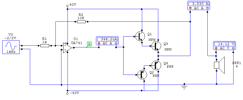

I made this circuit. Is it realy can give 50W at 2V@4ohms in input ?
you just blew up your 741 putting 80v across it.
you have to limit the Vrail to the same voltage as your opamp requirements.
OR use a voltage amplifier between the opamp and the output stage.
That one by Amplifier guru does that, even though I still can't understand it.

I put the 741 only to reference. It is a hypotetic Op Amp

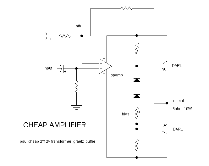

Not much more complicated, very adaptable (I've used it with IRF devices). I also made a version using 2 green LEDs in place of the Vbe multiplier. No Global Feedback, only local. I would add Gate stopper resistors tho. Especially with lateral Mosfets. If the Output seems to be too hot for what its doing, then its oscillating and the gate stoppers will stop this. SK1058/SJ162 seem to need higer values for the stoppers. 220 should be fine for IRF Devices and 470 for SK1529/SJ200 seems OK. The Cap between the Opamp and the Output is probably not necessary, just a little protection.

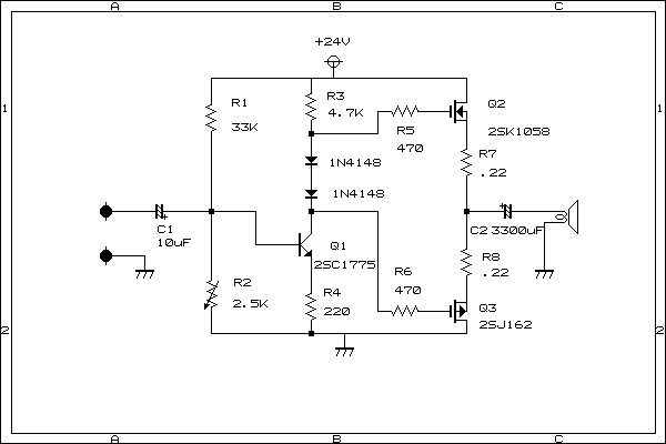

Here's a bare bones Basic AB circuit. R2 sets the bias for the amp and should be set so that 1/2 the supply voltage (~12V) is seen between the + side of C2 and Ground.
No Global Feedback and 2V should send it to clipping. Will post Distortion Spectrum Later.
1V in will swing about 13Vpp. I figgure that is about 20W into 8Ohms with a 1K source impeadance.
C1's polarity is reversed. sorry.

your calculator needs new batteries.
13Vpp is 2.6W into 8R
10.5Vpk is 6.9W into 8R.
Is that a typo 2sj163?
can this amp really swing to within 1.5v of the rails with that drive circuit?

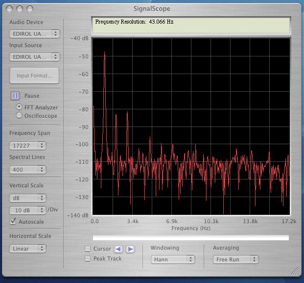

Dozuki said:I did some real measurements on the above amp:
1000 Hz sine input at .66v (1v out of source unloaded)
Unloaded output of amp : 12.7V
Output with 8 Ohm speaker: 10.5V
13 Watts output
Distortion Spectrum in db with 8 Ohm speaker load:

2.6W and 6.9W RMS, yes (although 13 Vpp would be 10.6W RMS). I guess I should have clearified that I was measuring Peak Voltages and Peak Power, not RMS.
I=E/R and W=I*E in which case
10.5e/8r=1.3125i, 1.3125i*10.5e=13.78 Watts Peak to Peak
Yes, that's a typo, should be 2sj162
And since I was measuring Peak to Peak, the amp stays within 5 volts of the positive rail and 5 volts of ground with about .66v input.
What program did u use to made this measurements ?
An Oscilloscope that shows voltages
and Signal Scope for the distortion specs.
With the circuit built on a breadboard.
Edited Schematic, and input cap is correct:
