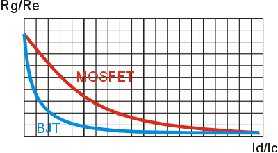

The below curve shows why many constructors turn to BJT's for good linearity in the output stage, and not Mosfet.
The Linear region of operation starts when the output impedance becomes roughly independent of the load current. In this region the output stage doesn't contribute with any significant distortion.
On the curve this corresponds to a flat horizontall line.
As you can see you only have to run the Ic current at a certain level (depending on the transistor type 70 - 500 mA) to get a Ic independent output impedance.
However in the MOSFET the curve only gets completely flat at something like 5-10A, but it gets closer and closer to horizontal, the higher the Id.
This is why MOSFET's are good for Class A amplifiers, providing you keep the idle current above 5-10 Amps. But MOSFET will never get a low THD in Class A/B amplifiers. I have made bunches of MOSFET amplifiers, (like the ZETA), the good thing about MOSFET is that they are very easy to work with, don't require a lot of gate drive, are rugged, easy to come by and dirt cheap. But they will never be the ultimate output device for high quality amplifiers.
(Well maybe except for Class D of course 😀)
On a more academic level, there is nothing that prevents you from building a Pass amplifier using BJT's instead of MOSFET. Of course it's no longer a Pass Amp, but it should work with no significant complications. I recommend a good BJT from SANKEN 2SC2922. It should fill in nicely for the IRF's, and for idle currents below 5 Ampere is bound to give you a better result than MOSFET.

pass with bjt's
I understand from previous discussions that just replicating the Pass circuit with BJT's (take for example the mini-aleph, a 2-stage design) is not so easy. One small transistor will not drive a bjt power stage to reasonable levels. Would it be possible to have the circuit here on the forum with some values and numbers, better still with some measured or simulated data? I guess a great deal of diy'ers are interested!
