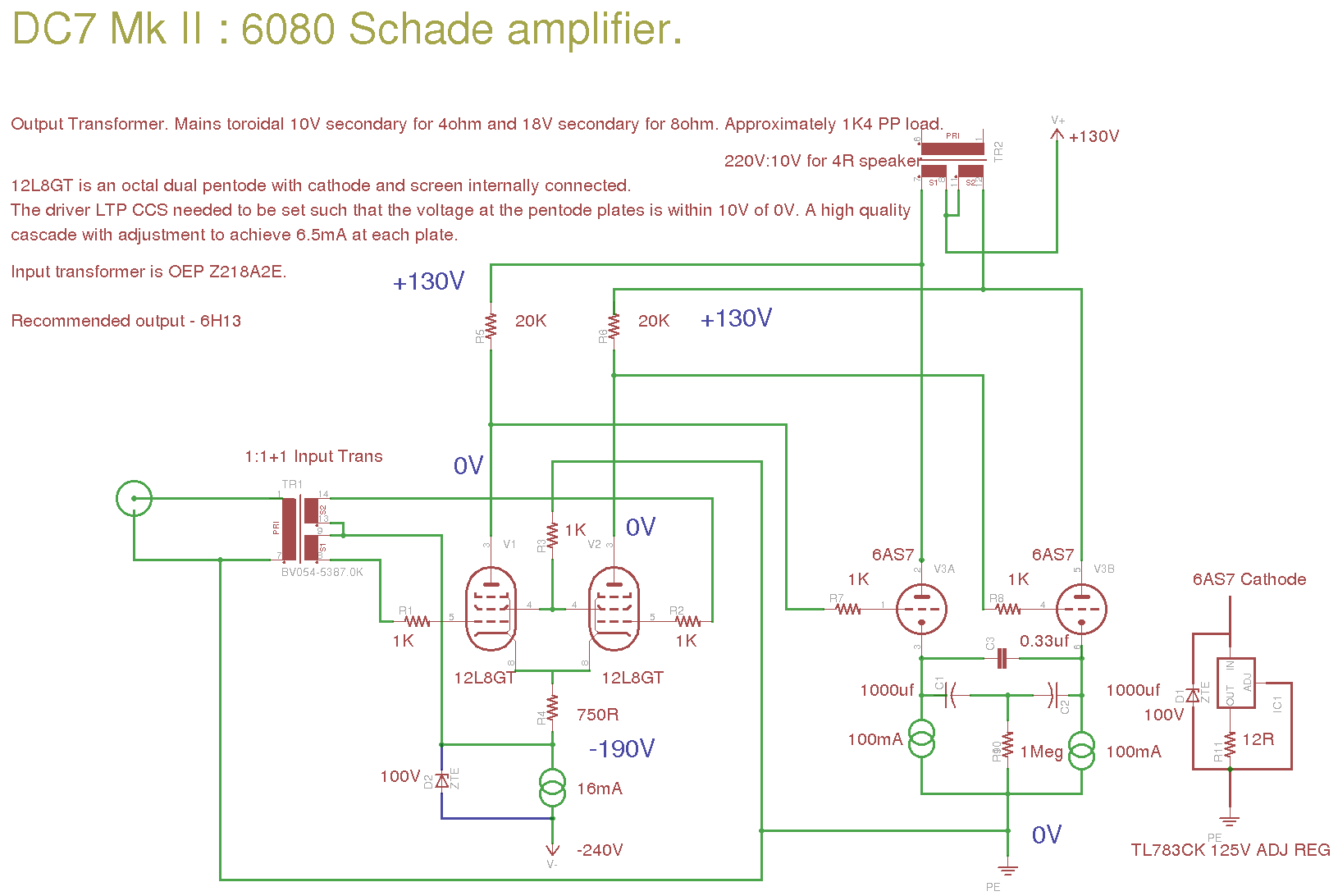

I'm hoping to use a 3A5 (4.5 mA x 2), or two of them, in place of the 6922 (12 mA x 2) in a van Waarde 6as7 SE headphone amp. I thought maybe I could get away with it because a headphone amp only has to crank maybe 150 mW. Does this sound reasonable? I'm assuming the preamp tube has to have the current drive to charge and push past this Miller capacitance?

That still represents a very high output impedance and hence a very poor damping factor, expect very sloppy bass. Mains toroidals can be got of E-bay for small money.

A mains toroidal in a push pull arrangement will match or outperform almost all commercial OT. They work very well if you make certain there is almost no DC in the transformer (less than 2mA) and that the output pair have a fairly low output impedance. I have used Schaded 807 PP outputs without issue at 6K PP load.
Interwinding capacitance can be high, but polarity of the Primary side can avoid big issues (one direction is likely to ring producing core saturation which creates a drop off at low frequencies and a peaky response at high, the other direction will be much better).
Thats all you need to know to make it work.

Many thanks; I am used to using current sinks in double ended circuits so the DC issue should be capable of being solved(if I AC couple the cathodes). Your reply has given me confidence to finish this one off-great. Also,regards to the Emerald Isle-I come from Belfast originally.

Look at my circuit in post 19 for how to address the DC and AC issues. This is my standard cathode arrangement on all my amps, it sounds great and has never let me down. I also used a Garter bias on one but that wastes a bit more voltage.

I built that amp and it sounded fabulous, but it did have roll off issues with the toroidal phase splitter. It pushes 30mA into the phase splitter and still starts to roll off noticably at about 50kHz. My latest version is direct coupled with a phase splitter transformer at the front end. This makes the transformer a lot more affordable and better performing. See attachment. I have used a toroidal phase splitter as an input transformer where the grid load is reduced, but the times I did it I had gain to burn so stepped down by about 4:1 which improves things no end. Tube gain is cheap - decent phase splitting transformer are not, so its well worth the effort.
