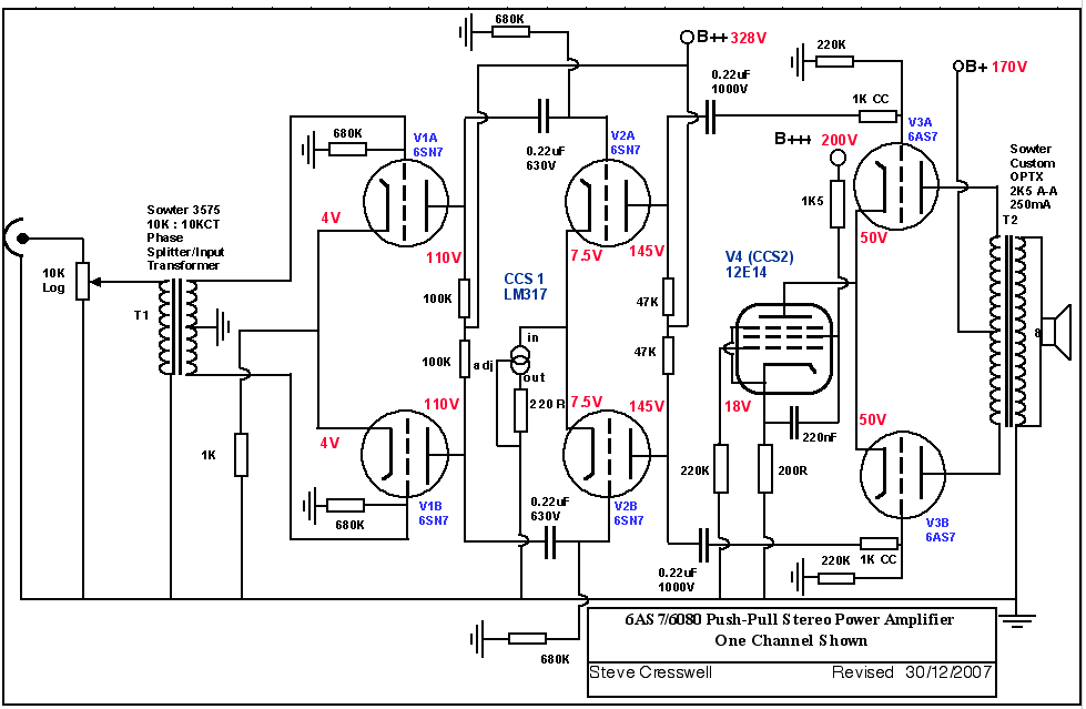

Hi Alex
A 6AS7 or 6080 pp is a superb sounding amp. I've attached a schematic of my own take on the 6AS7 pp idea.
I use low current drive in my amp and love the sound it makes. Others might prefer higher current drivers but either way the 6AS7 can be made into a stunning sounding push-pull amp.
Mine uses differential amps with constant current sinks in the tails of both the driver and power stages. The driver uses a simple LM317 as a sink with an STC 12E14 regulator tetrode as the sink for the output stage.
It is a work-in-progress and I'm thinking about reducing the number of stages to 2 by putting a 6SL7 or similar as a driver and removing the first stage. By doing this I'm trying to take full advantage of the low Miller capacitance of the 6AS7 by using a high gain low current driver. That's for the new year.
As it is though the amp sounds simply beautiful.
On another thread Shoog has done the opposite to me and used high currents and interstage transformer coupling. Also, his constant current sinking arrangements are a bit more sophisticated than mine.
Both approaches are equally valid and will produce an amp that sounds superb. I can guarantee you won't be disappointed whichever option you choose.
Steve.

Hi Steve,
Forgot to mention, am driving my 6080 parafeed with a 12at7, the 12at7 cannot drive the 6080 into full power. I have a 5670 preamp with a lot of gain, paired with the 12at7/6080 parafeed, then I am getting decent power.
Am thinking of doing the 6080 PP using a 6n1p or 5670 driver into a center tapped choke phase inverter (just like the Seth Amplifier of Jean-Francois Lessard, which I have tried on a PP 832A with excellent result) then into 6n1p voltage amp, then into the 6080. B+ for the 6n1p at 400VDC and B+ for the 6080 180 to 250VDC.
This might give me enough voltage swing on the first two stages to drive the 6080 to produce adequate power.

There is around 50mA going through each triode section plus around 35mA set aside for the sink.
The 12E14 sink is pulling approx 135mA to ground.
50mA per triode might not seem much for a 6AS7 to be passing, but as I said, this is a deliberately low current design, which I like the sound of.
Halving the cathode resistor on the sink will of course double the current passing through the 6AS7s and gives a more forward sound. This setting for the output tubes is more suited to commercial speakers. The low curent setting suits my Fostex driven Metronomes better.
Steve
