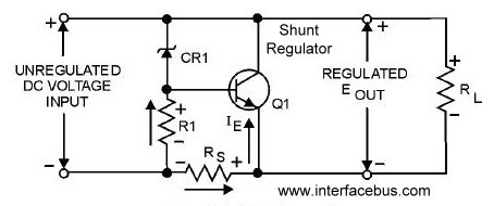

A shunt regulator can be a limiter. Here's one example:
If the input voltage is below Vz+Vbe you get the input voltage across RL. Once the input voltage exceeds Vz+Vbe Q1 will conduct and limit the voltage across the load. I would add a resistor in series with the base to limit the base current.
Tom
That may be a solution, but it looks like none of these will work at the millivolt level.

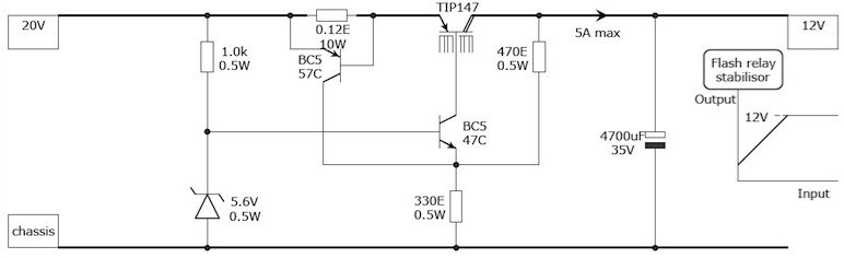

I've made a 12V voltage regulator for my motor bike years ago with such a function. The led turnlights went beserk above 12.6V but in stationairy the battery (a very large cap actually) was only a 8V, which was ok for the leds.What I am looking for is something that will accept a range of voltage, that can be 0V up to some maximum value, where it will allow the voltage below the max value to pass-thru as-is, but when the max value is reached it will not pass more than the maximum. Another way to say it is the circuit should do nothing until the set voltage limit is reached, at which point it then limits the voltage to the limit and continues to allow current to pass thru.
So the idea is not strange, even possible, but it requires neccessary definitions, environmental borders, specifications and a formal goal to achieve.
It would be ideal if your 'set voltage limit' is 'sliding along with the input signal' to get an expanded limiting range well over the commonly used circuits. Just as if the 5.6V zener in the attached picture of the Autodrop regulator is not really fixed (an 'anchored' reference), but is altered dynamicly by the outward circumstances.
Doable! I still doubt passive only.
