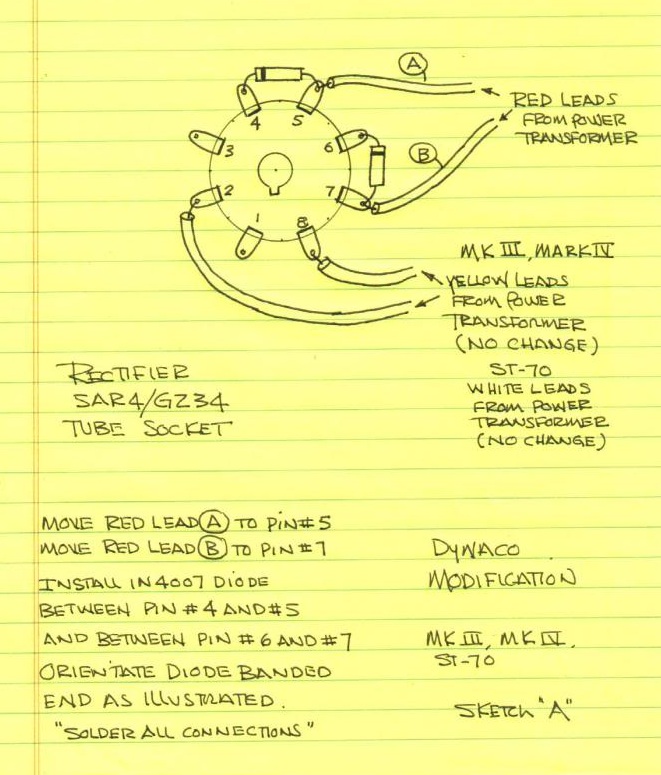

Just like on the above diagram on post #6 : Pins #5 & 7 are unused ones so can be used like terminal strips on P2P amps.
I would say the correct free end of the diode would have to be the banded end if you look at the diagram and Simple SE schematic.

Thanks for the reply. But I was referring to Tubelab's comment for wiring it into the SSE.
In that case as I understand he's suggesting not wiring the diode to the unused pin. But rather one end of the diode is on the transformer's wire, the other end gets screwed into the SSE transformer connection to the board.
So in that case, my question is, does the band on the diode go towards the transformer, or the transformer connection to the board?
If you trace the diagram schematic that gives you the correct answer which is the banded ends always goes to the tube rectifier so in the SSE the diode banded end at the PCB terminal strip won't let out any smoke.
So as you worded it "the transformer connection to the board? " is correct!
If you have an SSE board purchased in the past two years the diodes are already on the PC board. These are the two small (1N4007 size) diodes added near the rectifier tube.
If you are adding the diodes to an existing build or building up an old board, then yes, the banded end of the diode gets stuck in the connector on the board and the other end gets soldered to the red (on a Hammond or other transformer that uses standard colors) transformer wires.
