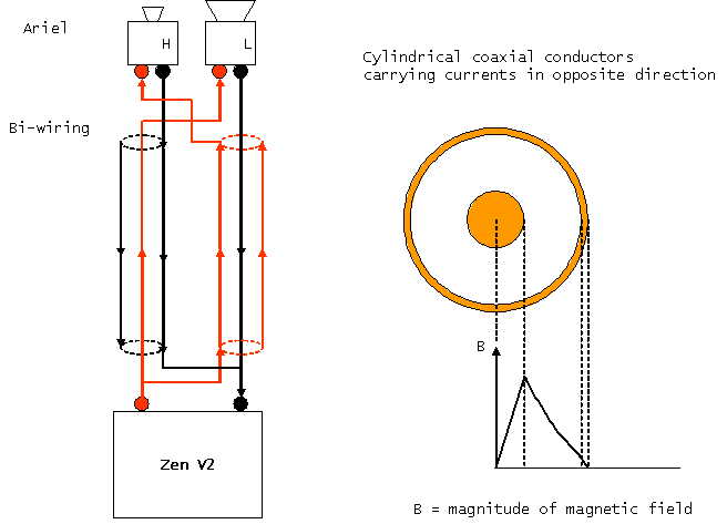

Nevertheless, to pursuit the most by making Zen V2 simpler, I¡¯m considering what to do. For example, I removed R3 and use variations of R2 between 1.5K and 4.7K. Now, I¡¯m about to remove R13 and 14. Nelson Pass articles imply that those are to measure ac currents. Do you have the answer? Is removal of the R13 and 14 acceptable technically? Yes, no, yes, maybe?
By the way, I use cylindrical coaxial cables (bi-wiring) between Zen V2 and Ariel speaker as shown in the attachment. Could I share your experience on DIY cables between Zen V2 and your speaker?
Thanks.

If you remove R3, you can make R2 any value you
like.
If you remove R13 and R14, then you revert to the
earlier constant current source, and you might as well
also remove R15 and C6 also.
All this will work just fine.

Understood. Many thanks, Mr Nelson Pass. Your information on the free choice of R2 clears fog.
I will keep Zen V2.

Please help me. I often use a passive attenuator between music sources and Zen V2. Regarding this, DACT recommends in their web site that the passive attenuator is better with low value but minimum 10K. This is my concern. I use a 3.2K attenuator, luckily without realising any problem. For Zen V2, actually what to be recommended mimum and maximum values? Anyone knows?

PS. The above diagram about magnet field is from the book: R T Weidner, PHYSICS revised version, Allyn and Bacon, Inc. 1985.

?...... ahA. 10K is nothing but one of working sizes.
?...... oK. I presume that 3.2K to 25K will work fine.
?...... Yes, the interconnect line to be as short as possible.
?...... I mean the line from the attenuator to Zen V2.
