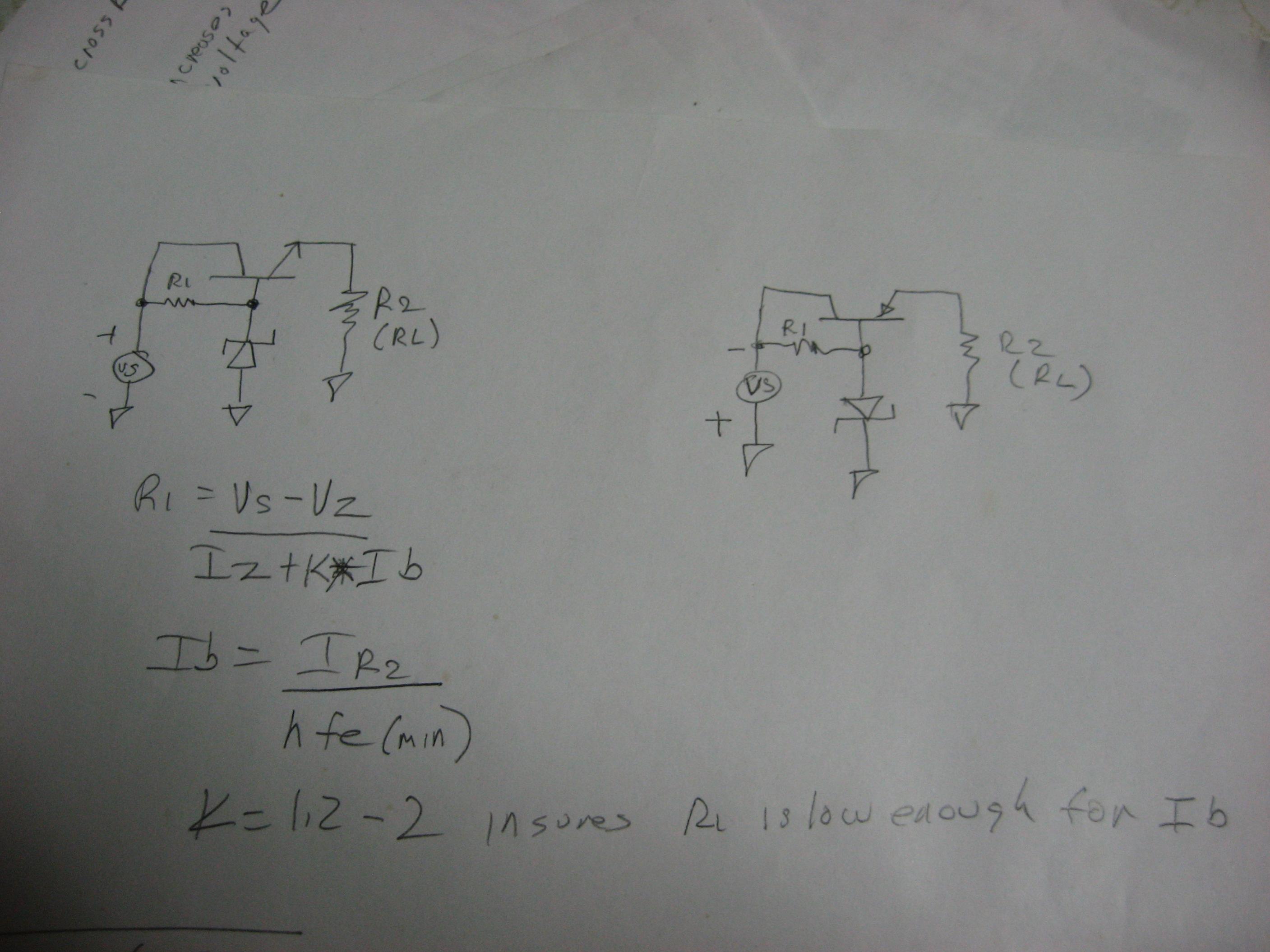

In the above power amp example, the zener is used to set the current, not the other way round using a current source to support a zener, Eg like using a current source instead of R4. I wouldn't doubt 1/hoe is easily ~ 1M for a lightly biased signal transistor. I picked 50K as the worst case of an ole cheap power transistor, the value is a merely a 'stake in the ground'. I reckon any good college text for microelectronics using a Hyprid Pi model will show how to derive it from the 'family of curves' or the early voltage. Basically hoe is not a controlled parameter, and for power supply stuff it's almost always ignored E.g "It's somewhere way up there" not so much for a common emitter gain stage it often sets the max gain. iN any case the goal of using a current source in most any circuit is to approach an ideal current source , a stable value w/ high impedance.
Emitter degeneration is used to lessen the dependence on both Vbe and hfe variations in a circuit (AC + DC feedback), it has zero effect on 1/hoe for a given Ib.

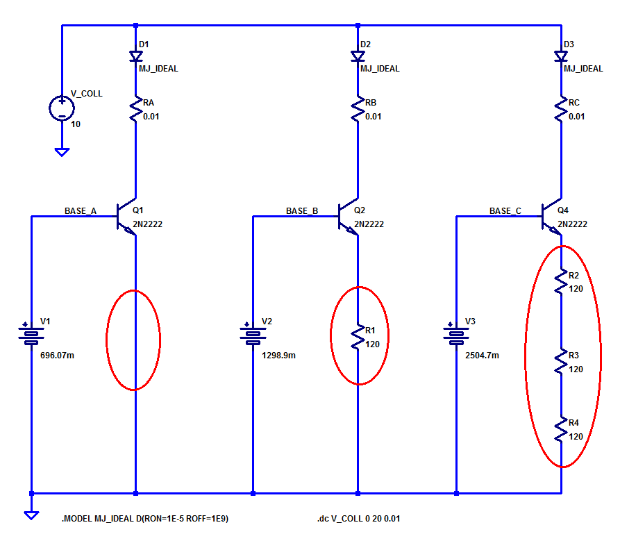

Here are three current source circuits with three different values of emitter degeneration resistance: 0 ohms, 120 ohms, and 360 ohms; please see the red ovals in Figure 1 below.

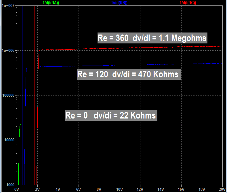

When we sweep the collector voltage and measure the collector current, we see that each of the three circuits behaves more or less like a 5.0 milliamp current source: Figure 2 below. Current is 5 mA, more or less independent of voltage.
(Ideal diodes D1-D3 prevent unwanted "reverse current" from flowing when the collector voltage is less than the base voltage)
I asked LTSPICE to measure the output slope (the "output impedance") of the three current sources in Figure 2. LTSPICE's calculated values are displayed in Figure 3. {numerical differentiation goes bananas at low voltages (Vce < Vbe) where Iout is zero}
Figure 3 shows that adding emitter degeneration to a current source circuit, can increase its output impedance dramatically.

Thanks, interesting you chose a fixed battery to generate the base current. I don't know about your models but I would never use a transistor circuit like the 1st one.
By definition hoe stays the same. You've just added another term using Re tied onto the Hybrid Pi model. Best to find a good circuit for the application and then generate a model for it. My point being that in most cases any value of the active current source resistance (1/hoe or modified ) is gonna be a factor of 10 or more than the simple resistors case, in setting the zener current. Perhaps some emitter resistance is inherent for good stable design.

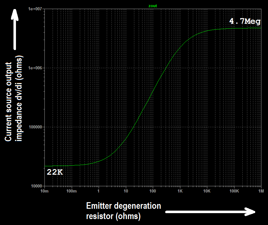

The output impedance "Zout" of a common emitter stage with emitter degeneration resistor Remitter grows smoothly and continuously, when Remitter increases from zero to infinity
It's a fun little problem, to devise a way to make LTSPICE measure and plot this. You'll get results as shown below. I used the same simulated device type (LTSPICE 2N2222) as in post #22 above.
Zout smoothly and continuously increases from 22 Kohms to 4.7 Megohms, as the emitter degeneration resistor varies from zero to infinity. The ratio of these two numbers is indeed (1+Beta) {at Vce=10, Ice=5mA}, just as pencil and paper analysis predicts.
