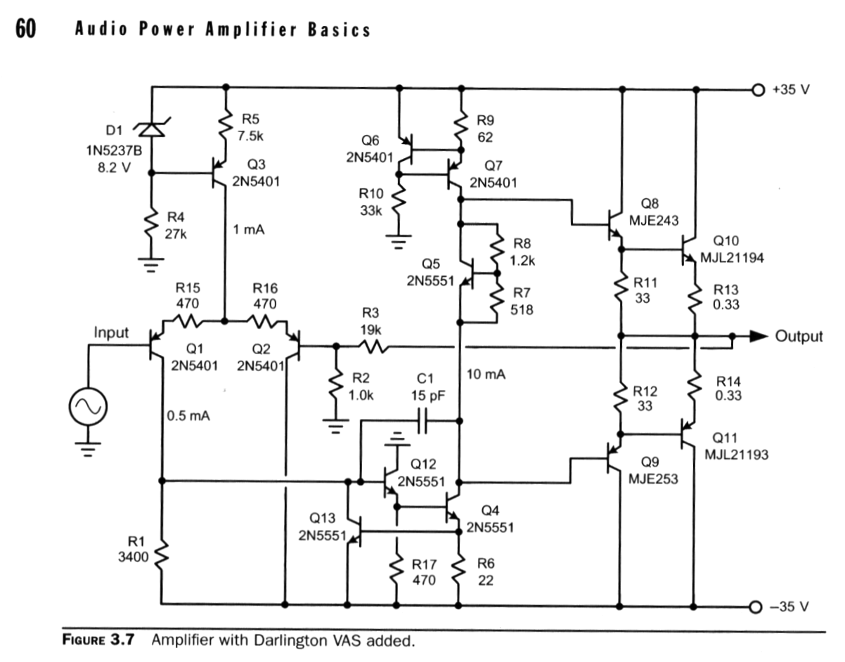

Zeners regulators can work well when supplied by a constant current source. A simple shunt using resistors and bypass caps work OK if the current is small and the raw voltage is large and clean(ish). Or the large R value approximates a current source compared to the parallel zener and bypass caps impedances. I wouldn't hesitate to use them to supply an DIY op-amp or 2 with cherry picked parts and large headroom. Otherwise 3T V regs rule for lower headroom apps.
for a zener shunt regulator the ripple attenuation is a simple voltage divider 20*LOG Rl/(Rin+Rl) in dB
Rin is the input series impedance
Rl = Rz//Xc// Rload , where Rz = dynamic zener impedance , Xc = bypass cap " , Rload = Vz / (Iload)
in the case of a real constant current source using a PNP transistor, looking into the collector, Rin ~ 1/hoe or roughly 50K ohms or more.
for a simple series resistor, Rin is ~ (Vi-Vz)/ (Iz+ Iload) note a large Rin value is better attenuation, so smaller currents and larger headroom voltages are best.

... in the case of a real constant current source using a PNP transistor {with no emitter degeneration or feedback}, looking into the collector, Rin ~ 1/hoe or roughly 50K ohms or more ...
A 2-transistor feedback current source, or a 1-transistor current source using an 8.2V zener diode and emitter degeneration resistor, can each give a current source whose output impedance is 1E6 ohms. Examples of these two current source circuits appear on page 60 of Bob Cordell's power amp book: Q6-Q7 , and Q3.
