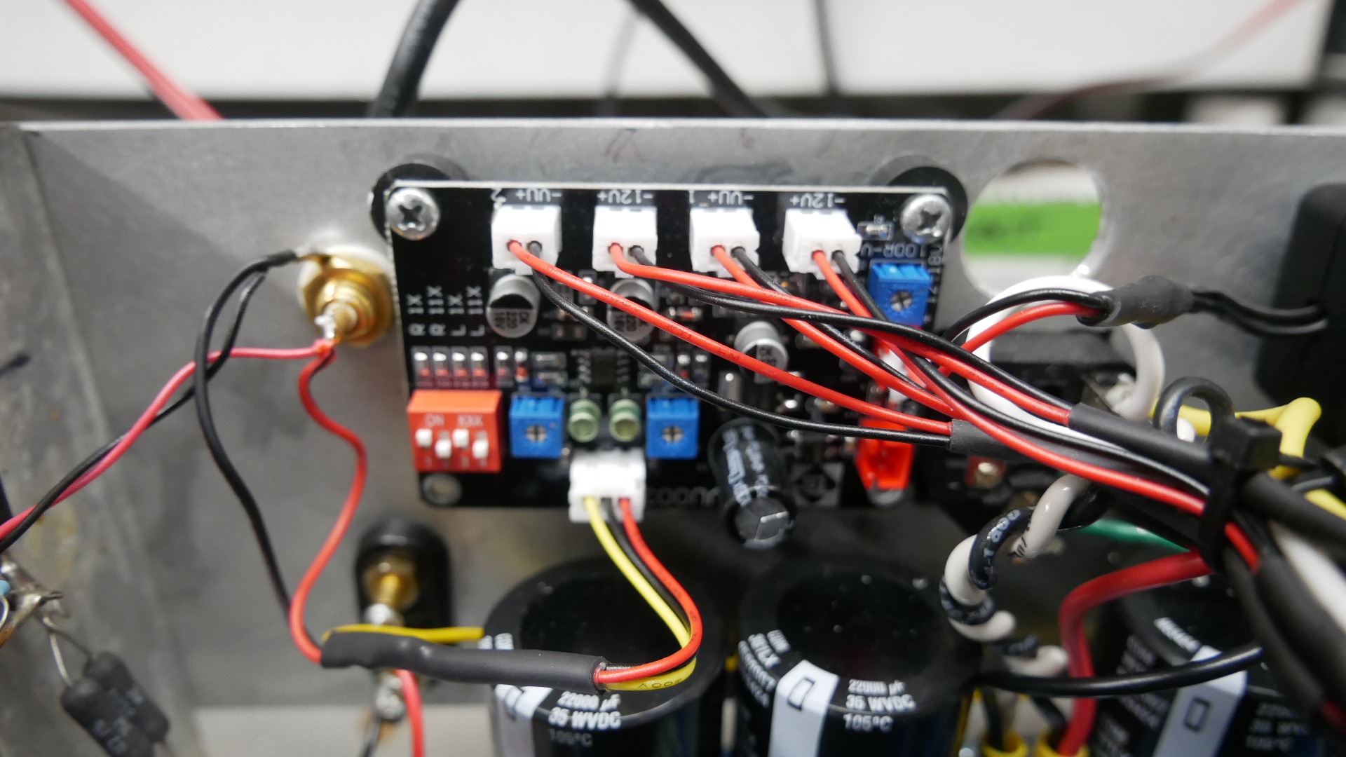

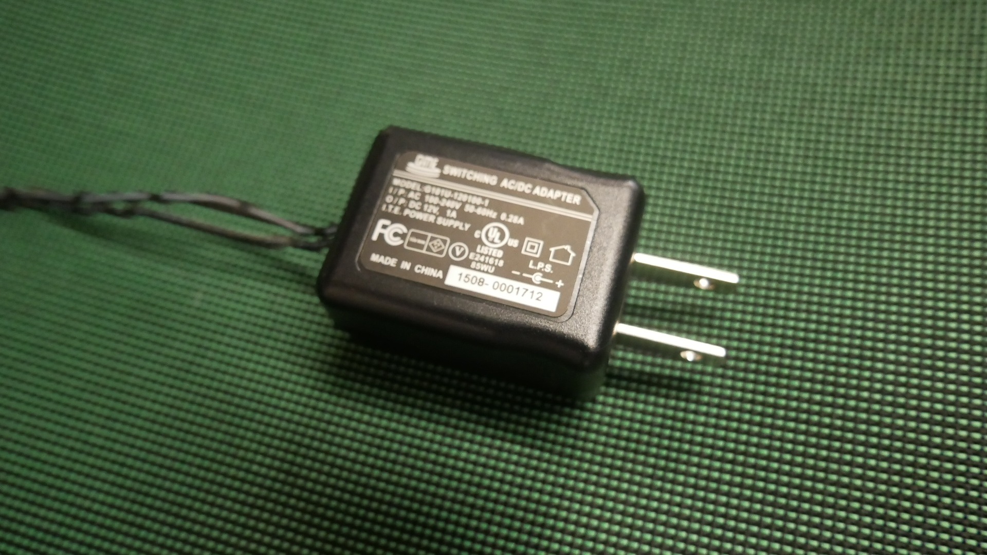

I'm adding VU meters to my First Watt F5v2. The meter drive board needs 12-18V AC or DC.
The power supply in the amplifier outputs 27.5V to the amplifier boards.
Looks like there are three ways I could power this board:

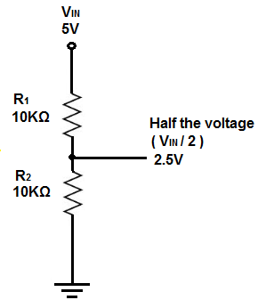

#1) Drop the 27.5V in half with a simple resistor circuit (attached)
#2) Use a small 120V to 12V transformer within the amplifier chassis
#3) Use an outboard 12V "Wall Wart" and keep all this stuff outside the chassis
What would be the best approach with the least introduction of possible noise?
Thank You

A better option:
Make a simple regulator circuit using a LM1085 (low dropout regulator) to supply your meter drive boards from the main 27.5V.
Download a copy of the datasheet from TI.com. The basic circuit is on the first page.
Edit: ZM beat me to the answer. A 7815 regulator would also work very well.

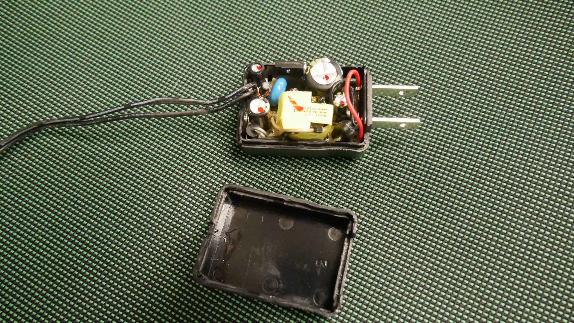

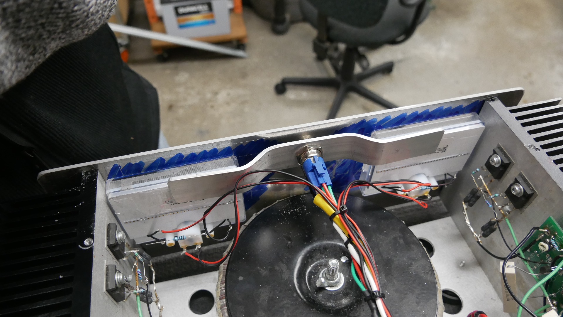

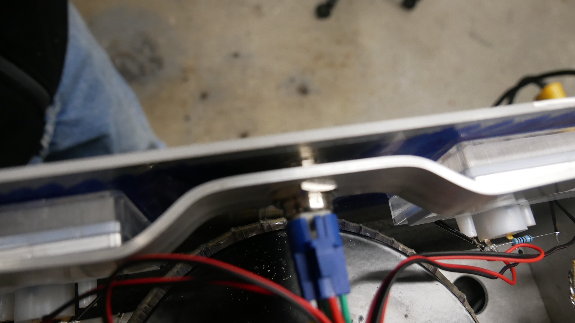

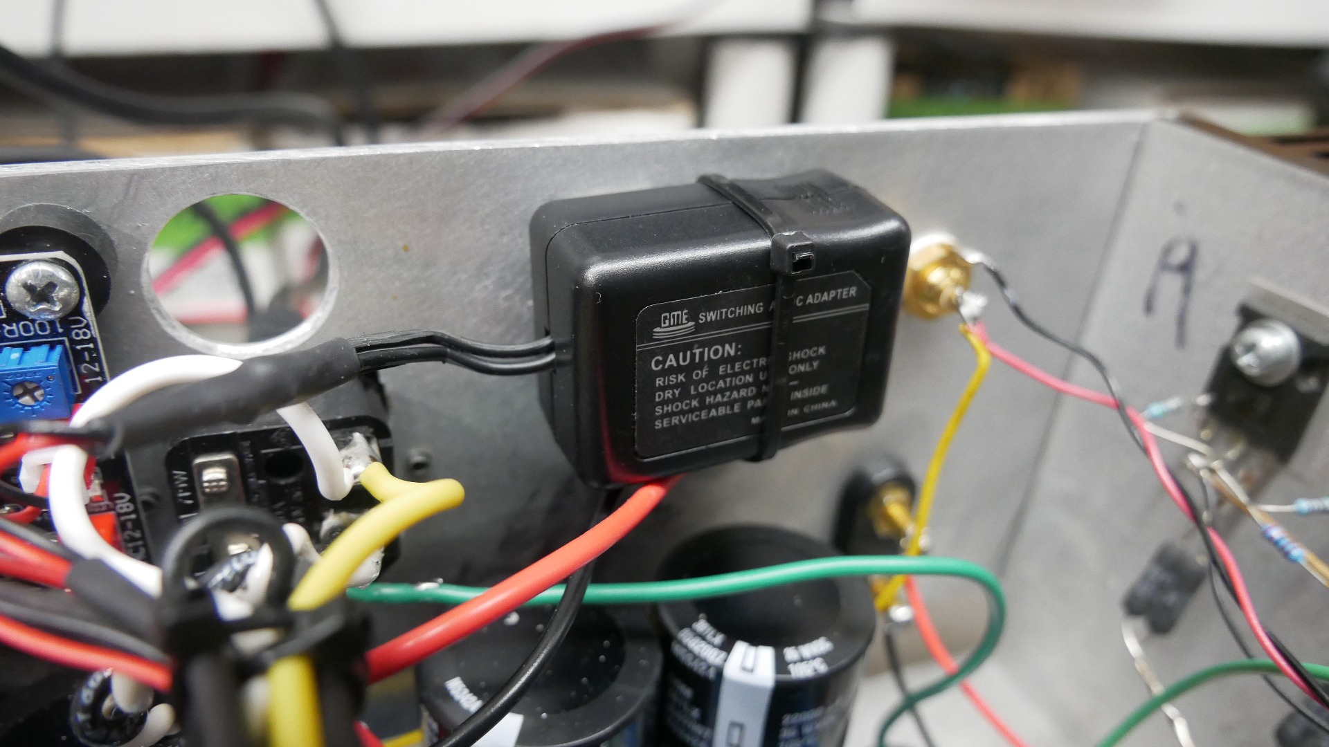

Well, I found a nice little regulated 120V to 12V DC power supply in my junk box.......As we say in Boston..."Works the Pissah!".....Absolutely no noise introduced to the amplifier. Meters are working great......
