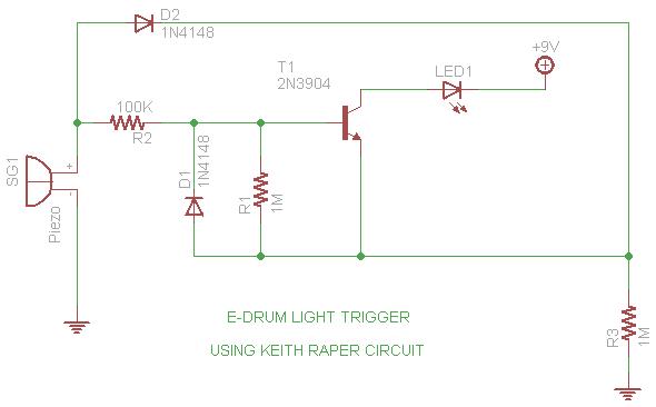

Thanks guys. I have come pretty close to what I'm after using this circuit here. I just have to figure out now how to make the LED flash much brighter.

Doesn't seem like it will work with R3. Actually most of the parts in your circuit, athough fine by themselves, don't make too much sense together. Once you fix your circuit a bit a darlington may provide the missing brighness.

Can you give me some tips on how to improve it? It actually does work pretty well, like I said except for the brightness, but I would like to learn about what I am doing instead of just using bits of different circuits I find and piecing them together. Should I get rid of R3?

Use Ohm's law and do the math. I=U/R.
How much current can flow through a 1M resistor, when you have 9 V? Compare that to the forward current of your LED.
If you look at the article you will see that you forgot a GND connection at the transistors lower leg. D2 and R3 are left over from an OR circuit that you only need, if you want two or more transducers to switch the same LED. Use the second schematic from the article, i. e. delete D2 and replace R3 with a jumper.
The LED is drawn the wrong way round in your schematic. The arrow shows the current flow, which is from + to -.
Now that I can understand!😀 Thank you very much Pacificblue. That is a very helpful answer that I learned from and got some very useful info!!! I really appreciate your time in looking at this for me.
I will let you know how it works out.

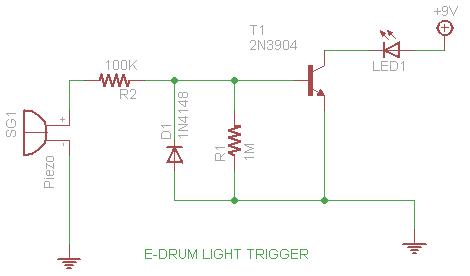

Here is the updated schematic. much easier actually!😀

Thank you analog, I will definitely take that into consideration. I don't know the purpose of those components. They were in the original schematic that I got the switch idea from. I was just guessing that they somehow affected the sensitivity, but I really don't know. This is another idea I got from someone on another forum that I am going to try also. Schematic
R2 - bias point? You mean it limits the input voltage so as not to overbias the transistor? 🙂 Protective function? How much EMF can a piezo possibly generate? If anything needs protection it's the poor led when a real man hits the drum.
Actually there is no 100k resistor in series with the input in that circuit but there is a current limiting resistor in series with the LED. If you build the circuit as shown it will work better than yours although the output of the piezo may not be sufficient and the input impedance is probably too low. A fet or a darlington should work fine.
jman 31 said:
The led has a built in resistor to handle the voltage although that is not shown on the schematic.
Yes, there is. See link in post #11.
