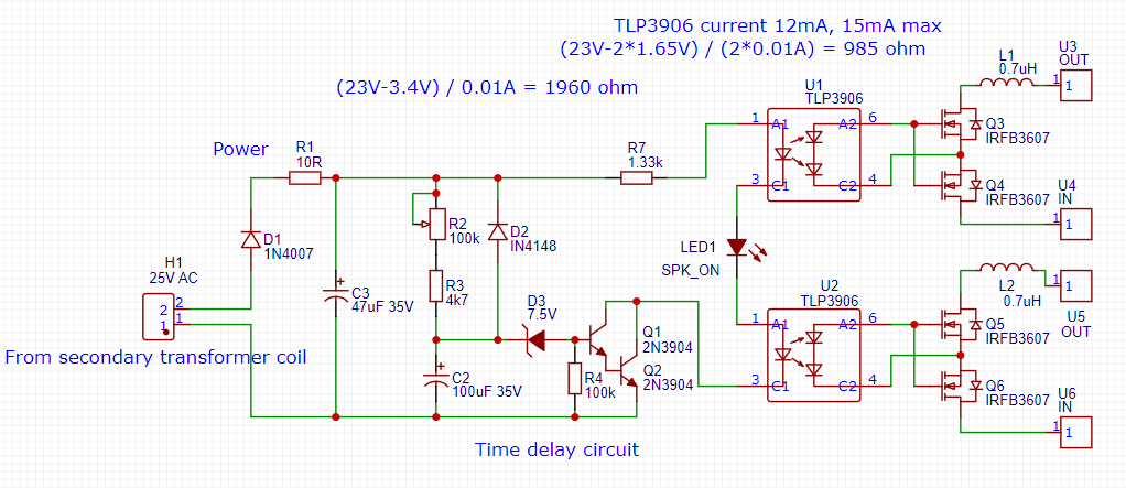

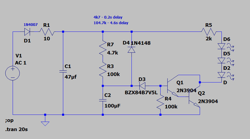

I think I figured it out. Attached is the model that includes all three LEDs in series. Running it in spice showed acceptably small current ripple on each LED - from 8.7mA to 10.5mA. Turn off delay should be short too - because of 47uf cap.

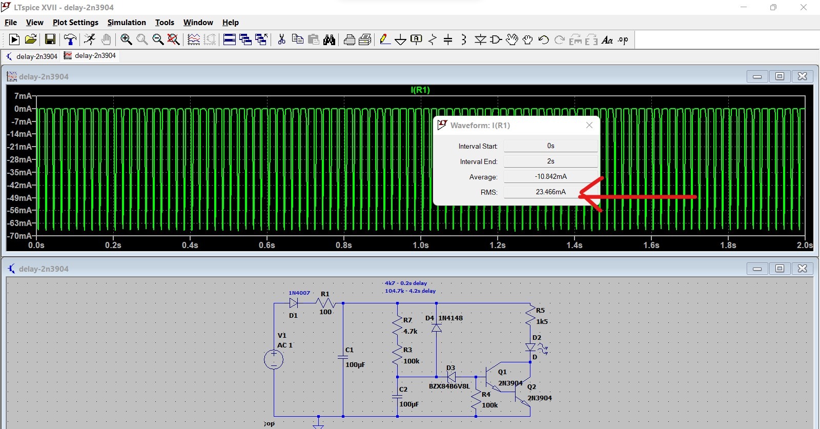

Mooly Moderator Joined 2007 Paid Member 2022-03-30 9:48 am #62 2022-03-30 9:48 am #62 You have 70ma but it is an AC quantity and very spiky in nature. The rms value is just 24 milliamps giving approximately 60 milliwatts dissipation. Attachments Screenshot 2022-03-30 094126.jpg 301.3 KB · Views: 110
