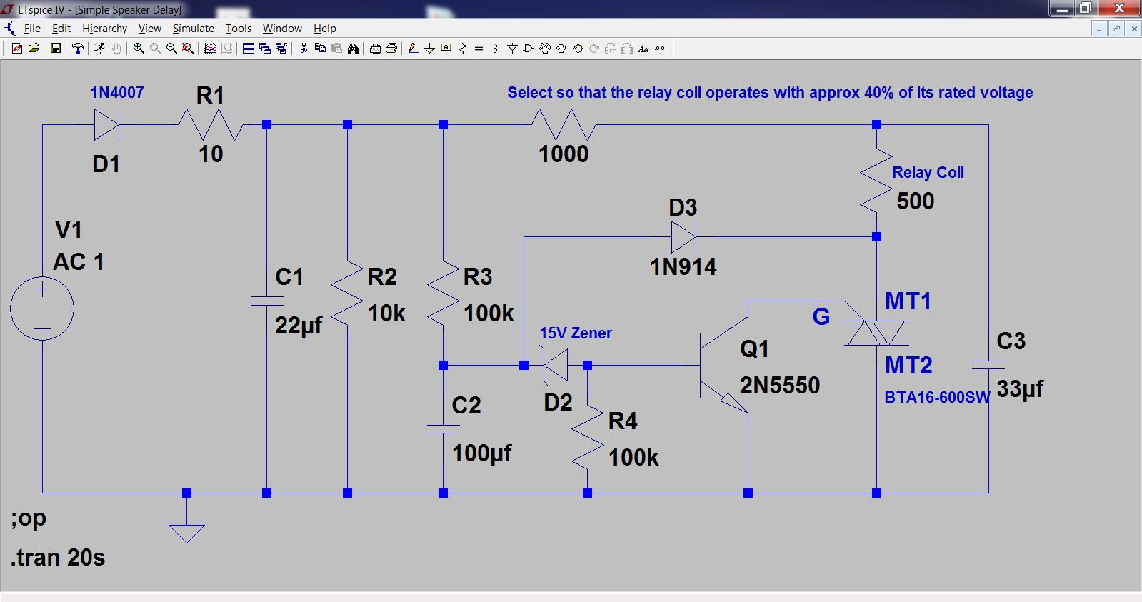

The circuit...
I drew the circuit in Spice more for clarity as much as anything else, however I found that it was possible to simulate it as well although the component
values used in the simulation are different from the "real world" values that the circuit works well with. This simulation problem is almost certainly
caused by the Triac model used. So on to the real circuit... understand how it works and you can modify it to suit.
(And why a triac ? To "kick" the relay with a high pull in voltage require that the device driving the relay operates quickly. A transistor "drifts" into
conduction as the base current rises which would not pull the relay in quickly enough when the relay is fed from the power saving series resistor feed)

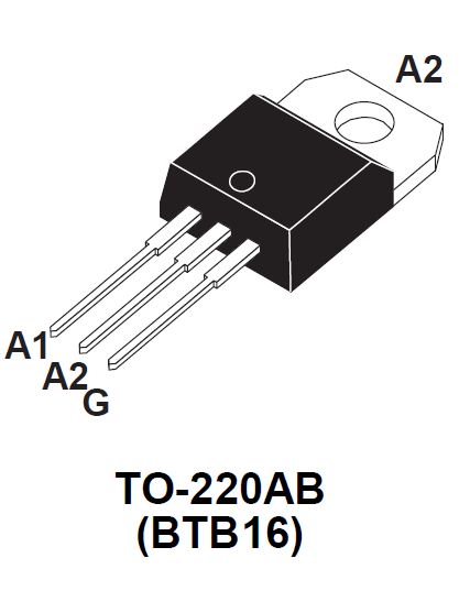

The Triac.
The triac is a BTA16-600SW device. This is a "sensitive" gate trigger type (easily triggered) and has a low "minimum holding current". Triacs are
interesting devices and can be triggered in one of four "quadrants" depending on the polarity of the voltage across the main terminals. Once triggered the device remains conducting and can only be turned off by interupting the current flowing between the main terminals.
(Refer to the pinouts of the triac in the data sheet AND NOT the LTspice symbol which to me is back to front)
MT1 connects to the relay.
MT2 connects to ground.
The triac is triggered by pulling the gate to ground. This is done by trigger Q1 as explained earlier.

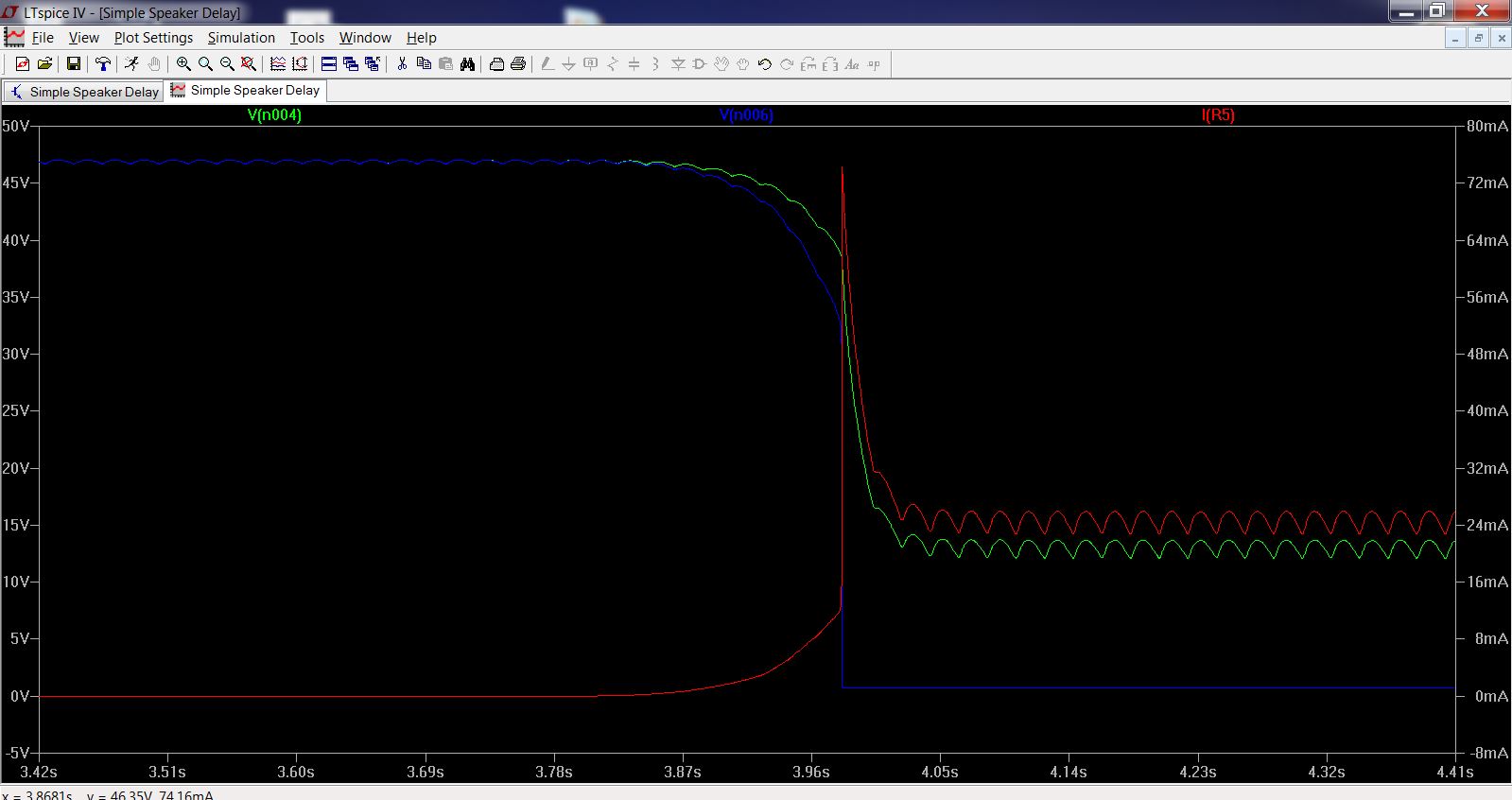

1. The circuit diagram (but refer to text for values)

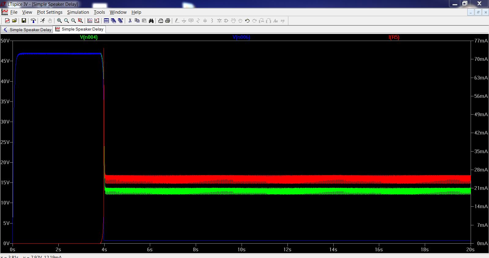

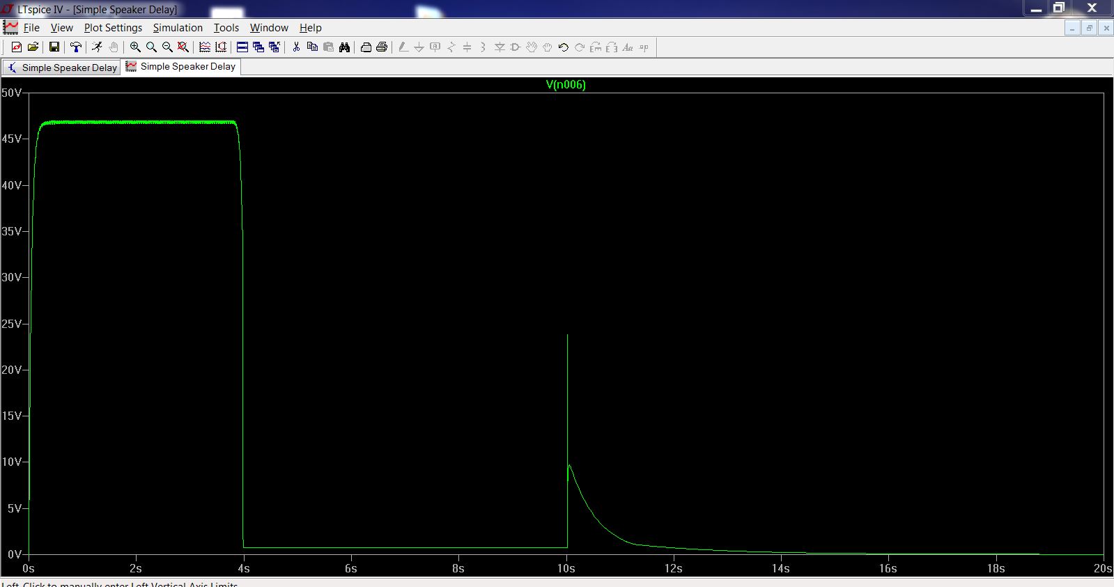

2. The timeline of operation showing the delay, the voltage across the triac and relay and the relay current.

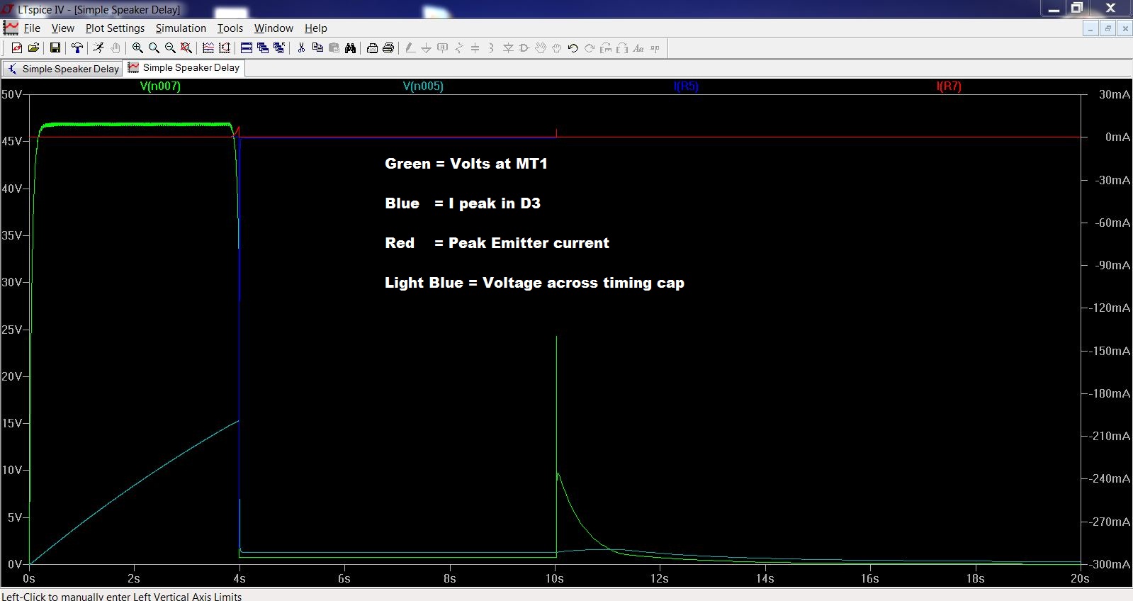

3. A close up of the transition period.

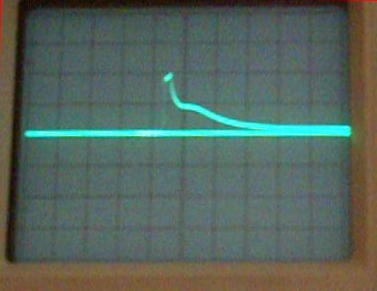

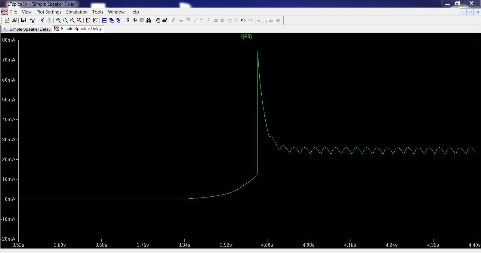

4. The relay "kick" current.

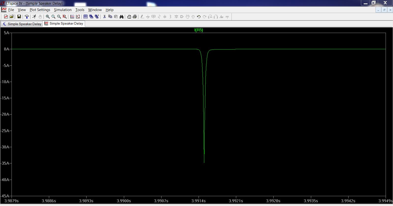

5. The triac pin outs. A1 and A2 are "main anode" which equate to MT1 and MT2 (main terminals).

back emf diode or diode+zener across the relay coil?
Doesn't seem necessary here. The top of the relay coil is all high impedance at DC, and "AC" coupled to the zero line via C3. So any "spike" there has a safe path and is hugely damped. The triac wouldn't be harmed with a "reverse bias" spike either because its happy with voltages of either polarity. Diode D3 via the timing cap (unintentionally but usefully) provides a path for that condition.
the field collapses as the triac is turned off..
nice one Mooly, perhaps you can add opto-isolators to short out the base emitter of Q1 in case of current overloads and/or dc voltage offsets at the speaker output terminals....
Thanks Tony. Good idea for adding an "input" to turn it off. Once the triac is conducting its only way of turning off is to interupt the current but its still easily do-able. An NPN transistor biased "normally on" such as for example with a resistor from base to the supply and fitted between MT2 and ground should work. To kill the relay the base would be taken low.

Some observations about the component choices:
-D3 and Q1 will have a marginal or insufficient voltage rating, particularly for 230V mains
-A resistor in series with D3 is required, to limit the discharge current of the 100µF (charged to 15V) into the triac
-A resistor in series with the gate of the triac is not absolutely required, but highly advisable. Without it Q1 could pass into dangerous regions of the SOAR for some ms, when the current is close to 10mA, and the voltage not far from 300V in 230V systems.
A diac instead of the zener could help, by providing snap action (also with a proper limiting resistor)

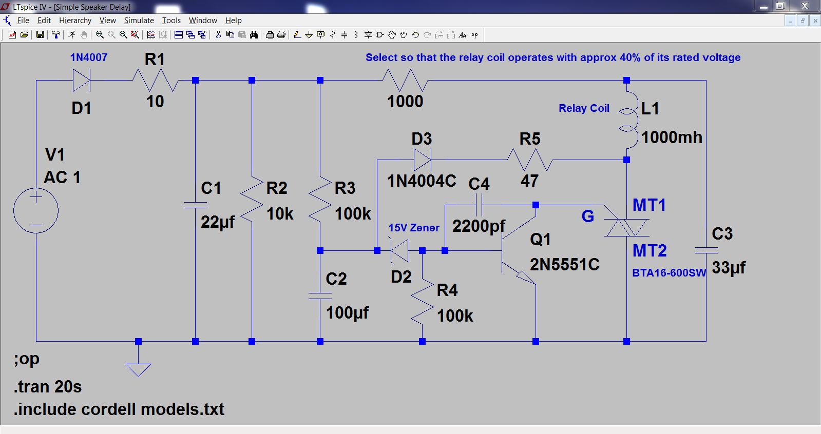

I don't understand the back emf being allowed to be neglected.
It seems to me that the coil back emf will try to pulse against the two "closed routes" facing the bottom end, i.e. the signal diode and the triac. If the triac is rated at 600V of reverse voltage then diode is more likely to break down first. it only has a 75V rating. The fact that there are resistances in the back emf route does not reduce the likely hood of reverse breakdown. They will simply reduce the peak reverse current during the breakdown phase.
Is my thinking incorrect?

Resistor for D3... good point, that's something I hadn't thought of and the peak current discharging a 100 uf or more could exceed D3's surge limits.

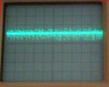

I don't think your thinking is incorrect, its just that I don't think in practice there will be an issue. On switch off the circuit turns off "quickly" but not "that quickly" if you see what I mean.
I'll put a 100Mhz scope on it (probably tomorrow) and see if I can see anything.
That a signal diode that has a reverse current limiting resistor is a reliability issue. It may well last decades worth of power downs.
That is OK by me.
I was just confused that you and Tony were discarding the need for the diode or diode+zener that everyone else uses so flippantly.
It may be that the triac cannot be turned off that saves the semiconductors around it.
The supply simply decays to zero volts to allow the triac to switch off.
Is this last statement more correct?

Elvee mentioning the series resistor is a valid point. When the triac turns on it can be thought of as putting the 1N914 diode across the charged up cap. Its not an instant nano second switch on but is it quick enough to take the diode over its limits.
So I've just looked at the data sheet for the diode,
non-repetitive peak forward current square wave; Tj = 25 °C prior to
surge; see Fig.4
t = 1 us - 4 A
t = 1 ms - 1 A
t = 1 s - 0.5
In practice and again I don't think there is an issue seeing those figures. To swap the diode for somthing like a 1N4004 would surely remove all doubt if anyone were concerned about it.
The back emf... I'll see what shows in the real circuit.
The scope test was interesting. Measuring on "top" of the relay i.e. on C3 and all is clean as expected. Measuring on the bottom end and this is the result...
On switch on "noise" occurs as the triac comes into conduction.
On switch off a high positive transient is seen. Highest amplitude I could discern during many off cycles was around 115v volts.
So this is one real issue with the design as it stands and the fix is simple. A higher voltage diode (the P.I.V. rating) should be used for D3. A common 1N4007 would be suitable.
I looked at ways of reducing the "noise" and found that adding a small cap across base and collector of Q1 worked well. Anything from 100pf to 0.47uf stopped the switch on "noise". Also observed was how this cap reduced the high voltage transient at switch off, the larger the cap the less the transient. Values around 470pf to 2200pf seem a good compromise. With 470pf the transient is around 40 volts peak and with a much slower rise time. Going too large in value slows the rate at which the voltage across the boost cap builds. There must be some conduction via the triac gate for this effect to occur, not enough to trigger the device but enough to impact on the charge time of the cap.
So to summarise up to now. I think fitting a 1N4007 or similar is sensible for D3, and adding a small cap in the 470 to 2200pf range across B and C of the transistor as a refinement.

For a bit of fun I replaced the 500 ohm relay resistor in the simulation with a 1000mH inductor of 500 ohm resistance. How close that inductance value is to a typical relay I have no idea but the simulation now shows an 80 volt positive going spike at switch off.

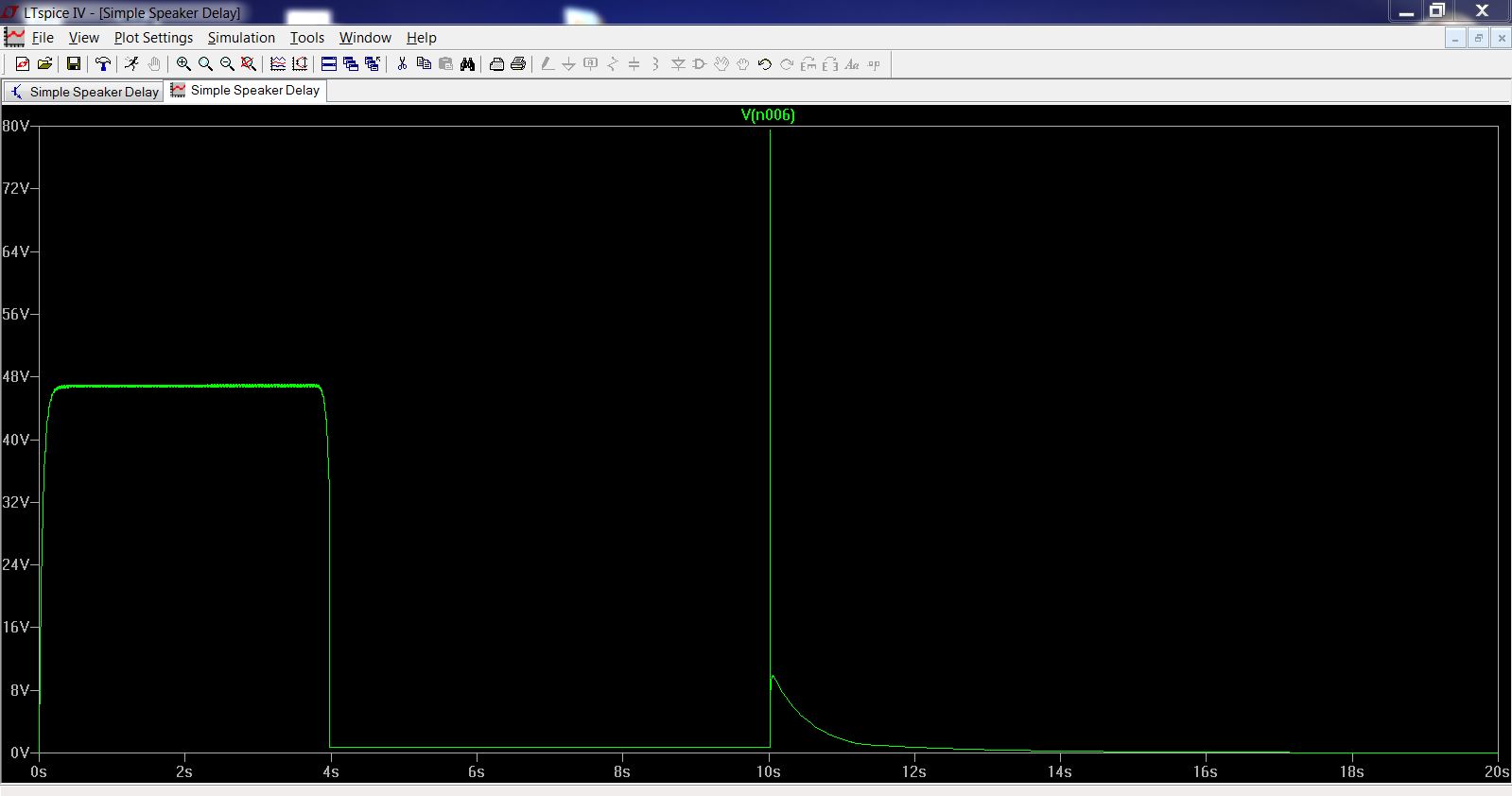

The cap mentioned in the above post added between B and C of the transistor also seems to work in simulation by reducing the transient. The noise produced as the triac comes into conduction eludes simulation and doesn't show.
So here we have with a capacitor of 2200 pf and without.
Did you attempt to compute, or at least simulate the actual current in the diode? I think you would be surprised.t = 1 us - 4 A

This illustrates Elvee's point about the transient current in D3. How much 😀 It sure looks scary in simulation and its obviously a very valid point. I'm going to stick my neck on the block and say I don't believe it will approach anything like this in practice but it will still be high, possible a spike of a "few" amps. So the fix for that is a series resistor for D3. Value anything in the 47 to 100 ohm range. Go higher and the timing cap starts to take a more noticeable time to discharge meaning the rapid reset ability on power off is reduced. Its all relative though and we are talking fractions of a second for values below 1k
So the new data and circuit is as follows.
Transient spike is now 25 volts.
Peak current in D3 is now below 300 ma
Peak emitter current is below 8 ma
Timing cap voltage take around 15 ms to reset (still very quick)
