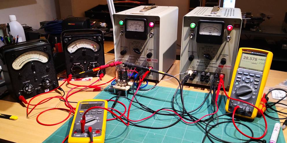

So you want to generate the negative voltage between the cathode and ground? Thats a smart move, as it allows direct measurement of grid current over the 100K grid resistor using a 10Meg input impedance voltmeter.
The downside is that your supply needs to be able to sink current, what you can do, is shunt the supply with a 200mA CCS (LM317 CCS) for example.

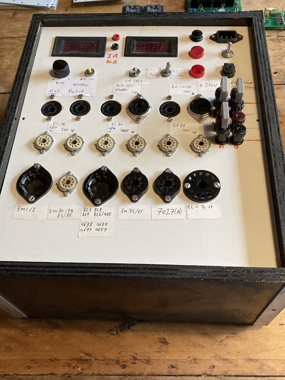

Ive build approx 4 tube testers so far, but most have become to heavy for daily use. Once you start addding functionality and linear supplies capable of testing the biggest of tubes it becomes heavy and complicated.
I once got around this by building a simple tester that has only one user settable control: G1 voltage. And fixed solid state 250V 125mA supply inside (+-0.5%)
If you know IA at a specified VG you can test the most common recieving tubes on this kind of test box with decent accuracy.
Gas test is just a normally closed push button that shorts a 500K resistor, once you push this in, any grid current will cause a increase in measured anode voltage. If this increase is over 5% there is gas in a tube.
Case and point i reject EL34 tubes if IA increases by more than 5% once you push the gas test.

Stop oscillations by putting a small ferrite ring over each lead right up at the valve holder tag. Ground the cathode and put the meter in the anode side.
Ah, I see. Is this how it's usually done - put the meter in the anode?
Is a resister instead of ferrite beads OK, like 470K? (less for 300b etc)
1K carbon comp in series with G1 will stop most oscillations, and has a neglible effect on testing accuracy.

Yes primary prevention is best served by a 'grid stopper' carbon comp resistor. 1 to 10k.
Keep everything as short as possible and it will likely be okay. If you get strange results then fit the beads...
No need to use a grid leak when you apply the negative voltage to the G1, it cannot float and therefore does not need to 'leak' to ground.
PS Not sure you will get meaningful results for a 300B with 150 volts HT and -30 volts bias? (ECC8x / 12Ax7s fine though.)

Some progress and some issues.....

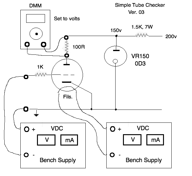

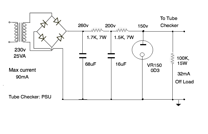

I have got a Tube Checker up and running. Circuit attached for Checker and PSU.
The PSU regulates to 150v off load, and passes 32mA current. However when connected to the Checker it doesn't regulate properly. I get e.g. 180v. So the readings off the 100R resistor in the Checker aren't what you would expect from the curves at 150v. They are, however, around what's expected for 180v.
I built the PSU for small tubes testing hence I only used a 25VA transformer. One other factor is that I set all this up in sunlight, don't know if sunlight affects glow tubes.
Any idea why the glow tube isn't regulating on load? Any other criticisms of the setup?

Apart from this, using bench supplies is perfectly fine for tube testing. Bench supplies can usually be connected in series, which gives a higher DC voltage.
Also, using a bit of software will turn programmable bench supplies into a curve tracer or a tube/transistor matching system, see here (scroll down to see some examples): GitHub - mbrennwa/PyPSUcurvetrace: Python program for I-V curve tracing of electronic parts using programmable power supplies

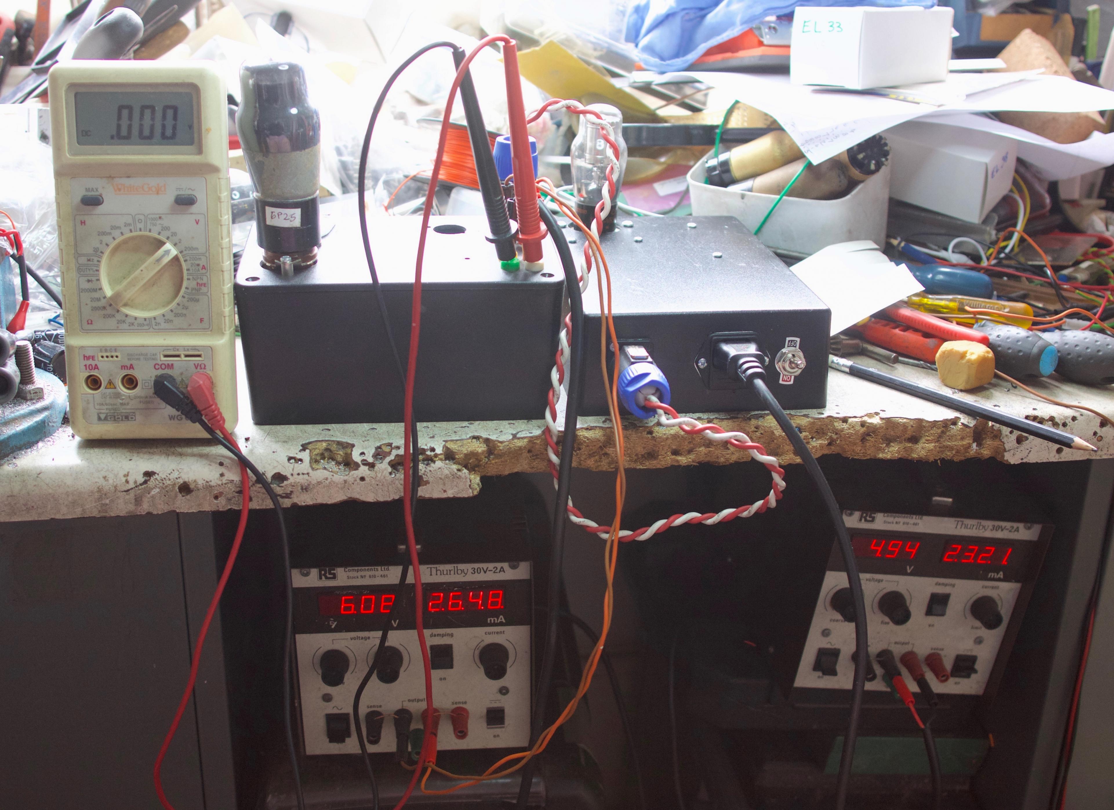

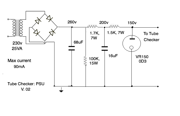

Update - I think this now works. I changed the PSU a bit - put the 100K bleeder resistor before the glow tube. I also used a different glow tube. The readings I'm getting now look correct. I've tried a couple of EL33 and they look right, using the data off the curves.
I'm cautiously optimistic that I now have a working tube checker.....
Early days, but I've now tested about 25 of PL33 in triode using the given triode curves at 150v and -5v bias, and the results are as expected. So I can declare this a working emissions tester. Photo attached in its raw state. I'll build a bigger box with more tube bases on it and some kind of switching ability for the pins, but for now I can go on testing tubes with typical bases like the usual octal output tubes. I'll add tube bases as I need them. I'm happy with this.
