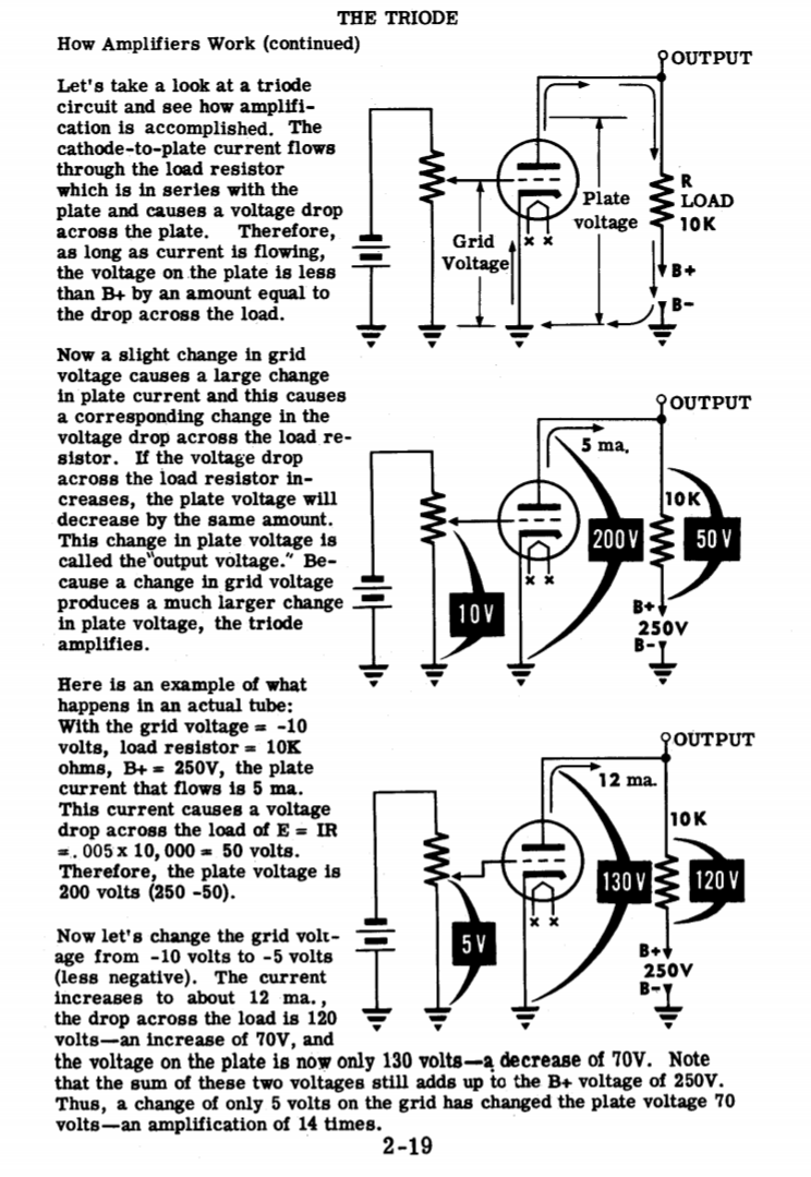

simple triode gain stage
hi all
according to pdf i've sent i have a problem with it
in page 11 the author uses -1v as a grid bias voltage
before he ploted the dc load line on the curve
of course we know that -1v means that -1 to zero for positive and -1 to -2 for negative cycle of swing
but in page 13 as u can see he used -1.5v as grid voltage in order to calculate the cathode resistor to plot ac load line
using -1.5 has a special reason or the authur prefered to use it??
and i wanna know that the way to achieve the optimum bias point is that we should plot ac and dc load line in triodes and the cross point of them is our optimum?
The -1.5V bias point is just an example. The AC load line crosses the DC load line at the bias point,
since it must coincide when the input is reduced down to zero. That is, the AC load line is plotted
starting with the Q point, using the AC slope instead of the DC slope. From geometry, recall that
a point and a slope determine a line. The optimum bias depends on the requirements, keep reading.

....in page 11 the author uses -1v as a grid bias voltage.....but in page 13 as u can see he used -1.5v as grid voltage...
Perhaps he picked 1V as a simple round number just to see how the stage worked.
Then when he went to use it, he realized his signal might be more than 1V peak, and changed it to avoid gross distortion.
Like: I design a house 1 furlong wide. Then I sketch all my furniture and tools in it, see if they fit. I realize I really need a house 1.5 furlongs wide. (A furlong is 16 feet.) We can change our plans.
if you are too lazy to plot load lines, the RCA resistance coupled design charts give you a table of tubes and resistor values, pick one that suits your requirements...
common cathode circuits can be designed for maximum gain, or maximum output swing and anything in between...
i can say that gain is affected by cathode currents since transconductance increases as cathode currents increased, all within reason as plate dissipation is your show stopper..
the plate load resistor determines your operating point, you can get the plate voltage and grid bias from your plate load resistor of choice...
that valvewizard blog is a good source of information imho..
