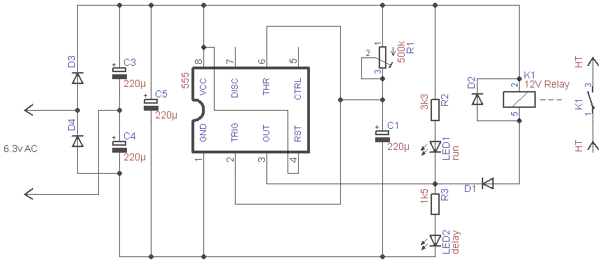

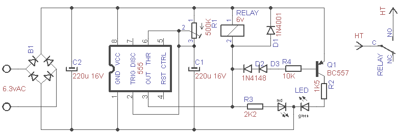

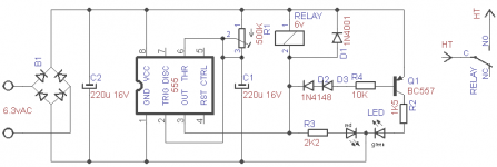

If reliability is important, the 555 would be a good choice. And it can drive LEDs too.
Something like this:
edit: the first schematic is for a dual color common cathode LED. One can of course drop the LED circuits if not needed.
edit2: in the first schematic, the pin 4 should go to Vcc, like in the second. Sorry.

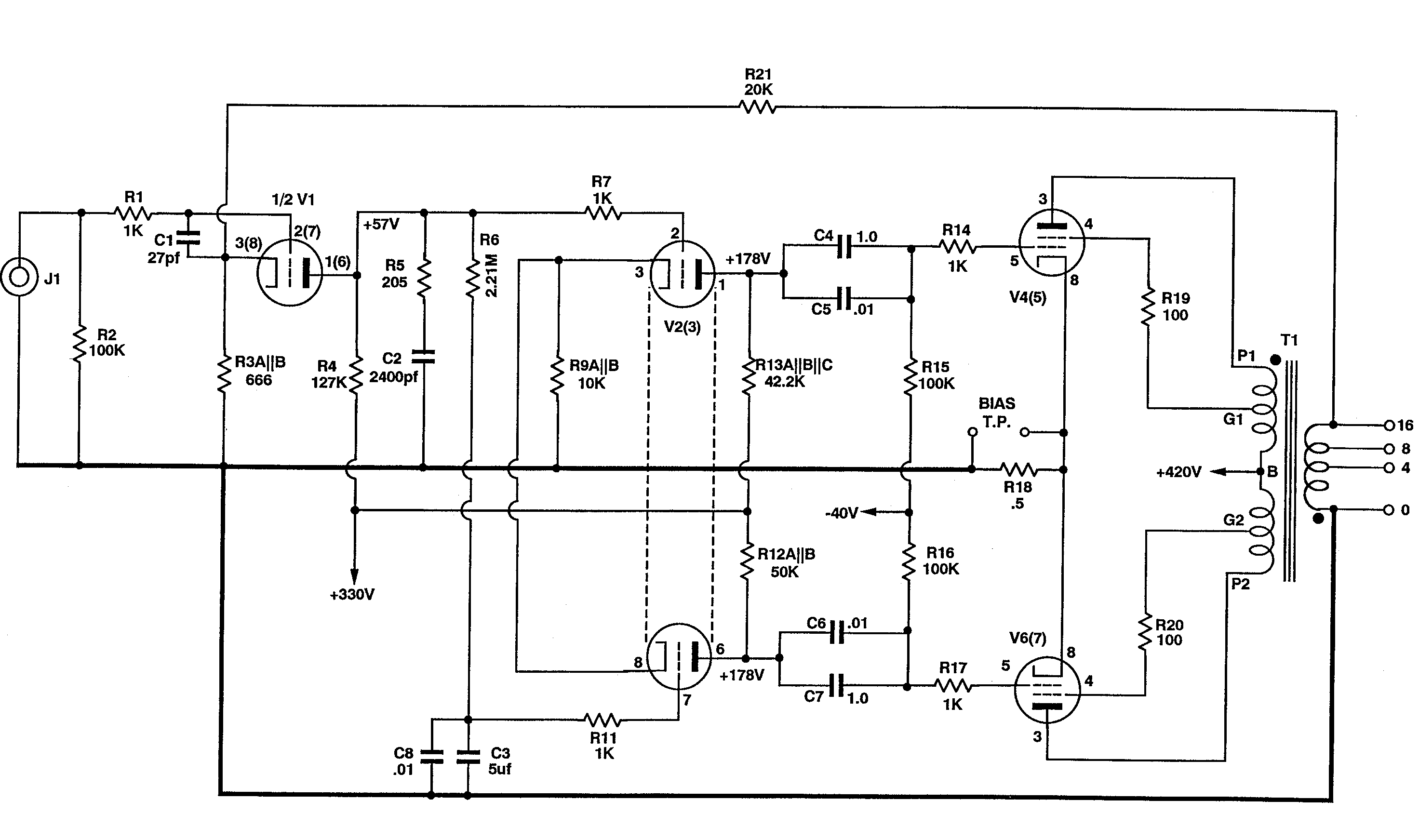

WARNING: you can't just use a delay in *any* amplifier! Weird things can happen at a sudden turn on. For example, current peaks can occur in the power tubes, because some capacitors are empty and need a few time constants to charge up.
And if the bias is fixed, it must be present before applying full HV.
It is best to use a vacuum rectifier because of its soft, progressive start. For the delay, just put a relay in its heater circuit.

What capacitors are you talking about? How are the tubes seeing damaging inrush currents? If your talking about coupling capacitors, they are tiny and charge current is limited by the grid resistor of the following stage.

Sometimes they are not tiny! For example this Audio Research amp. A guy on another forum blew the power tubes after adding a delay relay to this amp. See R6-C3, C4, C7 how big they are?
