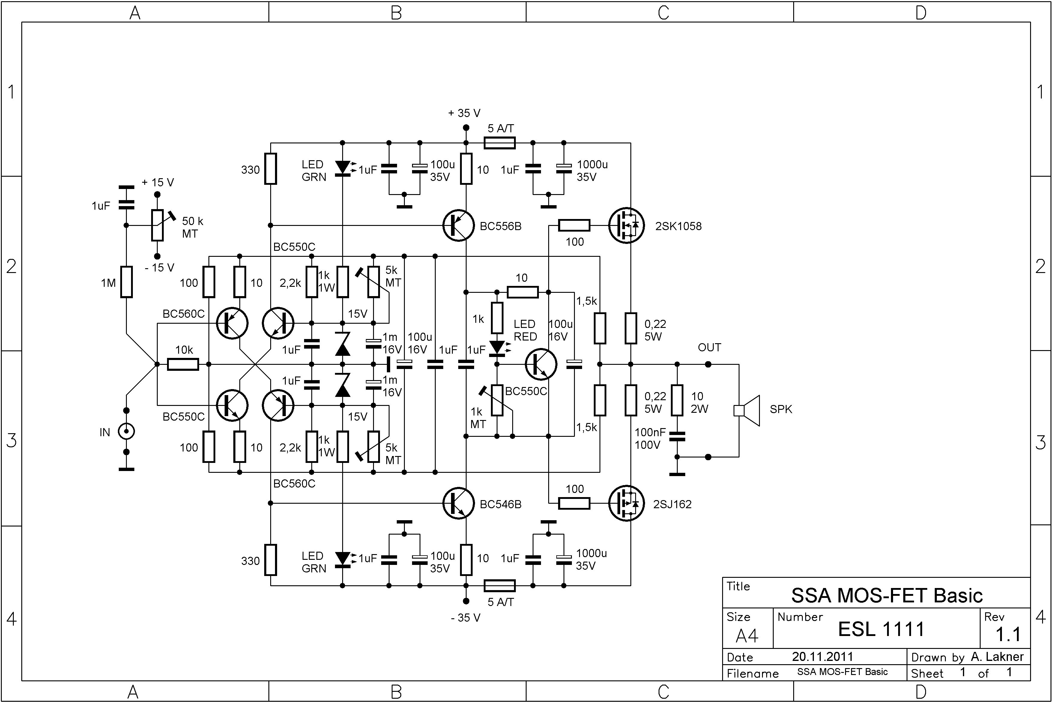

SSA MOS-FET Basic 1.1
tempting 🙄
anyone done further work on this one ?
is +/-35V highest possible voltage ?
Hi tinitus 😉
Based on latest experiences gained from extensive tests and measurements I prepared you the SSA mosfet basic version which should work on the spot at the first time powering-up.
Instead VAS bias resistor only I put Vbe multiplier, installed on PCB, to act as adjustable zener only, to prevent DC gate voltage variations because of the VAS current thermal fluctuations. These are however small but to eliminate any bias traveling I find it most adequate, also this solution is tested and act perfectly.
VAS transistors are high voltage plus high hFE BC's because of the high bandwidth expectation from SSA. Set the VAS transistor bias current to max. 7 mA (70 mV across 10 ohm emitter resistor) to maintain its power dissipation below 250 mW.
There are also few parts added to enable input offset voltage to be trimmed to zero. Current through 1M resistor needed to balance input BJT's base currents to zero input DC voltage is only around 0,4 uA. This calibration is very important to maintain DC integrity regardless un/connected source to the DC coupled input.
Of course you can higher the rails voltages potential and recalculate two supply 1 k/1 W resistors only, but than you should be careful to speaker impedance connected because of only one pair of the mosfet outputs - SOAR.
Wish you a very pleasant time building and listening to SSA, regards Andrej 😉
P.S. And please don't forget to thermally couple the input pair BC550C/BC560C transistors, it is very important to maintain DC offset stability.

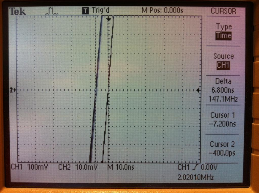

SSA BIGBT HP front-end initial power-up, stability check and some measurements.
Prior to full power testing with complete circuit (BIGBT power outputs) I checked what can I expect from SSA High Performance front-end plus power mosfet drivers. SSA input bias set to 2,5 mA, VAS bias 15 mA, drivers bias 50 mA.
Offset trimmed to zero and it was inside +/-20 mV all the measurement time with no instability issue. Bias of the drivers was completely thermally stable.
Than AC measurements took place and here are the results:
- output impedance 38 mohms, tested at 1 A/4,7 ohm load
- 1 ohm stable (drivers as output devices) inside SOAR
- bandwidth -3 dB unmeasurable with my current equipment
- input/output phase delay 12 ns at 2 MHz (period 500 ns), that is equivalent of 8,6° phase shift
I was satisfied with initial testing, so we have a go for further development. 🙂
As I already explained, my current activity is mainly concentrated to the SSA BIGBT High Performance schematic from the post #1377 to squeeze out maximum performance from given topology. Here are some improvements gained from yesterday's modifications and extensive testing:
- damping factor 168 ie. output impedance 28 mohms, tested at 1 A/4,7 ohm load (IRF610/9610 as outputs in this phase of testing)
- input/output phase delay 6,8 ns at 2 MHz (period 500 ns), that is equivalent of 4,9° phase shift
- Miller-capacitance compensation capacitors of only 4,7 pF added to VAS cascodes for HF stability (small 138 MHz oscillating tendency eliminated)
In the background PCB designing process for this schematic is already in progress, so be prepared soon. 🙂
P.S. Images explanations:
- first plot shows 2 MHz output signal 22 Vpp on CH1 and 1,8 Vpp input signal on CH2, voltage gain 21,74 dB. Phase shift is so tiny that cannot be read-out from this plot
- second plot is X-Y magnified waveforms to see actual phase shift. Left rising edge curve is the input signal and 6,8 ns delayed is the rising edge from the output signal, which is BTW crystal clear from any artefacts

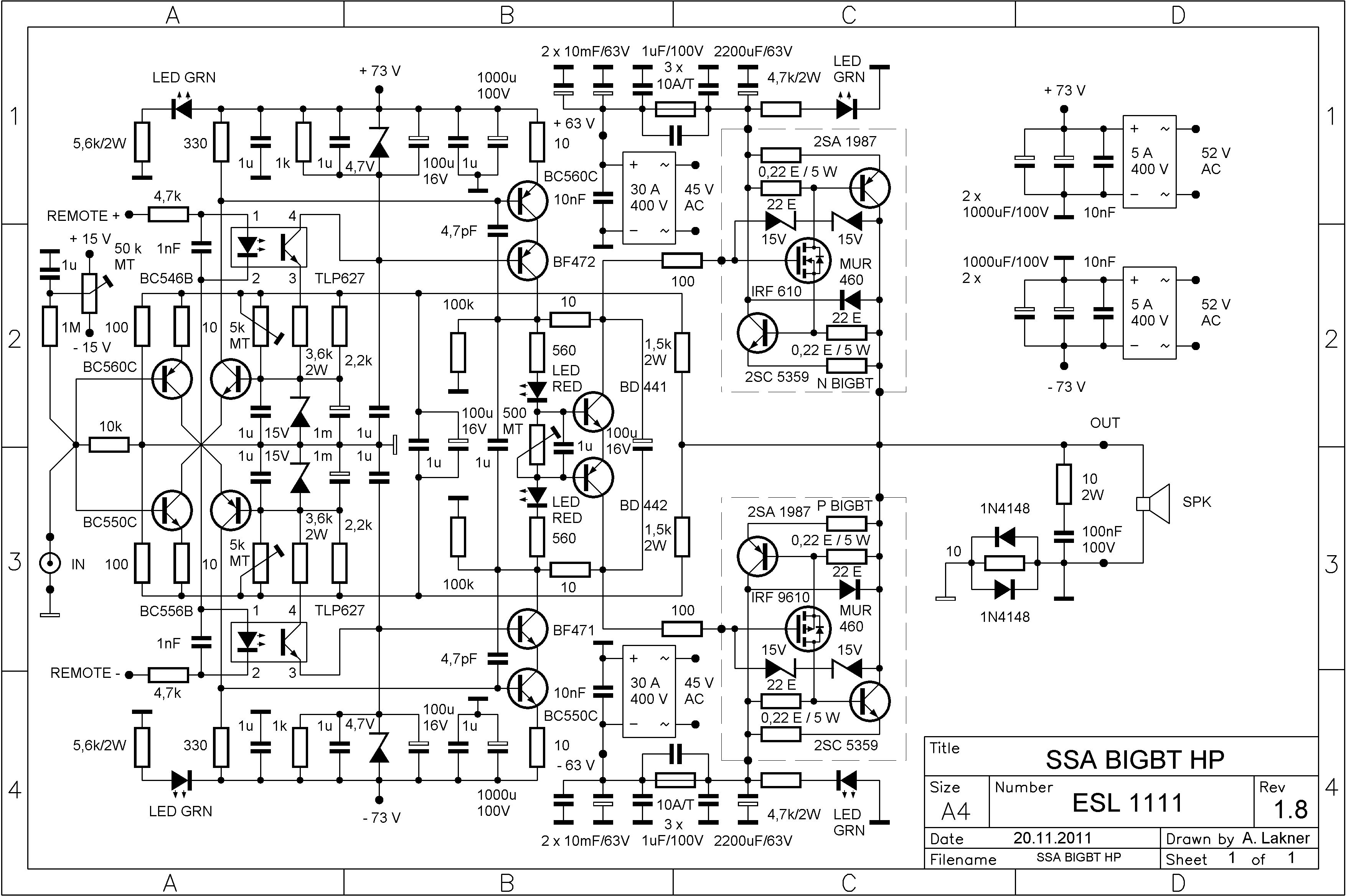

SSA BIGBT HP 1.8
Somebody would ask himself, why on this world he is performing 2 MHz testing only, what intriguing reason for that it would be? 😱
Well, 2 MHz is only 100 times more than 20 kHz and according to my opinion, if we want to produce uncompromising power amplifier at least that 100 times higher bandwidth conditions must be well defined, only than we could expect everything is perfect inside basic 20 Hz-20 kHz bandwidth. 😎
What I came up until now is included in the updated SSA BIGBT HP schematic. 😉
Enjoy, Andrej :spin:

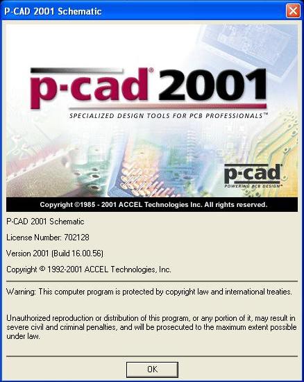

Good stuff, the faster the better 🙂 With my MOS amp I've worked some more on its slewrate as originally it was asymmetric. It's now a good 400V uS both pos and neg, but then again, it is driving 500W into 4Ohms and got into sub PPM region again 🙂 20 - 20KHz is/ as you describe it - pristine reproduction.
P.S. Which version of P-CAD did you draw that schematic in?
:wiz:
hey, this is simple enough to do veroboard/hardwire
:cheers:

Hi tinitus 😉

LC,
If implemented the needed transistors from post #846 to the last SSA Mosfet SCH, should it to be used the Fet I/P to the -3 pin XLR I/P and associated offset trimming parts also ? 😕
The last SSA mosfet sch which is probably on your mind, I think it is the SSA Headphones Amplifier from the post #1429, if I am not wrong. Well, double j-fet buffer is sitting there just because the headphones amps shouldn't have any connectivity restrictions regarding impedance dependency issues. With input j-fet buffer SSA becomes high input impendance amplifier, suited to accept any line level audio source on the planet. If your balanced source outputs are for any reason the high impedance ones, than you should think to use j-fet buffer on both differential inputs, if not, than the regular SSA 10 k input impedance configuration is OK.
Balanced input SSA extra parts are marked with star/multiply sign, so all together 7 parts (4 trannies, 3 rebels) must be added. Trimming parts are current supply sources for complete balanced bridge, dividing current to both positive and negative input transistors, so that is where/why differentiation of the balanced signal is taking place.
Is it of any benefit to have all I/P transistors from inputs +2pin and -3pin XLR inputs to be attached together for best thermal tracking ? or is it even better to have all 8 transistors IPs incl.(cascades) on the same heat-sink to share the same tem. - follow its dependency for the complete group gain changes ?
At this point I can assure you that the best thermal stability would be if all four input transistors are on the same temperature level, 4 cascode transistors are free from this thermal joint. The best way to realize this thermal joint is to glue the flats of input transistors to each side of Al cube of 5 mm edge. Also all four of the inputs should be hFE matched within 5% of the chosen value.
Will this VAS stage be able to drive 2 pairs of OP LatFets ? :scratch:
Thnx for the answer.
:cheers:
Yes it will be, as long as the VAS bias current is 20 mA or higher. Than of course you should take care of good heat dissipation from both VAS cascode transistors, especially because of this increased current level.
Regards, Andrej
