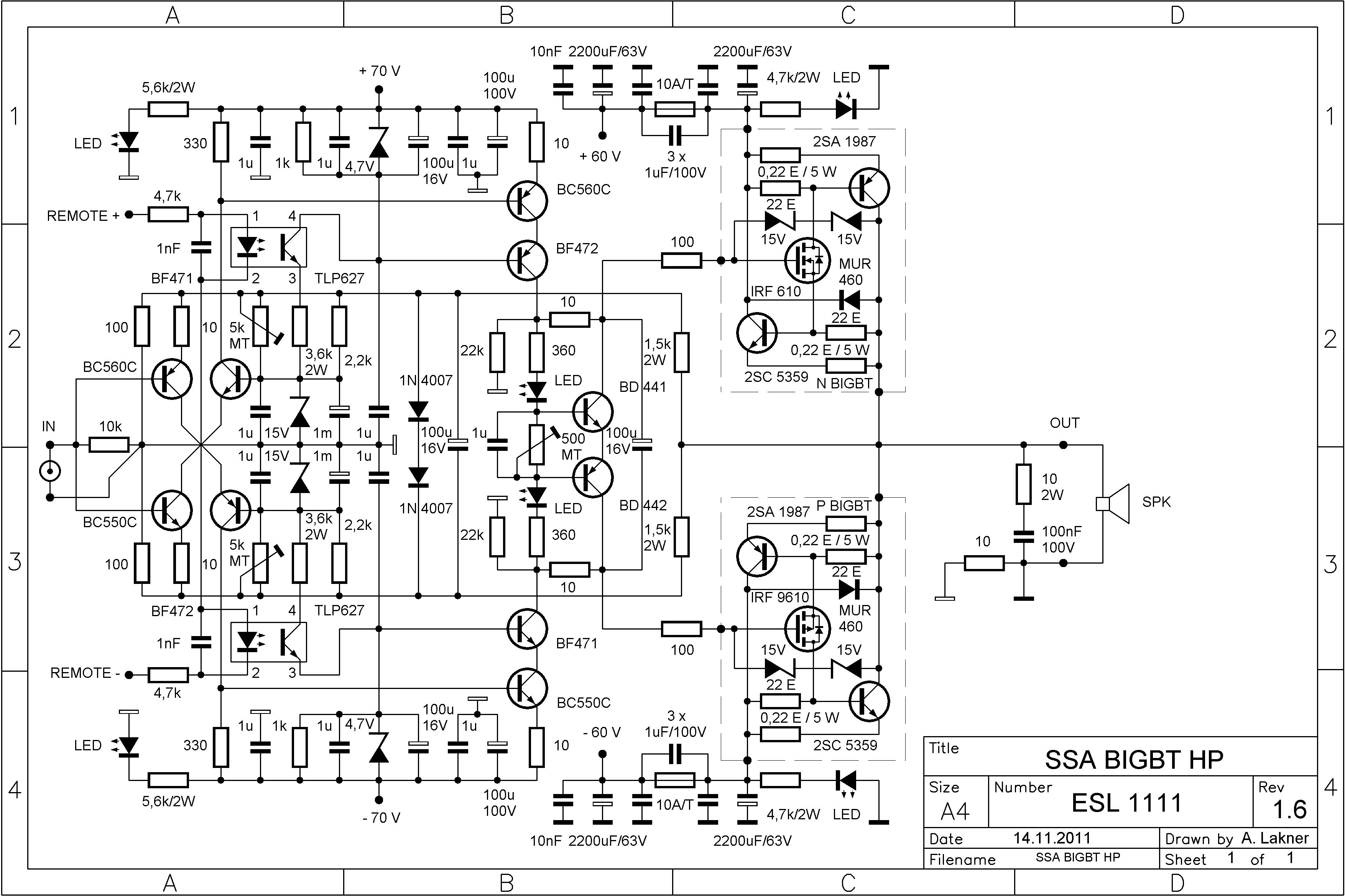

SSA BIGBT High Performance
Going to build this one. :)

Excellent on 1600x1200 notebook
Why yours circuit diagrams are always so big?? Not easy to check on line, need to copy first and this is not practical.
dado
@ dadod,
:) They are excellently fit on the 1600x1200 screen res. before click on to left lover corner X to expand it to see it in a full resolution (Opera), maybe Your brovser automatically expand the img file to full resolution of 3.508 x 2.337 pixels @ 24 bits but then again perfectly fit on 1900x1200 screen res. :)
@ LC
:cheers: LC :cheers: for the HiQ of Yours SSA BiGBT version.
You perhaps already listen it for a while.
Could You pass some of Yours listening impressions for this HiRes HiPower SSA amp?
What speakers You drive with it or You maybe use a multi amp arrangement ?
- Would it'll be necessary to change much of the values for the IP and OP stage if the voltage
for the OP Stage would be + & - 50V DC (2x45V AC - CM500W trafo) and separate 60V DC for the IP stage ? :scratch1:
OK guys this one has also on board remote on/off capability, so no output relay is needed. :)
I would really like to make this amp on a compact double-sided professional PCB not bigger than standard euro format. ;)
I hope the schematic is OK and now I am in a waiting mode for ... :wiz:

Yes, until now I have a plenty of feedback info from my system and quite so from a fellow forum members. That is sufficient for me to start planning one PCB according to my wishes. It will be pain in ... to make it but at the end PCB will probably ended in a group-buy. Will see hehe :cool:
If there will be wishes like yours to adopt SSA BIGBT HP to different supply voltages, I will prepare all the necesary data, it is really nothing special, only a few resistors have to be changed accordingly. ;)
Cheers, Andrej :cheers:
Excellent :) Andrej, Yes please to the 60/50 V DC - Balanced - :cheers:

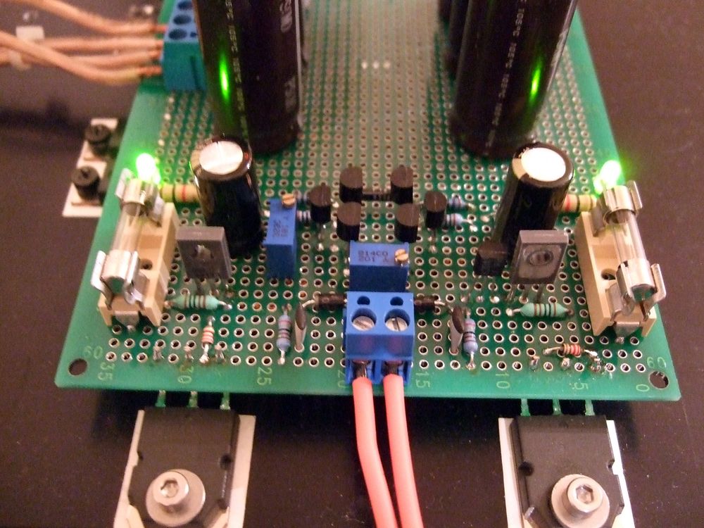

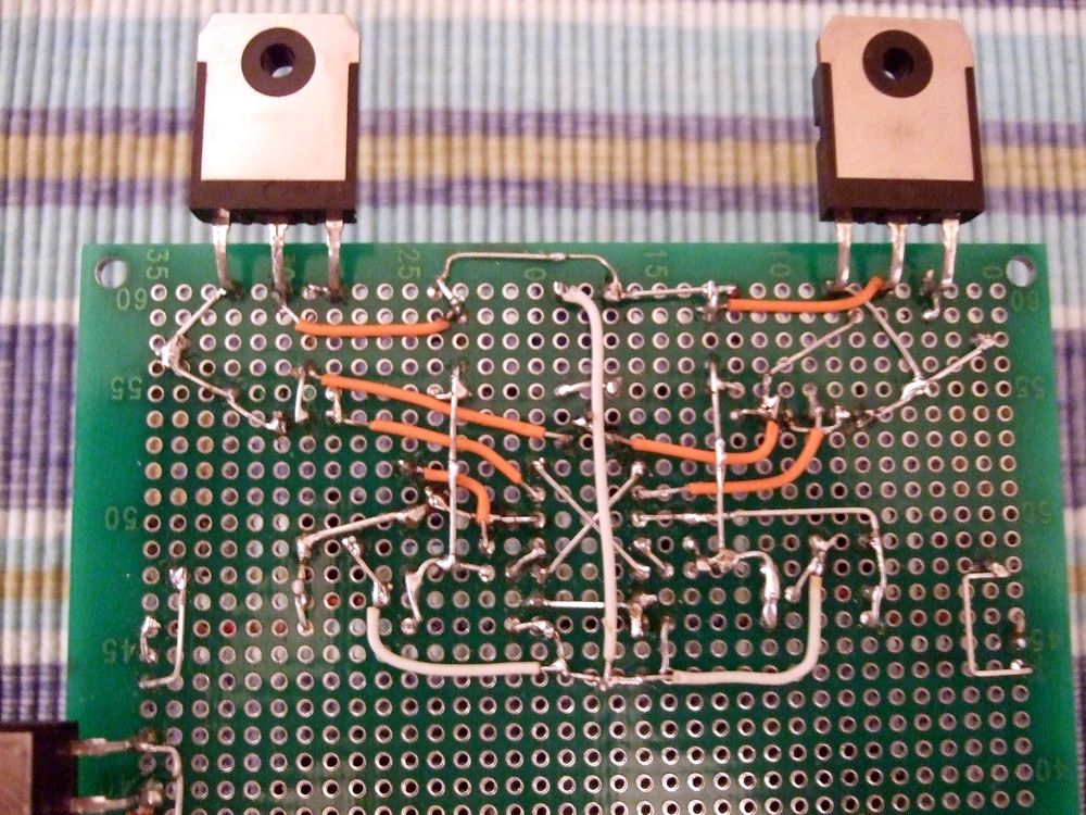

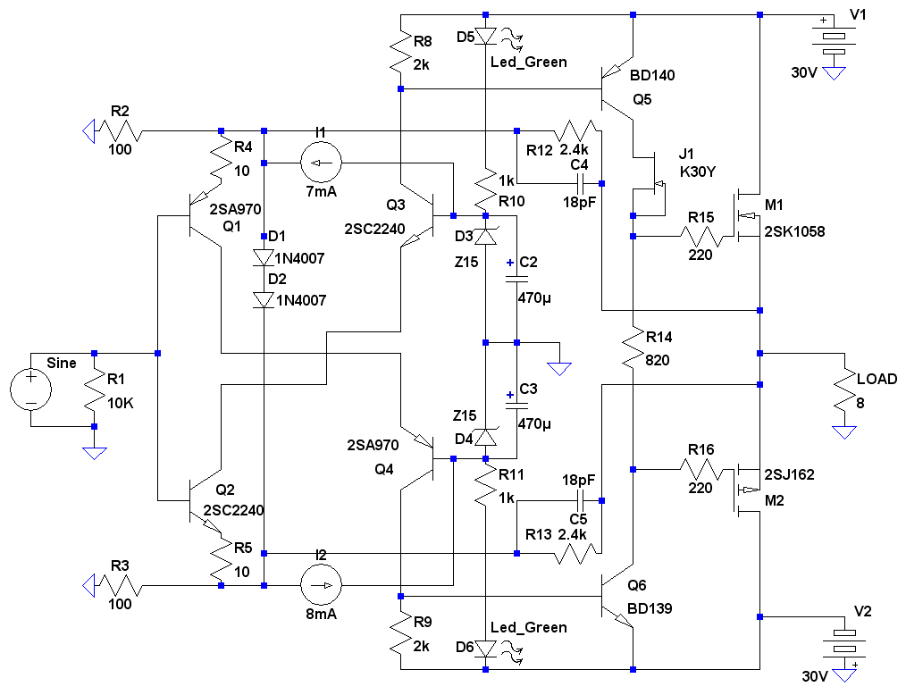

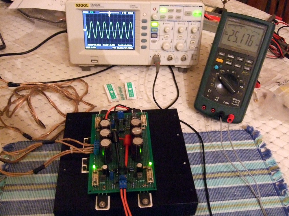

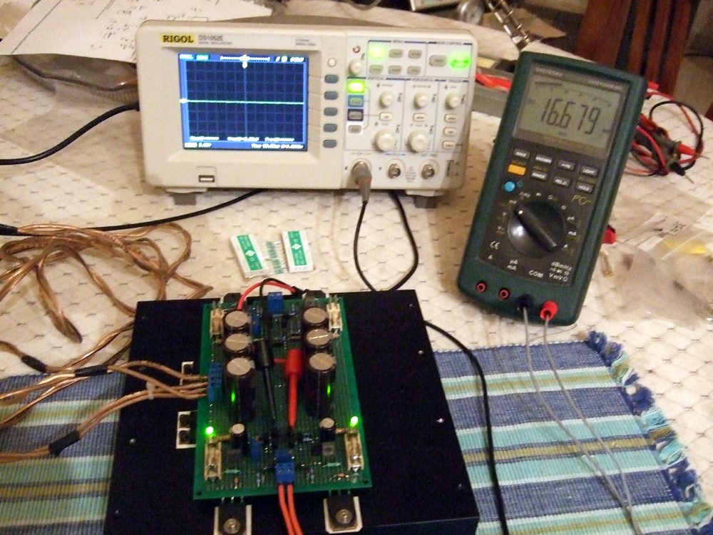

CCS patching update
I made a second SSA Sziklai Latfet channel, this time with CCS current feeders to first stage as I was planning to test. Good news, the offset can remain between -25mV to +25mV in operation. I employed the attached schematic. Started with R8,R9 1K. Alas, the wanting 2SC2240/2SA970 models overestimated currents for .op LTSpice analysis, and I had to patch 1K additionally for the drivers to turn on. So 2K it is, as drawn. R14 is 1K trimmer. I1 is a 7mA IDSS BF245B, I2 is a 10mA IDSS BF245B with a 100R trimmer between its S&G pins.
Output stage current got easily set with R14 and stable. Tried 110mA and 170mA. J1 is 2SK30ATM(Y) Toshiba 2mA IDSS sample. It can even be a lower pinch off type non matched between channels when having R14 a trimmer. Low noise and high DC stability JFETs are needed.
The test circuit starts with a momentarily 200mV DCout shot when plugged to power, then goes low fast. It can be fixed at about +10 to +25mV by varying I2's 100R trimmer a bit. With sine signal it shows -25mV steady DCout. When the plug is pulled, the supplies are getting drained unequally and the DC can momentarily shoot again, but under 1V tops. The gain I measured is 27.6dB. -3dB is 1.2MHz. No instability. FFT on scope eyeballs about 0.02% THD at 1W/8R with H2 leading, but it can be the old function generator lending that profile. The bandwidth got 20% higher since the last experiment with resistors as current sources. This maybe explained by 8dB more feedback available in the analysis because of the current sources giving 5dB more OLG and ~3dB less gain used in this one. My beautiful square wave rising corner got a bit peaky now though, but this is secondary to tune when packaged because it may change then. Still some time before really listening to it as it needs modding the other channel to match, a dirt cheap Epay delay and DC sense relay guard to arrive, and some putting it together to resemble an amp somehow.
