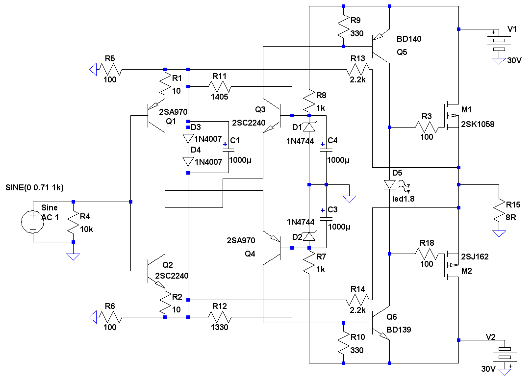

Hi Alex,
Could you create a 4 power output transistor version PCB and also the Power supply if you get a chance? I think there will be more interest on this than the V12 version, which I think so expensive to build.
Thanks and appreciate for sharing your skill/talent on designing PCB in this forum.

Hi Wayne,
If I have the money, why not. I tried matching hFE the other day and out of 20 pairs, I'm lucky enough to come up with 4 pairs. That means, I need hundred pairs or more for a V12 amp. 😱 Right now, economy isn't good so I'm just going for what I can afford. 😀
Hi Wayne,
I do not want to burst anyone's bubble, but matching components is a little rediculous to say the least.
I had a production run with some 100 amps. I decided I wanted one for myself and to match every pair of transistors perfectly at several values of Ic.
After adjusting off-set and bias it was no different from any of the other 99. Listening to it and measuring it made absolutely no difference at all.
I have since matched nothing apart from making sure the same part number is written on them and they come from the same manufacturer.
Maybe there is an insignificant difference if using zero negative feedback, but I doubt it.

Hi A.Wayne, I did not match anything in my SSA, nor are the transistors even in close proximity to each other and I cannot complain about stability nor listening pleasure. But I am not an audiophile, I listen to the music not the equipment.
Thanks Nico, you just saved Fred and i a bundle .....🙂 Fred have enuff outputs for two V12's.....and

Guys,
Not to be rude about this, but could we get back to the SSA topology?
Question of Lazy Cat:
Have you tried the SSA with asymmetrical source resistors? This, I understand, increases H2 which has a masking effect on the higher harmonics, and is reported to improve sound quality.
The fact that it can be verified easily is a bonus.....
Hello Nico
I am about to put together one SSA and evaluate also. I will follow the 40W Lazycat example as enhanced by you. Early info from a friend who attempted it, is it was a donkey to bias up. Looks like every Vbe difference to local bias resistors in the drivers and small value changes for the current feeding resistors to input stage can easily throw the symmetric current bridge out of balance. After a few TO-92s had bitten the dust due to random over-bias as drivers, Philips original BD140/BD139 survived the tweaks and stayed. No Rf step network capacitors were needed for stability. Now after a change I will explain, they run cold anyway. Rest are A970/C2240 GR hfe grade, and K1058/J162 Renesas. Without any gate resistors it showed a jittery bias initially when having the TO-92 drivers, but not sure why, I wasn't there. It behaved itself with 100R stoppers. The main solution we ended up with over telephone discussions, was to replace the 330R common resistor in the drivers with an LED. That made it bias right away without much offset and without half power stage being on or off in random, or erratically shooting to Amperes bias together as it did before. Turned that 330R brown at a point too. It can still wander higher by 50-100mA for bias current value as it heats up during first hour, but its safe. It settles to ~200mA total current draw per rail. He reports a very good subjective result already, with no noises of any kind, and I will arrange to inspect the prototype for real soon, will report additionally. I attach the tweaked schematic that resides in that working veroboard build for anyone who may find it useful. This one is a a bit more sensitive for 25dB practical gain also. R11 is a trimmer. D6 is a 1.85 Vf green LED on DMM diode test. I will try for close Vbe parts when I will attempt mine. To tie with quoting you above, it's likely that this one parameter is important here, and/or resorting to resistor values fine tweaks than any hfe worries. Will look testing for 28dB gain and 970/2240 as drivers along with higher R5,R6,R13,R14 for lower THD, and unequal gate stoppers initially as well. Don't know if 5pF-10pF comp caps will be needed across R13,14 as in your prototype if everything will go well with small faster drivers, have to see in practice. Did you use those for stability issues, or for better square waves?
Best
Well done Salas and nice feed-back regarding your findings. Of course all information that you supplied is useful and relevant information, thank you.
Unless you play music to the extent that you approach rail voltages and clipping is unsymmetrical, I believe that some minor offset is not bothersome to anyone. The offset may be measured by some distortion analyzers and reported as higher THD although it is not really the case.
I am unfortunately not a purist and my objective is to listen to music at volume levels that I feel comfortable with therefor I would seldom tweak a system to the nth degree because once started you never stop. It is similar to the guy that tunes his Alfa Romeo every week-end, there is no real reason to do this, it is just customary and part of the ritual.
Once this amplifier settles at operating temperature and playing music you will never know whether an offset of one microvolt or one hundred millivolt actually exists.
The thing with this amplifier is that even changing the gain affects both off-set and bias simply because it is a balanced bridge, but whether output is actually in perfect balanced or slightly unbalanced it still is a bridge and will remain stable.
What I might add is that if you tie transistors together that is not matched then you do have a variance problem, but if they are some distance apart it is not a problem as each will stabilize at ambient plus. If it is important to glue them together then I would agree that they should be matched as ones temperature would affect the other.

Guys,
Hugh
I am interested. Waiting for input.
An example could be had from a Wheatstone Bridge for those who remembers the guy. It is used to measure an unknown quantity (resistance, capacitance, etc) by means of balancing the currents in the two opposing legs of the bridge. You could measure miniscule difference in components because of its differential in current and the resulting off-set in potential.
Lazy Cat may or may not agree with my explanation but this amp functions in a similar manner. At switch on, regardless of how well things are matched, the bridge will "amplify" every imbalance in component and the changes will remain apparent until all components have settled and stabilized. Which is what Salas mention here. Even tiny imbalances in current in the two legs would be visibly changing continually. I know what was to be expected so it never bothered me and there is no damage done to your speakers. 100 mV offset would be dissipating 80mW in your 8 ohm speaker for a short while. You can listen to music immediately if you like, I doubt if any but the purest of platinum ear guys ever detect this.
That is why I said before this amp should be adjusted when stable, ten minutes later checked and re-adjusted, until you are satisfied with what you see and that will be the amp's stable state.
If you feel it is the audiophile thing to do and wait until your amp is "warmed up" before listening to it, then this is the perfect amp for the audiophile 🙂)
One would assume that the negative feedback should correct this phenomena, but it actually could also worsen it. I tend to think an hour is a little over-stated because mine does stabilise within maybe ten or fifteen minutes. Furthermore, mine drifts both positive and negative, pretty wildly at first, but once at operating temperature it is rock solid, well a few mV up and down. But don't fear fellows this is neither serious nor any form of failure.
I hope my explanation is of some help. LC may want to chip in his five pence worth, but let me assure you, if I thought Lazy Cat was bull dusting us I would have accused him as the ultimate sinner early in the thread.
I have been very pleased with the performance of this simple little amp for several weeks now, it remains one of the most satisfying products I have made and with very little effort. It worked first time and after I set it I never bothered to poke around inside again.
My set of HD800 are plugged in permanently and I had no reason to worry about the off-set damaging them.
Salas, I seem never to answer your questions. At first when I have simmed the amp I saw a possible oscillation at around 10MHz or so, but also at the time I was fooling with the gain and the pFs across the FB resistor seemed to solve the problem, but later I noticed that adjusting anything fooled with the bandwidth and the phase margin. When I built it and scoped it there was no oscillation and have since removed the caps altogether, so there is no valid reason for them any longer.
- Simple Symetrical Amplifier
