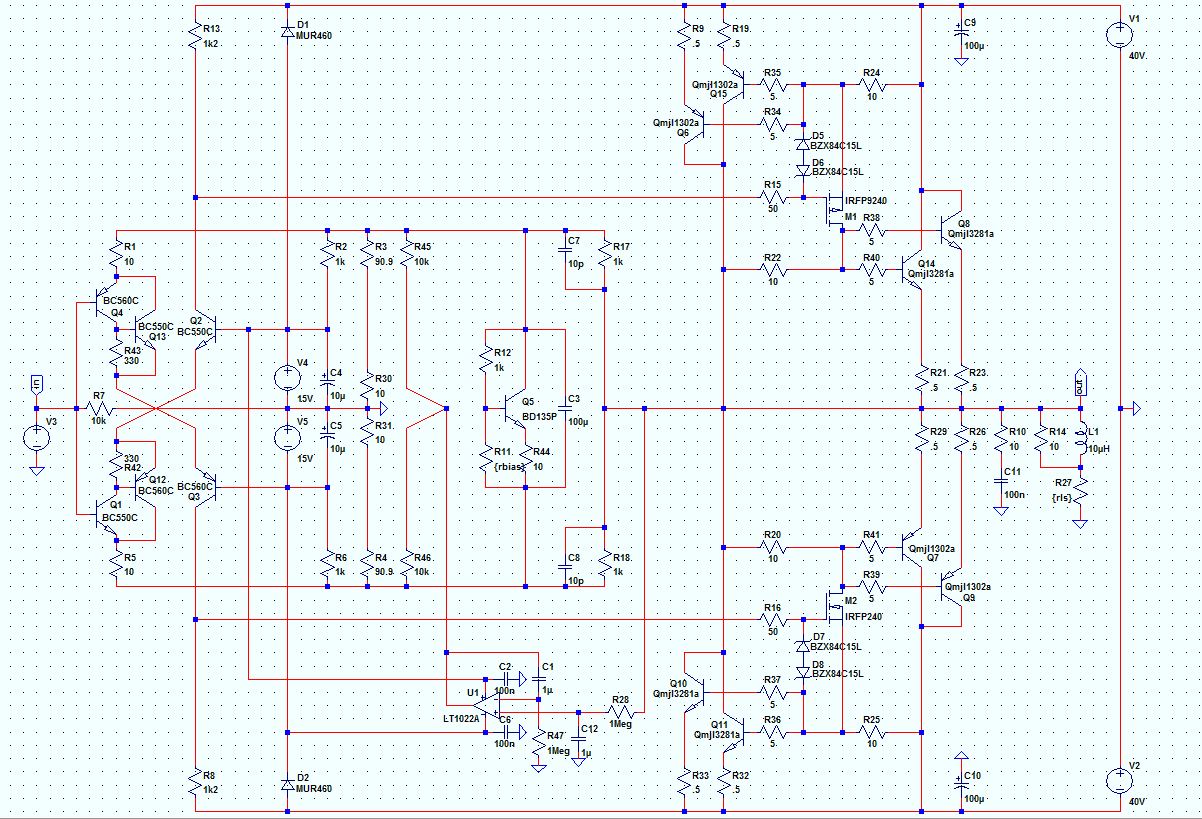

I would like we discuss about the issue with your low values resistances for feedback i encounter in my sims, described in my thread. Can be a global issue ?
What am I missing?
This is the version that I plan to build, but the fact that the bias current highly depends on the load impedance makes me doubt. Why is this (the varying bias), and can I improve/correct this?
The versions I build will or will not have the CFP’s, I will try them both.
The IRF’s are at a slightly elevated bias, this is to isolate them from the varying IB’s of the power transistors (the simulator tells me that it improves (marginally) by upping the IRF’s bias).
As you can see I am planning to build a power supply that delivers 4 voltages (+/- 40V and +/-15V).
Frans.
Frans.

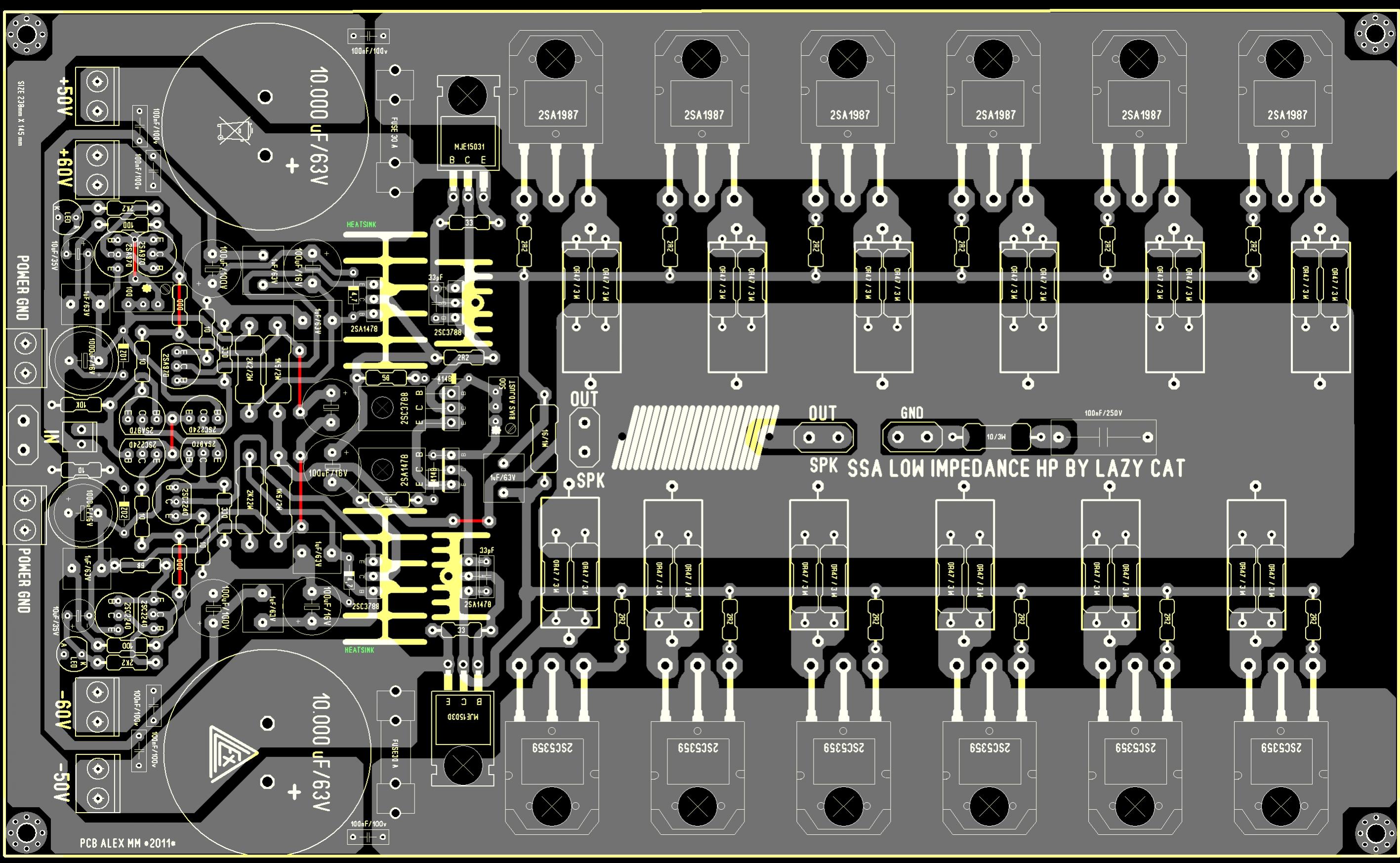

Very very beautifull....... new PCB for SSA LOW IMPEDANCE HP .....
Alex.
Just my two cents: Why don't use 10X1000µF instead of those huge 10 000 ? It feat better on board (size and height). it is easier to find. It gives better values (average), it is less expensive, and most of all, each one will have lower ESR & ESL, that will be divided by... 10 !
The only annoyance is, all the 15/20years, you'll have to change 20 caps instead of 2 ;-)
ALEX . . . PURE BEAUTY of an ART
Alex, You become a master of this art, this one is as beauty as it can be, & the only cousin missing here is the balanced one and the family will be complete . . . . . .
Alex.
