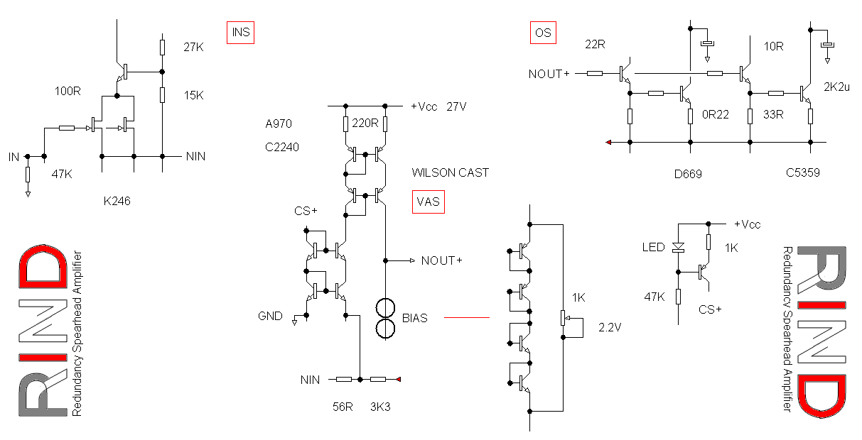

Ok sonnya i did what you said, i install two 47p and it's stable now
I can set the offset with no problem but there is no way i can set the output bias even if i left those 1k/100R or replace with 2k2/220R

You might try these to make it stable:
1. Install two 47pF in parallel with the 1K feedback resistors, one for each.
Or,
2. Replace 1K/100R feedback network with 2K2/220R.
I can't assure but one of these tricks might help. It will be sad to see you giving up after this much progress.

Hey guys
I will soon be building V1.4 of the original SSA. Schematic is attached.
I will be using KSC1845/KSA992 for Q1-Q6 due to the ability to make matched pairs. I have had no success matching medium power VAS transistors so far.
I would like to run the VAS at 5ma. 10mA will probably cook the VAS transistors.
Is the VAS current set by VR1? If I set the VAS at 5mA what do I change to get the outputs to bias at 130 mA?
http://www.diyaudio.com/forums/attac...er-design1.pdf
