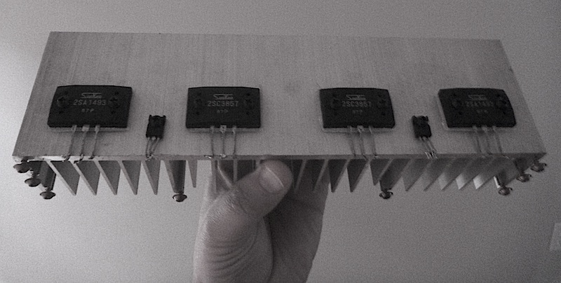

I scored a dead Onkyo amplifier, an old one. Lots of it seemed broken, including the power trafo so I decided to scrap it. But the heatsink looks handy. I'm wondering if it would serve for a 3-channel SSA. The amplifier was rated at 80W per channel = 160W total, which would mean 50W per channel for 3 SSA channels. Mind you, it would be a shame not to use the nice Sanken's already bolted in place.
