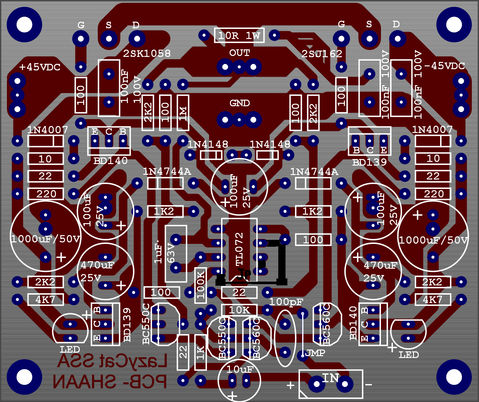

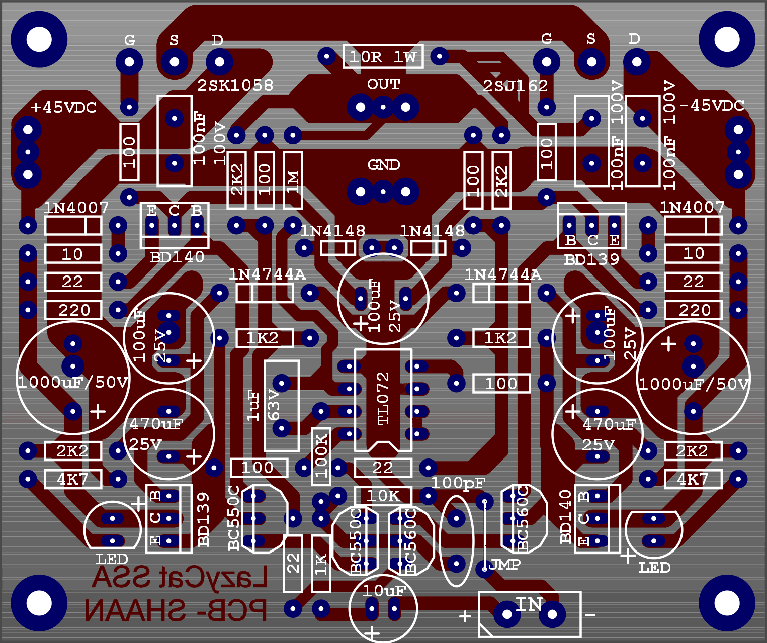

Hi cambe. Very nice.
Hi naf. I'm out of home now and will be for the next two weeks, so no ssa for me now 🙁. The servo peeceebee artwork is almost ready, but have to do a final checking. I have also prepared a solder mask for clean soldering, a better silkscreen and minor changes from the shown example. Will be uploaded in first week of november. Thanks for your patience.
Btw, pin 3 of opamp goes to ground. Pin 2 and pin 1 are conected to each other only.

thank you Sir Esperado,
in my first draw i like to connect pin 3 to ground.
and then i read maxim app-notes in their note is not good to connect pin 3 to ground... here they say
"These two circuits are the most common mistake made when terminating an uncommitted op amp. They are equally bad because the op amp's output will be railed low, causing the op amp to consume more supply current."
and here the link Avoiding Noise and Power Problems with Unused Op Amps - Application Note - Maxim
Hi, naf.
"If the circuit has dual supplies, ±3V for example, the two resistors are not necessary and simply grounding the non-inverting terminal is sufficient."
The non inverting pin will be at 0V, and because Gain factor= 1 the out, then the inverting pin will be at the same potential. No problem.
And some opamp does not like their input to be at the rail potential, as the can invert their output in that situation.
