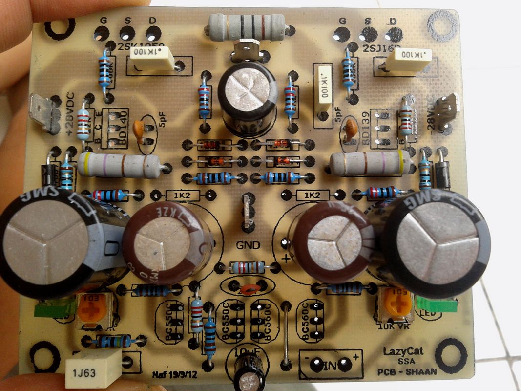

Thank you Shaan,Yes 1K+220 is perfectly OKAY(I am doing this too). In fact, you may need to modify these values after checking the initial bias, which may not be optimum at first.
Board looking good with parts.![]()
Ok, i'll go with series resistor.
Anoter question do i need little heatsink on BD139/140?
Do i need little heatsink on BD139/140?
Yes. 1"x1" heatsink will do. I used "U" shaped small heatsinks which aren't too good, a little more hotter than I like. But I did this so that the VAS bias would stabilize quickly.
Hi naf. The zeners seem to me to be 1/2 watt rated. You should use a 1watt one.
With 470ohm feed resistor, the dissipation is over 400mW; although less than 500mW, having a larger dissipation margin is good for long term reliability as 1W zeners have thicker wires that can help transfer much of the heat to the copper quickly.

Shaan. thanks for your information, i'll paralell the zener and add little heatsink to VAS tr.
I'll paralell the zener.
NO NO NO! DON'T!
Read this to know why you should not:- Can you parallel zener diodes?

i think by paralelling the zener it will increase watt rated, just like paralelling elco to increased capacitance.
edit:
Shaan gave me link about paralelling the zener, now i know why.
thank you Shaan, now it's clear to me.

If you cannot parallel Zeners, never, no way, you can use two in serial, making sure their total breakdown voltage is the same that the original single one.Shaan, here my progress on building..
sorry don't have chance to source 1W zener :-(
Or increase the value of the feeding resistance to lower the current.
dear Esperado, thank you very much for your explanationIf you cannot parallel Zeners, never, no way, you can use two in serial, making sure their total breakdown voltage is the same that the original single one.
ie: for 15v, i could use 7v and 8v in serial, right?

Hi naf
You don't need 1 W zener since there's cca. 10 mA zener current, multiply 15 V, so you end at 150 mW power dissipation on one zener diode. 500 mW zeners are OK.
If you dont have 1,2 k resistor than parallel (one resistor on top other on bottom side) two 2,4 k or 5,6k parallel to 1,5 k etc. It will be easier later to adjust correct value in this way, idea is to parellel them rather than serial connection. 😉

Hi naf
With 1K2 resistor the current at 15v will be over 12mA into the feedback bridge. In my experience the zener current should be higher than this for effctive regulation, requiring 470ohm or so for the zener feed resistor and essentially a 1w zener(from my last year's messed up SSA attempt).
IMHO, the 1/2 watt zener can not regulate the voltage for the total required current, which can be as high as 15mA if the VAS devices have lower gain than usual.
There's 10 V voltage drop on 470 ohm resistor, meaning 21,3 mA current flow, minus 12 mA of current through 1,2 k resistor, what remains is 9,3 mA zener bias current. Zener current regulation required is 9,3 mA +/- 5 mA at max.
To my opinion 500 mW zener can do that without problem, at least what datasheet says. 🙂
